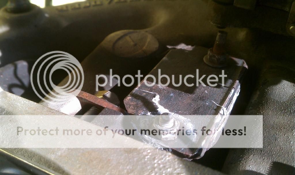

Told me that my exhaust manifold had a leak so the heat was escaping and heating up the intake and perhaps causing the fuel to get "too" hot, here's a pict of the "before",
He replaced the bolts and made a good seal.
BS, BS, BS. His facts stopped at "has a leak". Everything after that is malarkey.

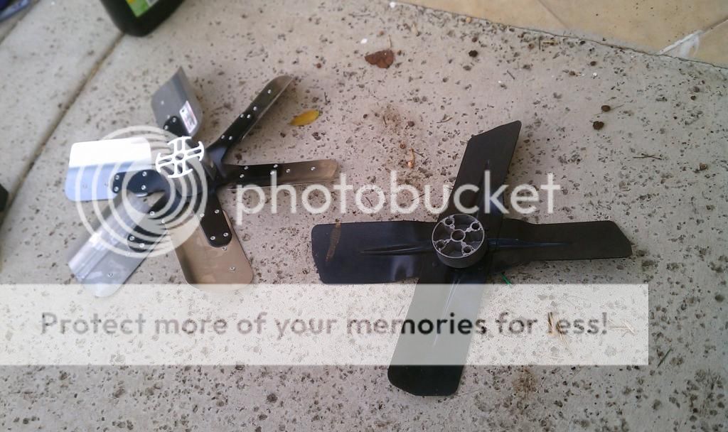

Here's a comparison, any thing is better than the old 4 blades right?

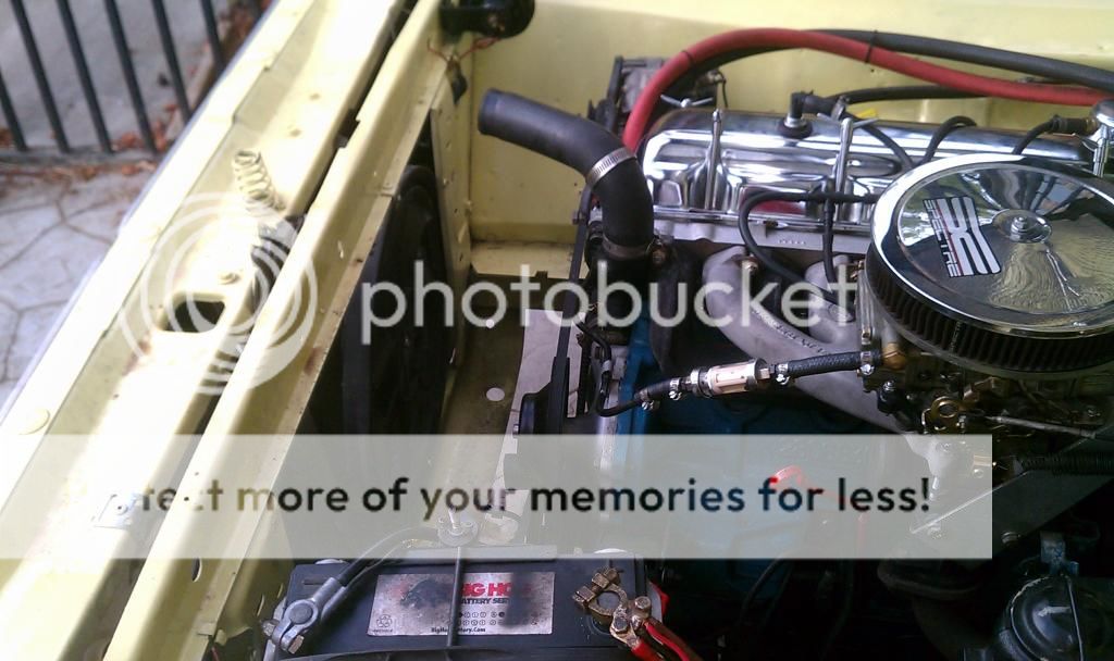

Making the shroud fit, it's pretty hard to find an original I'll admit.
If you look closely, you'll see there's also an electric fan in the front.

Not surprised if is runs rough; that carb is kinda big and would need to be tuned well. I've used a 500 cfm 2 bbl on a smaller engine but smooth idling was not the point....! What has been done for carb tuning? Do you have a vacuum guage? I would connnect one on and see what you have for idle vacuum level. There are a number of things that can cause your rough idle that have nothing to do with internal engine problems; a vacuum leak would do it, as well as the carb being off, erratic distributor....all of these are fixable/improvable from the outside. With the compressions being even, I would at this time rule out the cylinders. Head must be basically OK too to have these consistent compresssions across all cylinders.
Did you ever figure out or get an explanation of why the timing could not be set? Where did the most recent mechanic set it to, and did he report any related timing issues? What would you think of buying a timign ligth ad checking timing for your self? I suspect you can develop the skills for this...
Keep an eye on the flexfan; the onse I have tried in the past all failed with cracks in the blades.
