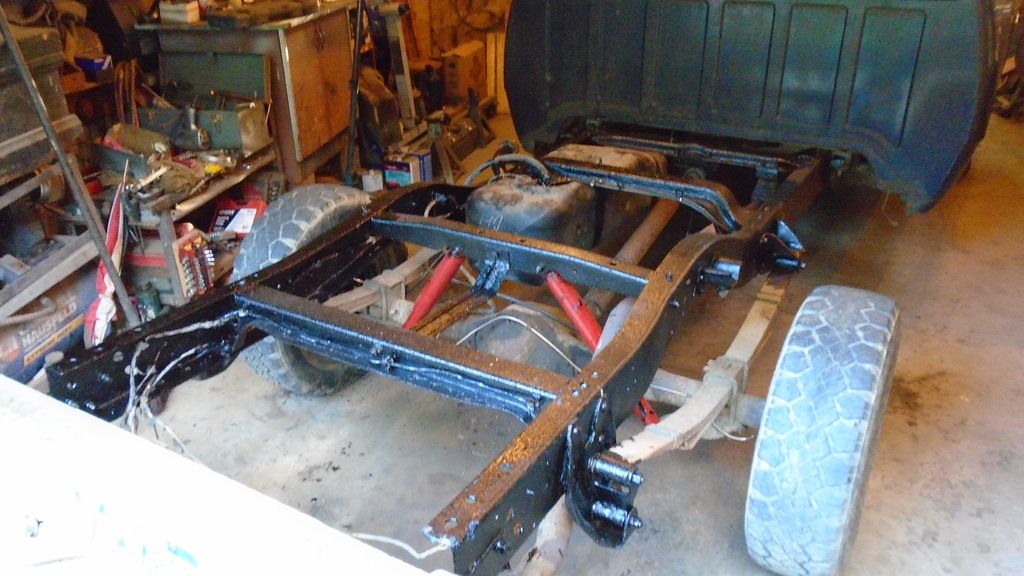

Got the rear frame undercoated and new lines run. Just in time too, the main gas line broke when I bumped it. Now I just need to finish the front brakes and get it tuned, then I can start driving it and finish cleaning it up and undercoating it at my house. Hoping to at least get the brakes done tomorrow.
I tried my other 1945 on the D100. She's still not running right. The dash cracked again and I still don't have either brake light or my driver's side rear turn signal. I'm going to back-burner it though, at least until the D150 is a driver.

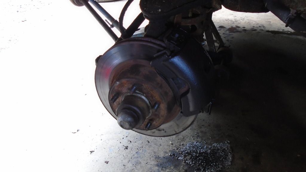

Took a day off orders to do some brake work on the D150. New calipers on and painted, cleaned and painted the rear drums, freed and anti-seized the auto-adjusters in the rear brakes. New line up front. Checked the pads and shoes. Need some new pads and front shocks.
My other photos didn't turn out very well, and that one isn't even that great. Hope to get more Friday. I ordered some jets for the 1945. Plugs show it to be really lean, and being a box-store "remanufactured" carb leads me to believe it's never been actually set up for this truck. She's awfully close to getting inspected though. Just wish I didn't have to drive 25 miles to do any work on it.

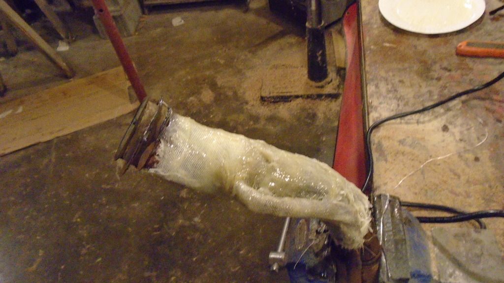

I fixed the filler neck on the D150. It had rotted out pretty extensively, so it got fiberglass and Smooth on (the chemical-resistant epoxy I use for bow building).
Here it is after the "bandage" went on, right before popping it in the hot box to cure.

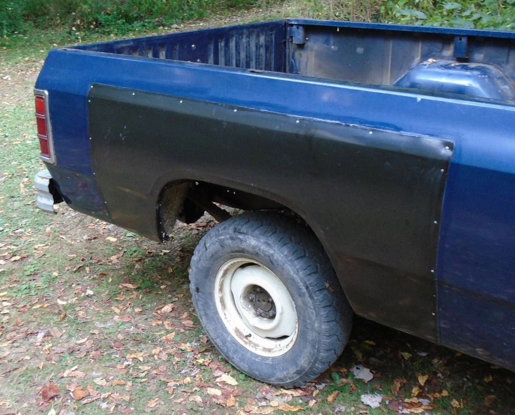

The D150 however, it got some new panels and went in for inspection.

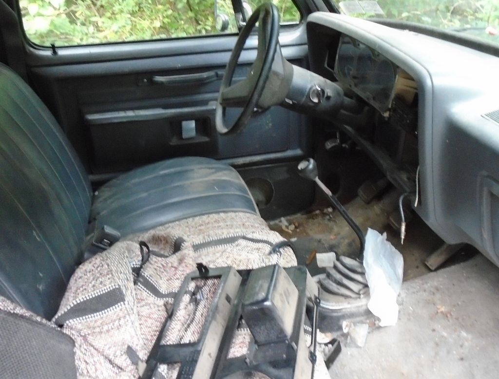

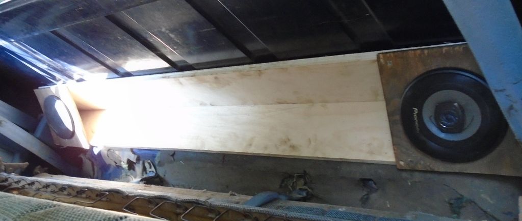

While I had the seat out I chased some of the wires running to the stereo and found the speaker wires were still intact. I made a holder for the speakers that were in there that would actually allow the seat to go all the way back. Also makes a nice shelf for extra fluids.

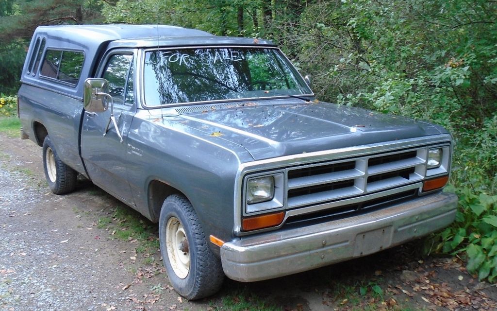

Here's the new parts truck. It's an '86 D150. I'm planning on stealing the engine and transmission for my D100, and tradiing the rest of the truck to my brother for the 9.25" rear end out of his old '85 W150 that was wrecked. He's going to put the motor out of the W150 with a 727 and rebuild his "Beast", which was his first truck. This is a good base for that build.
The reason I'm not that interested in salvaging this truck myself is the way it's been treated. Old man owned it just to pull his model A Ford around. He died, the kids beat the snot out of it using it as a work truck- obviously hated it being a Dodge, because the ripped off every emblem and badge on it- blew the clutch and then just sold it to a salvage yard. The dash is broken apart, the stereo was torn out, and the whole thing has been used a trash can/ash tray. Passenger door handle was broken off on the inside, and when they broke the ash tray off they just decided the floor was good enough.
You can't see in the photo, but the passneger's side is literally covered in old cigar wrappers, empty bottles, and a bunch of other garbage.

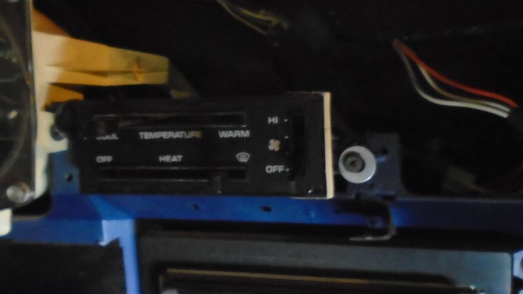

Here's the heater control fix. The white is aluminum, epoxied around the edge, and you can see a washer where the plastic was broken. It now sits in the dash as it's supposed to!

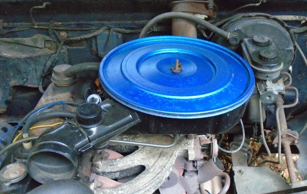

My D150 that I have named "Grandpa" (because it's old, classy, and built to last- but not too fast) started running rich. With the air pump gone it pointed to a clogged cat. Cat is gone and a temporary pipe is in, but it will get a new full exhaust when I get a chance.

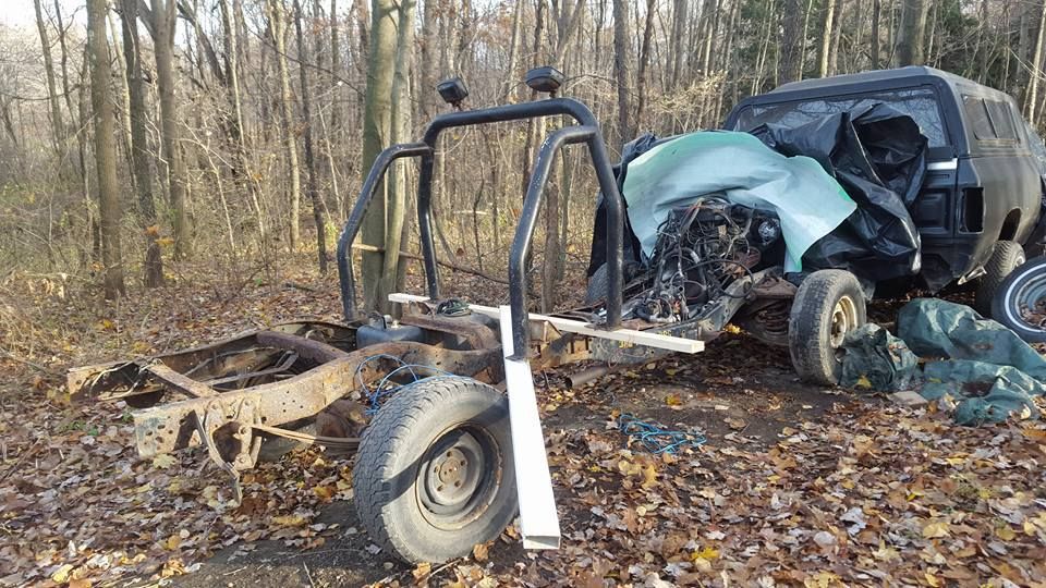

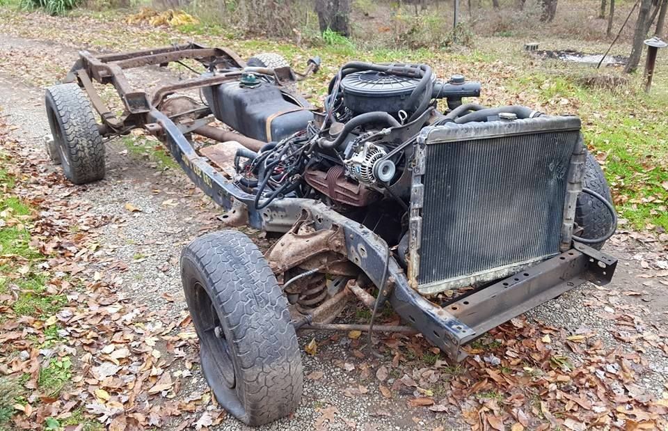

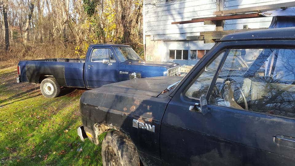

I did wind up buying a roller for a new rear end. It's a short bed '88 D-series with a 318 TBI and 904 auto. It has the same 8 3/8" rear, so I wouldn't have to buy a new LSD. Just hoping the axle splines are in good enough shape on the Groundhog so I can keep the bolt patter the same. I have a set of aluminum wheels off my old '87 Dakota that I'd like to use.
With some much of this thing left though- the power train is all there, the suspension is all there, even all the wiring for the TBI and ignition, we're going to take the cab (sans doors) off of my brother's wrecked '85 W150, the 9 1/4" rear, and a set of big 33" all terrains that came with his W100 to make a dune buggy/woods truck for firewood and what not. He really wants to mount the old roll bar that came with our father's W150 years ago.
These old trucks are going to get me into trouble :lol:

Well, took the afternoon yesterday to try and sort out the accelerator pump on the remanufactured 1945 on Grandpa. The spring and pump itself seem to be working fine, and the passage for the gas from the small chamber are open. The issue remains though. The truck runs alright but this is still annoying me.
Have to do some more research.

I did some more undercoating on Grandpa and re-gapped the plugs to 0.045". Glad I did! Smoothed out how it ran cold when first starting somewhat, and I checked my mileage. It had been down, but Grandpa knocked down 18 mpg on a short jaunt to see how it was running! I'm ecstatic! It was mostly highway cruising about 55 mph, so I'm hoping that around town I'm still able to get around 14+ mpg.
