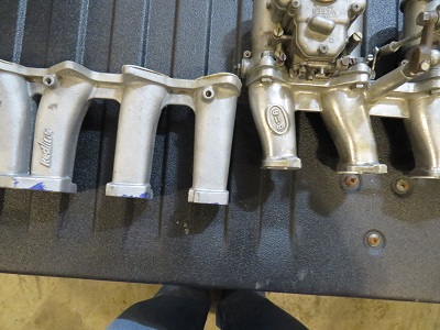

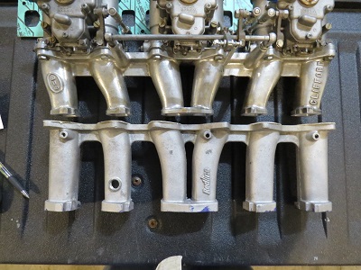

Here is some info on the Redline and Clifford. I went out to the garage and did some measuring on the two manifolds since they are both in my garage and off the engines now. The Redline is my new one untouched other than I ran some drum rolls over the ports to clean up some slag. The Clifford is the one off Ryan's race car (Seymours) that was port matched to the new cylinder head that Ryan had built. I do not know any more than that.
This shows the difference in length from the face of the head to the carbs. The Redline is 6" long and the Clifford is 4 1/2"

Here you can see that the Redline comes out from the head a lot more straight than the Clifford. The Redline Manifold is also 20 1/4" overall length and the Clifford is 22". This extra 1 3/4" is the reason for the dog legs in the Clifford. I don't suspect they hurt anything by seeing how well Seymour's car ran!! :D :D

I find it just a bit odd that Clifford makes manifolds and headers and their own headers will not work with their own manifolds. :shock: And it is not just the Clifford Weber manifold. I have a like new set of the Clifford big tube race headers for my Valiant, and they will not even fit with the Clifford 4 barrel manifold.
Next I measured the port size. The Redline ports 1.208 wide X 1.29 High. The Clifford which I know have been worked over some are the same width 1.208 x 1.55 high. Cross sectional area is 1.872 sq in. for the Clifford compared to 1.558 sq.in. for the Redline. obviously they are running the same Carburetors so the restriction is at the cylinder head side and it is only in the height of the runners. The actual wall thickness is close .250 on the Redline so there is room to open the ports up to close to what the Clifford has.
My plan is to open up the height of my manifold to something close to the Clifford. Unless someone has a reason not to??
Also if the ports are opened up to be of comparable size do you see one of these manifolds as being a better performer? Will the longer Redline manifold and straighter runners perform better than the Cliffords shorter but slightly more crooked runners.
