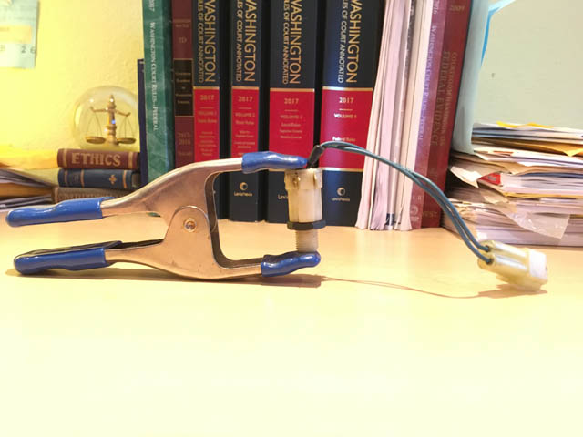

Will do. I had to reglue the original factory switch because it wasn't working right. I am glad I took it back apart because I was able to re-align and clean the contacts for the brake lights and cruise control in the switch. Now I have to wait a few more hours for the Gorilla Glue to dry and try it again.
Hey! The picture uploading works!
