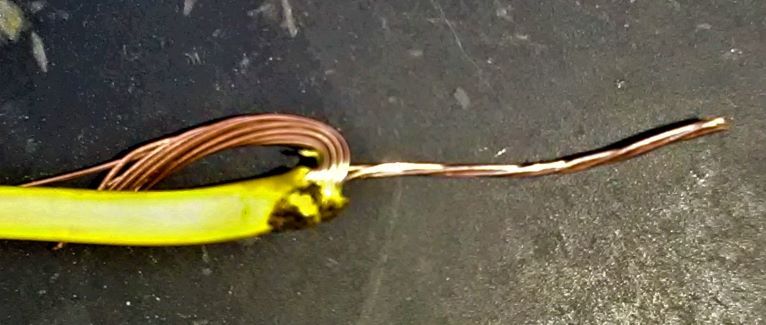

PostPosted: Mon Dec 07, 2020 6:52 pm

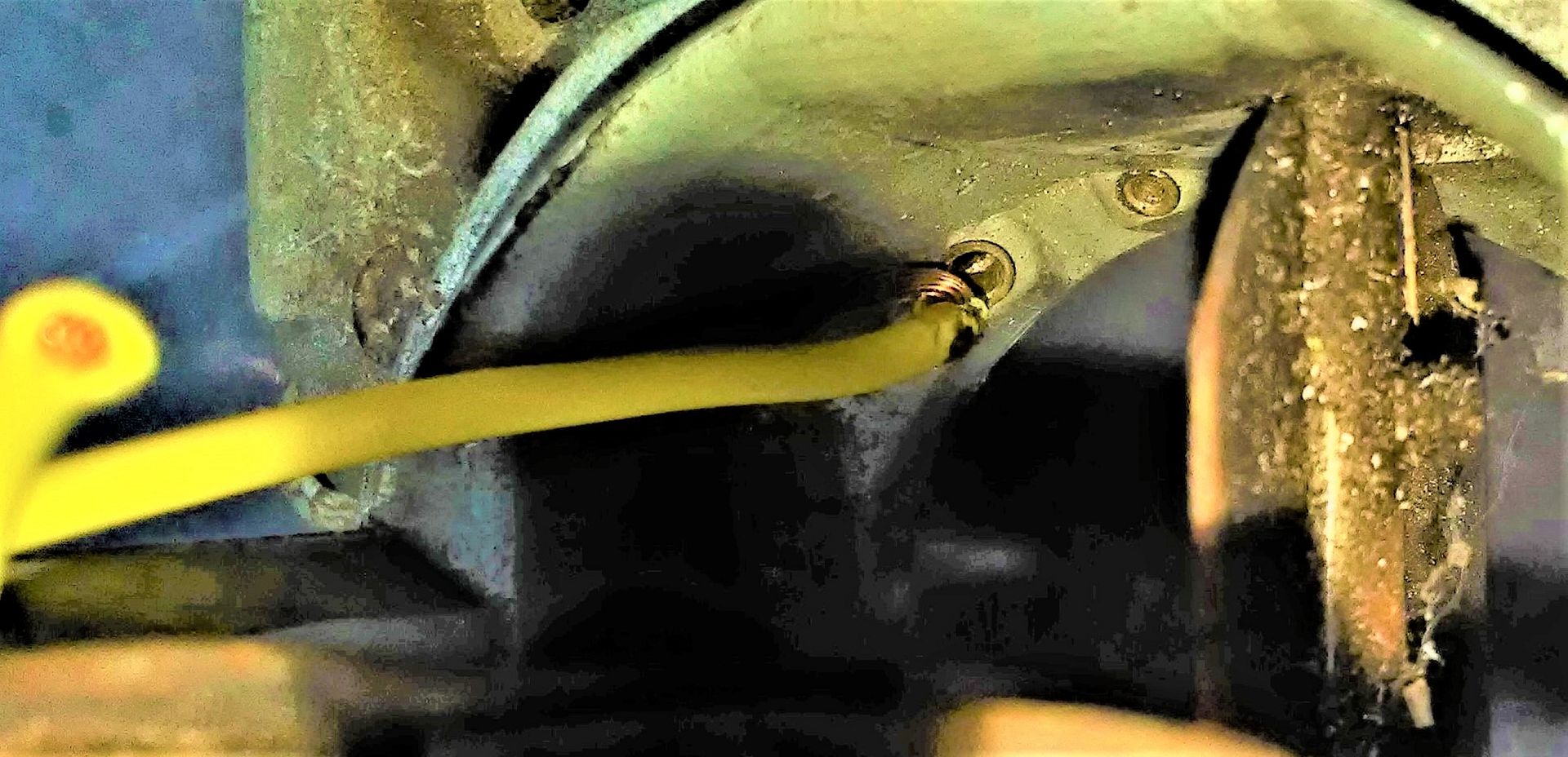

Posts: 1603
PostPosted: Mon Dec 07, 2020 6:59 pm
Joined: Sun Aug 30, 2020 5:53 pm
Posts: 14
Car Model: 85 D150
What am I looking at here? Pardon my ignorance
PostPosted: Mon Dec 07, 2020 7:01 pm
Posts: 1603
Just for Diagnostic and testing purposes, a few strands of wire down the idle air bleed opening, will make the off idle circuit richer. wrap excess wire around the air cleaner support bracket. If the surge goes away that would suggest a problem in the idle circuit. No change that would suggest it's in the main circuit. Reset curb idle mixture after you do this
Looking at the cutaway image from the manual you posted earlier, do I stick the wire through the idle tube, or down the well towards the transfer slot?
