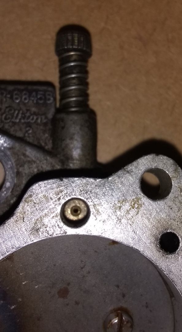

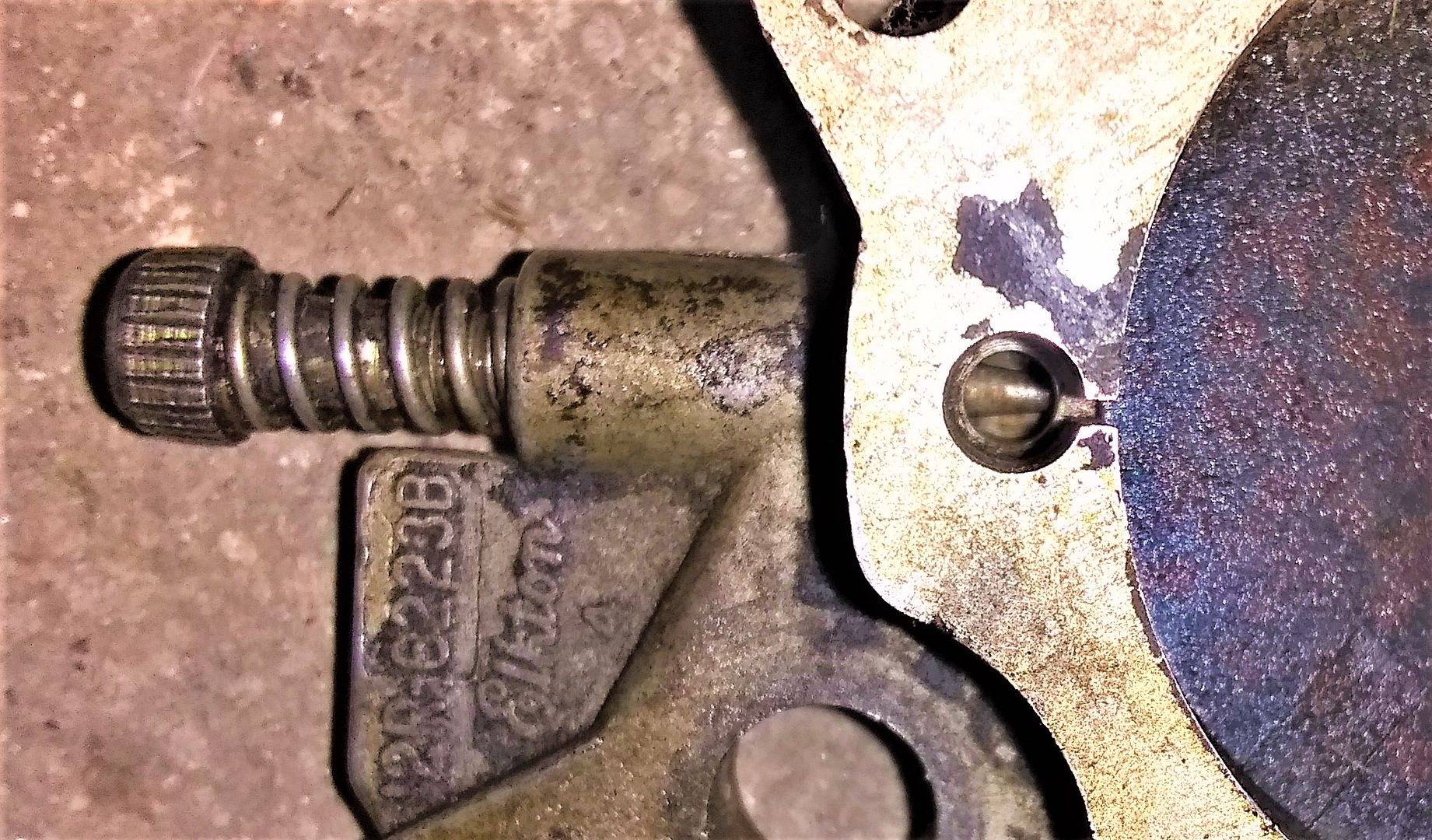

Idle restrictor started in 1977 it may be dirty or too small for today's fuel I would suggest cleaning it really good enlarging it or remove it altogether. At 5 turns out it's the Restriction that setting in your fuel mixture, not the mixture screw.
Interesting! Removing it sounds like a winner, any suggestions on how I might facilitate removal without tearing something up?
Author:  notyettoday [ Mon Dec 07, 2020 4:11 pm ]
Post subject:  Re: 85 D150, Bought+Rebuilt R7989 Holley 1945, drivability issues
Holy great pictures! Thank you so much. I had noticed that restrictor, I see that it's south of the idle transfer slot. Would that restriction potentially cause my drivability problems? Comparing my oe carb to the 7989, the oe is missing that restriction, though the idle mixture screw on oe is capped. Wonder if it was removed, or if the factory omitted it since there is no option for idle mixture adjustment.

Back to the matter at hand, I drilled out the restriction, re-installed the carb, and can now set the idle mixture where its so rich at idle it'll make your eyes water. That being said, I set the timing to 12.5° as that seems to be best performance without detonation, and my lean surge is still there, though not as pronounced. I set the curb idle to 750, and interestingly after driving 2 miles down the freeway I came to a stop off the exit, and found my idle at 500rpms. Evidentially, something is getting warm and sealing, and if I had to take a guess I'd say it's probably the throttle shaft.

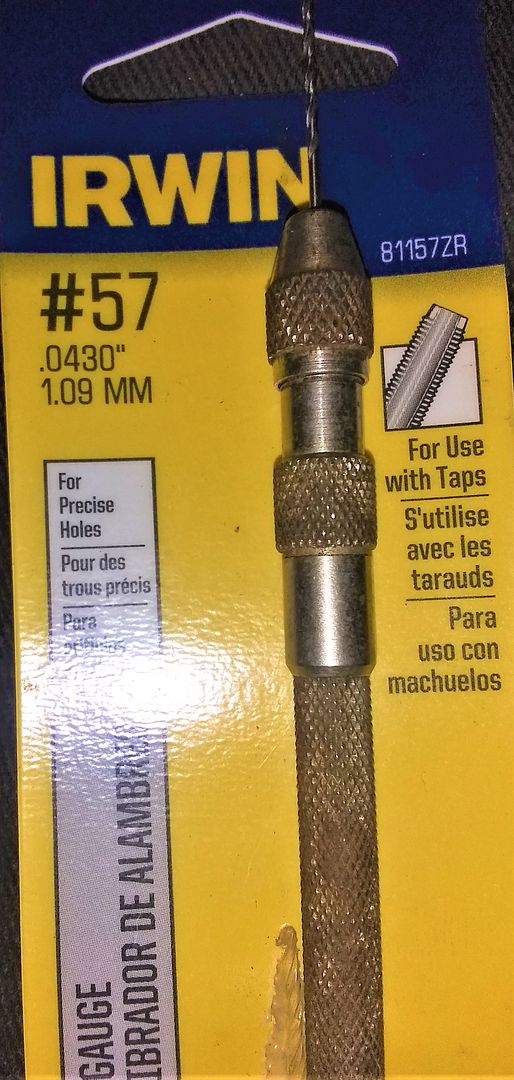

The Restriction is about .040 so slowly work your way upImage

What am I looking at here? Pardon my ignorance
Author:  matv91 [ Mon Dec 07, 2020 7:01 pm ]
Just for Diagnostic and testing purposes, a few strands of wire down the idle air bleed opening, will make the off idle circuit richer. wrap excess wire around the air cleaner support bracket. If the surge goes away that would suggest a problem in the idle circuit. No change that would suggest it's in the main circuit. Reset curb idle mixture after you do this
Author:  notyettoday [ Mon Dec 07, 2020 7:05 pm ]
Looking at the cutaway image from the manual you posted earlier, do I stick the wire through the idle tube, or down the well towards the transfer slot?
