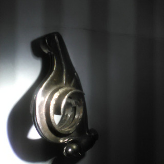

The answer You're looking for is NO, You cannot run a wire all the way through until it "pops thru", it will hit the backside of the shaft bushing. The oil goes up through the hole in said bushing and then flows in the gap between the outside of the bushing, and the rolled shoulders where the arm is formed to accept the bushing. The groove is there to allow oil to flow up towards the loaded area of the bushing at lift. The 2 passages do not lead to&thru that groove.
added pic of unit w part of bushing ground away, in the process of trying a mod, You can see cavity that runs the circumference.

The answer You're looking for is NO, You cannot run a wire all the way through until it "pops thru", it will hit the backside of the shaft bushing. The oil goes up through the hole in said bushing and then flows in the gap between the outside of the bushing, and the rolled shoulders where the arm is formed to accept the bushing. The groove is there to allow oil to flow up towards the loaded area of the bushing at lift. The 2 passages do not lead to&thru that groove.9503625517768413.jpeg
Thank you. Very informative. Like the cutaway.
