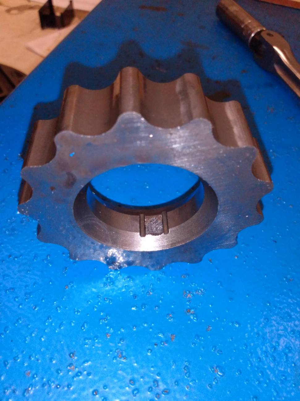

Got the pump out, and got my answer to how bad it is. Looks like it's confined to the pump gear.
Author:  Greg Ondayko [ Wed Sep 08, 2021 11:57 am ]
Post subject:  Re: So, I made a mistake with the torque converter - how bad is this?
Remember that "snap" you heard..!?
That was it .. Good thing you pulled it apart.
New drive gear and you are in business!
Author:  MadScientistMatt [ Wed Sep 08, 2021 12:24 pm ]
Yep, I'm relieved it wasn't anything more.
I might throw a Trans-Go kit in there while I'm working on the transmission.
Author:  slantzilla [ Wed Sep 08, 2021 9:01 pm ]
Check the neck on the converter really close. Mine had a really hard to see hairline crack coming out of one of the cutouts.
