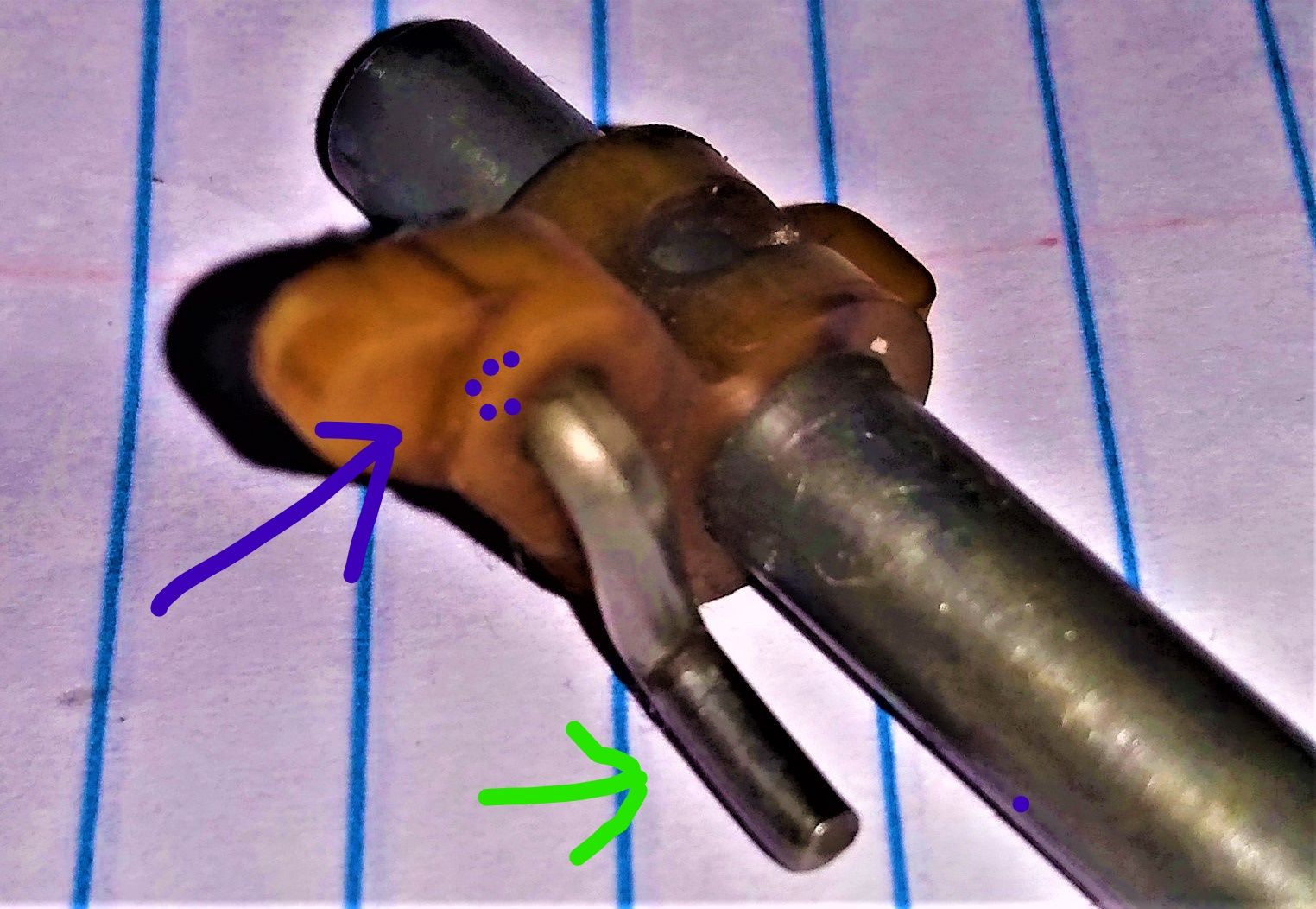

Blue line plastic pump arm can wear or have hair line cracks. Green line wear pattern on steel s pin wear pattern. The s pin mloves in and out of pump shaft with up and down. movement. Check for burrs or smooth with file |

Is there any place to get these plastic parts? |

https://www.ebay.com/itm/120345764441?h ... R5LYyYCZYg not the right one ,there were long and short yours is different. Thats carter number 111-120, you need carter 111-165 pump arm |

https://www.carburetion.com/Products/Pr ... t=BBD-HV32 This looks right |

Thanks so much! That site also has the other piece as well. Can you tell me if it’s the correct one as well? https://www.carburetion.com/Products/Pr ... art=85-182 |

That looks good to me , walker number here better picture https://www.ebay.com/itm/120345763180?e ... R-jQuq2bYg carter number 111-118 for v8 but will work in slant models just a little more mid throttle lift of metering rod,good with todays fuel. |

slantsix bbd most of time got this one,not as much metering rod lift at mid throttle, after market only services v8 model https://www.ebay.com/itm/403598194643?e ... R6TgoLSbYg |

factory slant six green one https://www.ebay.com/itm/334859698709?_ ... %3A2047675 |

After market also came in black v8 type 111-118.https://www.ebay.com/p/2098143223 |
