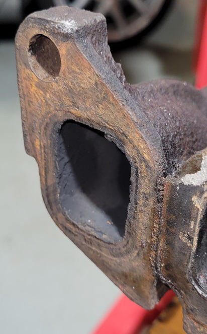

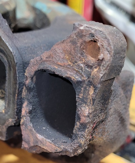

I think I know the answer to this question but I'm going to ask you more experienced folks just to make sure. I think the exhaust manifold will have to be condemned. I went to clean it up and check for warpage and realized the gasket surface of the leading port is rusted away. If I grind that smooth it's probably never going to seal. I've also included a pic of the trailing port for comparison.

Posts: 17664
Looks like junk to me. Sorry to see that. Must have had a bad exh leak at the gasket for a while, or maybe coolant coming into that cylinder.
×2, yup, that manifold's Done. Follow links in my previous post in this thread for manifold selection, gaskets, etc.
