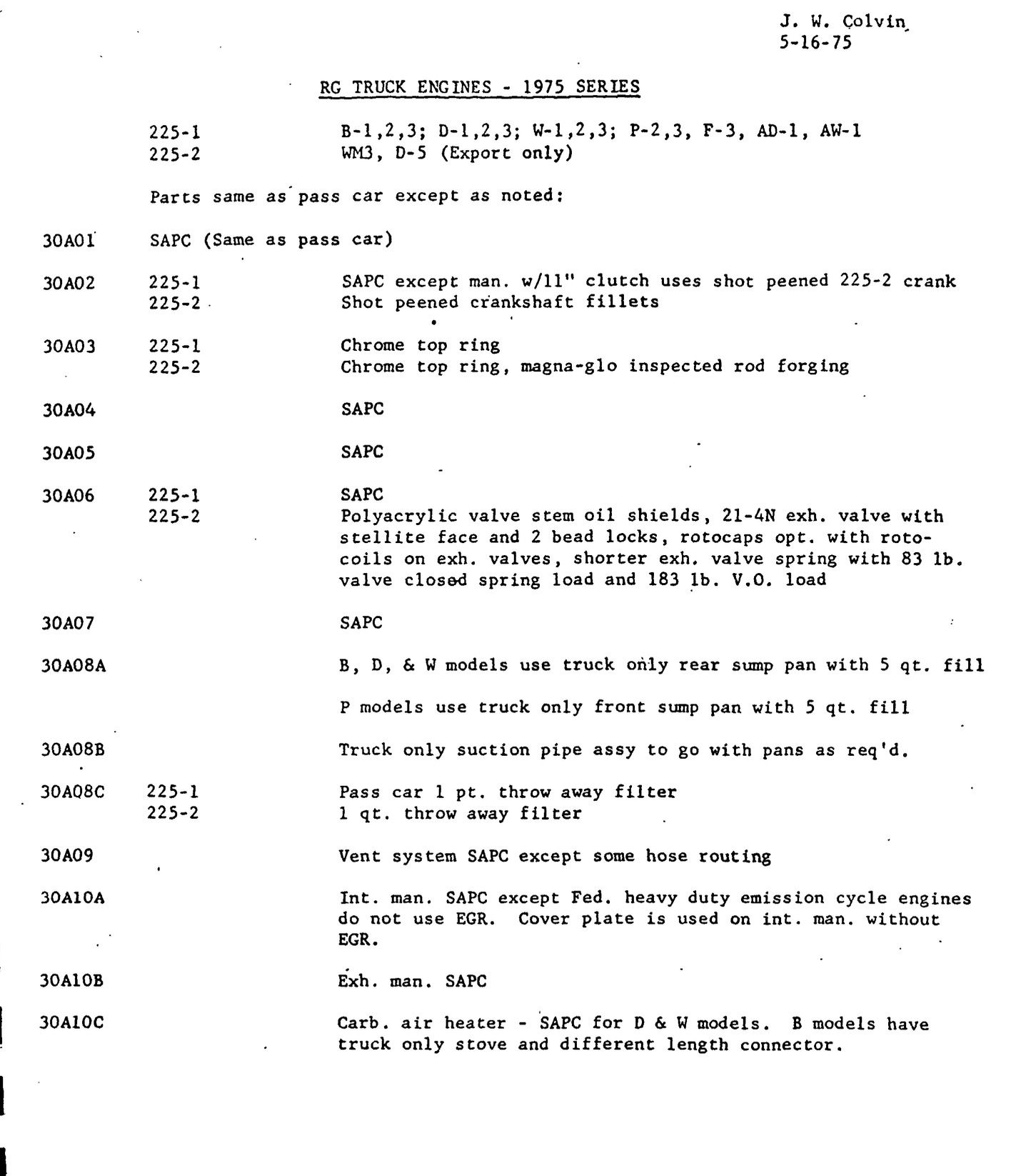

being a non automotive engine it would be interesting to know if it has a shot peened crank and exhaust valve seat inserts.
The 225-1 and 225-2 HD and XHD truck engines, put into much heavier-duty service than the industrial/agricultural applications, had shot-peened cranks and other upgrades. Valve seat inserts weren't on the list. Here're the '66, '70, '74, '75, and '78 225-1 and 225-2 upgrades:
