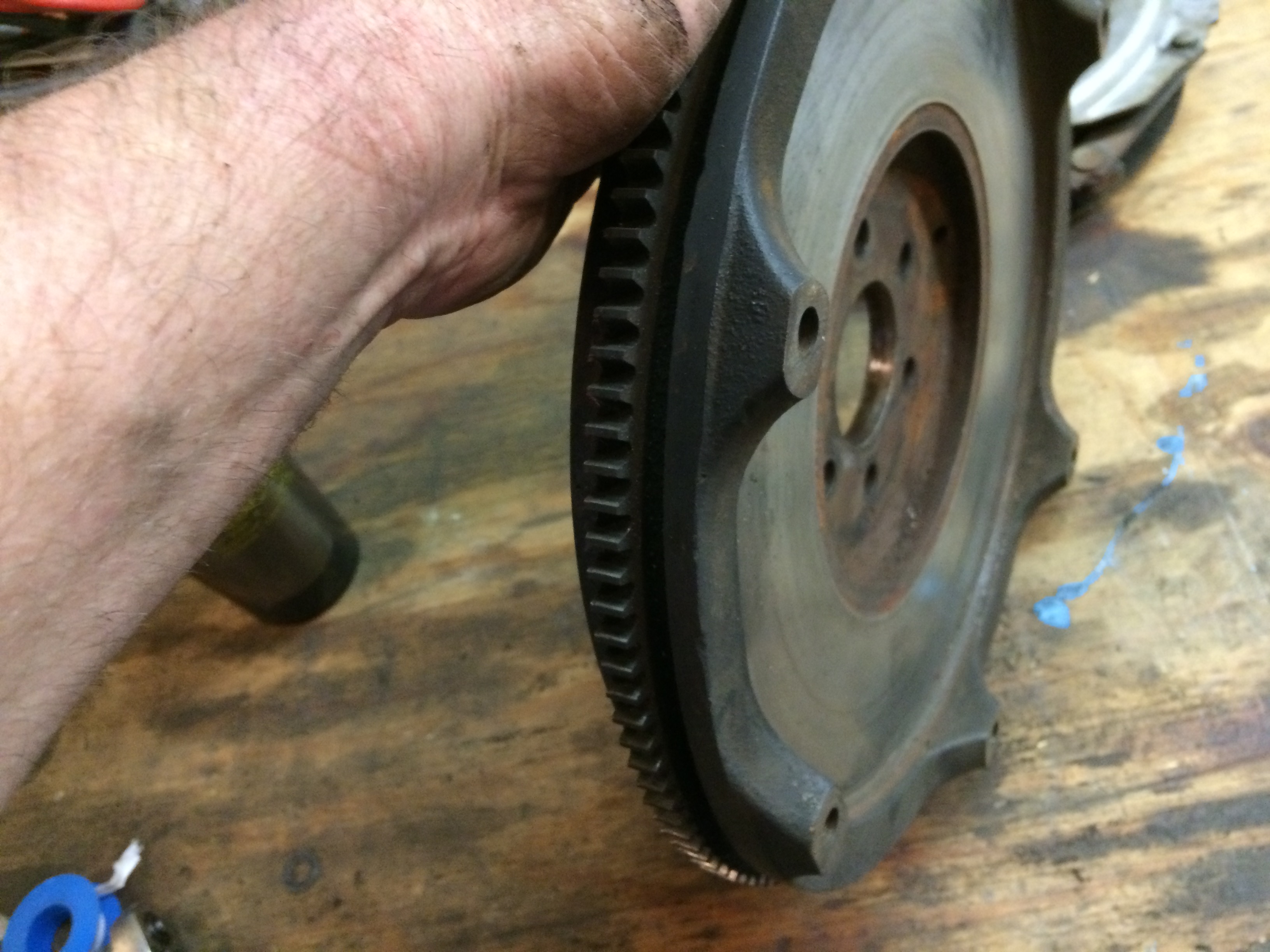

Did you read the link I posted? Yes you can install a flat small block flywheel with 130 tooth. Ours was a high starter as well. Here is the picture of the flywheel.

Cool. Thats the flywheel all right. So just get a 130 flat and clutch. Same bell housing? I’ll get the clutch and flywheel to have on hand. I did read back on your previous post. Thanks a lot!

I’m guessing to fit the 11” they had to recess disc into flywheel.

Yes same bell housing. You just have to drill the one hole in the v8 flywheel to fit the slant 6 crank pattern.
