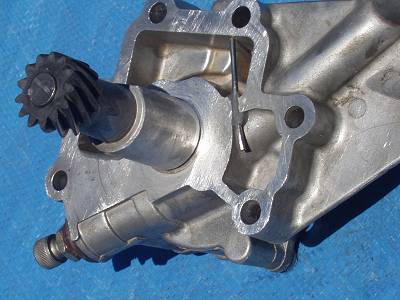

So...I made a 1 inch impeller HV die cast aluminum oil pump by adding a spacer to a factory unit.
Dutra does it again! ImageImageImage
How'd you make the spacer?

cutting a donor pump's body?

That's a nice way to do that. You get to use o-rings to seal both sides too, right? If you need a big pump you need it, I just like to avoid it whenever possible.
I am the same way, I use the standard size pump most of the time. The "loose" cam bearings are the main reason to use the thicker impeller pump and to take the time and extra work needed to make-up a special aluminum bodied HV oil pump.

Used a band saw to cut a "doner section" off a scrap pump, stuck that piece in a Bridgeport mill and took it within .003 on "lay-out" thickness and then flat sanded my way into the final size.
The spacer is sealed by o-rings on both sides but I actually epoxyed the spacer to the pump housing to insure proper alignment... forever. (the spacer to pump body o-ring is now incapsulated in epoxy)

I think the major advantage of doing this is not the weight saving, but being able to use the 6 bolt pump housing. This will close off the unused pump pocket and allow the pump gear oiling mod.
Yes, all the alm. die cast oil pumps have the 3 pockets and 6 bolt holes needed to install and feed the cam gear oiler tube.
Here is a view of the anti-drainback feed tube leading into the "unused" block pocket that now contains the oiler. The tall tube keeps the oil in the main gallery from draining-out thru this path after shutdown.
Notice anything else different about this pump?
Knurled knob on the oil pressure spring?

You are right... a knob to do oil pressure relief valve / oil pressure adjustment with-out having to remove the plug and spring.
It is a shame that it adds weight! :wink: :roll: :lol:

Doc, I'm not sure I understand how the small-diameter antidrainback tube works.
PostPosted: Wed Aug 22, 2007 11:40 am
Posts: 4880
The small oil feed tube works like a "pea trap" in your plumbing fixtures, the bottom of the tube is below the oil squarter's outlet level and stays covered with oil in the pocket so air does not go up into the main oil gallery. The top of the tube does not allow the oil to flow down into the oiler's mounting pocket and out the oiler tube unless it is under pressure.
