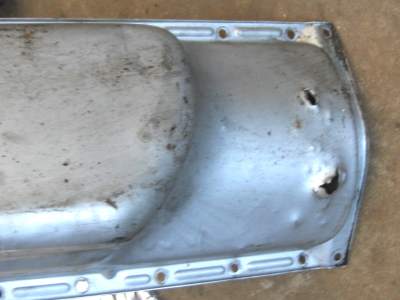

The oil pan came-off last night and I feel that the thinking above is what killed this engine.
#1 rod bearing had obviously over-heated to the point where the slender, 12 point rod cap nuts failed, then all h#!! broke loose inside the engine.

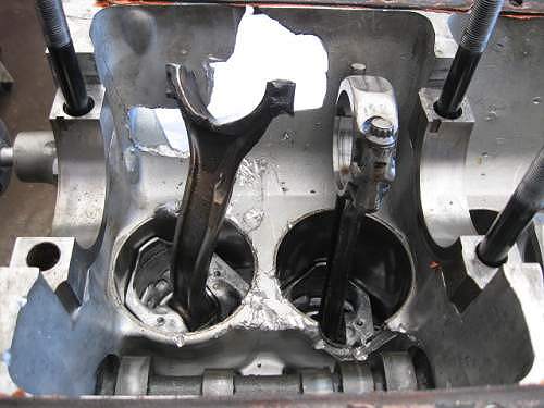

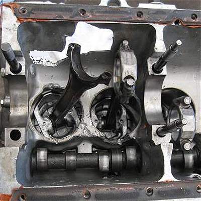

Anyway... I pulled the Buster engine and took the pan off... what a mess.
You know you have trouble when you see this:
And this...
Long story short, this block is now junk. :cry: :evil:

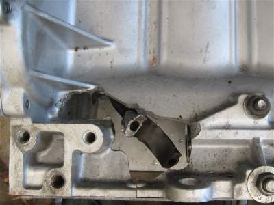

If it was just a "big hole in the side" I could weld that closed but somehow... a big chunk was also knocked-out of the bottom of cylinder #2. :shock:
If you look closely at this photo, you will see a long crack, running up the front side of the engine... the whole left front corner of this block is ready to fall-off.
