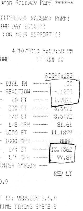

Today I made 7 Runs The First Was as Good as the best one from last week.
Almost every run the car got faster and Was posting a Higher 1/4 Mile trap speed.
Here is the time slip from run #7 (the last one)
I had 2 runs with sub 2 second 60' times - The other good 60' time is virtually identical.
I did add a 1" carb spacer between the carb and Manifold - That seemed to help pick up about 2 tenths.
the cam timing change seemed to help things too overall.
I need to work on my lights As I put up a few red bulbs.

Great work, Greg. I bet cam timing was the major difference. I agree that 12s are a real possibility...

Did you ever hit 100mph in the traps, or was that 99.89 the best. You should get the triple digit speed next time out!

Congratulations on those nice runs Greg. It looks like it is too lazy off the line. Lou's idea about the header extensions is a good one. If the torque converter stalls high enough you need more low end power to improve the 60' times. Sometimes reworking the accelerator pump to provide more gas right off the line helps. If you can get one you might try a Holley carb. It will all come together, the best thing you are doing is too get out to the strip and make as many runs and try as many things as possible. We all appreciate all the work you have gone to so that we can follow every step of the way. See you in Hagerstown.

The hightest trap speed so far has been 99.91 MPH, no 100's yet. It'll get there soon.
Yes It does seem to be lazy off the line. The only carb work I have done so far was to change the accel pump one shot richer - That took care of the little flat spot. I have not tried any other rod / jet combos yet. More TNT time is required for that.
