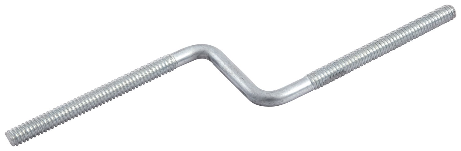

Two other concerns to note will occur when the assembly is in the car...which fork length will be appropriate for this assembly...
I had noted that the bigger 143 Tooth Bell needed to use a truck style clutch fork that was 1/2" longer than the stock slant fork
to keep the geometry and leverage correct for the stock linkage. (Also with that combo I had to slice about 3/4 to 1" off the end
of the Z-bar tube to allow it to fit with wider bell and keep the side clearances for the fork rod and pedal rod. The 1/2" longer fork
would be almost a No-Go for Pre-67 A-body). None of this will matter for the hydro TOB user, but I'm being frugal since I have a half
dozen sets of late A-body manual transmission linkage and parts...

Quicktime "shame on you" number 1 today came from the fact they didn't drill the bell for the clutch fork pivot for even their
own pivots... there is a weld in the way and the angle is all wrong if you use the bolt holes at do exist to install the stock
4 speed retainer... so I had to mock up the bell on the tranny, install their pivot with one bolt, install the fork and bearing...
maneuver the pivot and fork to squarly engage the bearing... then compare to the stock fork position on a normal bell, and
hope the angle and fork position coincide with the stock linkage (Fork Rod and Z-bar). I will deal with the Z-bar pivot mount
when it's all slide into the car and mocked up... this will not a be problem for the hydro bearing guy if using a direct hydro bearing,
not the piston to fork style.
