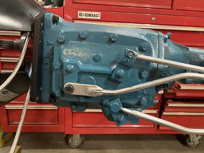

Like I said in the other thread, I had a great time at Mason Dixon Saturday at their T&T. 200+ cars and lots of nice people to talk to. Car ran 12.86, 12.76, 12.82 at @ 104mph.Made five 1/8 mile runs. They were 8.13, 8.05,8.07,8.08,8.08. My first run is always off by a tenth. The only real changes I made to the car was to add some more weight back in. Real glass and window operators. And I tried to go from @ 103 octane down to 100 to see if that made any difference. Not sure I can tell but it ran near its all time best all day, with a prevailing head/cross wind. On the very last 1/4 mile run I thought I would cut her loose and see if this thing would run 7.XX in the 1/8 mile. (It has gone 8.01) I set the shift light at 6700 and let her rip! :D :D ( No cardiac Stan!) The car sounded so good but the results were really no different. It actually was the slowest run of the day but only slightly. So for me the sweet spot for power/performance is in the 6300-6400 range.
Below you will see that I am making some progress on the next level of performance for me. All I need to do is order my clutch and pressure plate and get the linkage for the transmission. Pedals are already in and so is the hump.

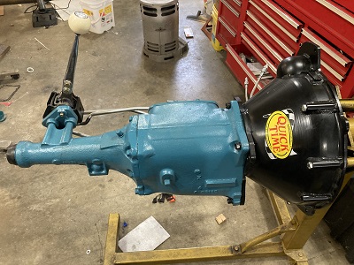

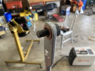

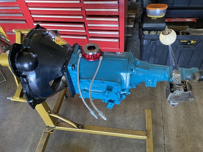

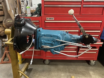

Got the new OD setup ready to go. I pulled the shifter and cleaned and lubricated it all. Probably had not been done in 25 years! :D While I had the side over off I noticed the 1/2 shift fork had some pretty substantial wear on the 3 pads where it runs in the slider. I ordered a new one from Passon and installed it. I will say the brand new fork was way less than impressive to me. The pads were certainly not "machined" to any uniform width and it really looked like a "raw" part. I will have a friend build up the old one and then grind it down to the proper size. I am sure I can do a better job by hand then they did on this new piece.
I also needed a new 3/4 shift rod, and so I just made one. I made mine to bolt on the front with a shoulder bolt and a thin copper washer. It has almost zero play but still moves freely. Cost me about $8 in materials. A good used one was @ $50. However if I consider my time mine cost $299! :D :D But I enjoy tinkering with that kind of stuff.
Still debating when to do this swap. I am leaning towards running it one more year with the auto since it runs so well. I want to pull the engine when I do the swap to repaint the inner fenders of the engine bay the proper color. Then while the engine is out it would be a great time to pull the pan and check the bearings...etc. Then I run into project creep...... So I think it best to wait till next winter. Maybe I will be "really" retired by then. :D :D
