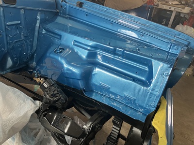

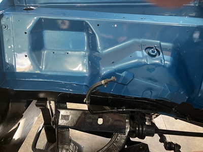

All of last weeks sanding , grinding and cleaning paid off. Inner fenders and firewall now matches the car perfectly. Glad that is done.
Now to get that engine and transmission back in without touching the paint. Did Houdini ever do any Mopar work? :D

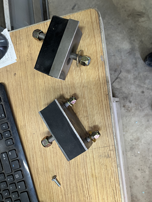

New Poly motor mounts with interlocking steel inside. No need for a engine brace with these. Steering coupler rebuild kit should be here tomorrow.

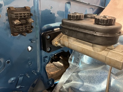

Offset master cylinder mount
Everything fits Ok

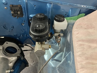

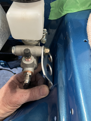

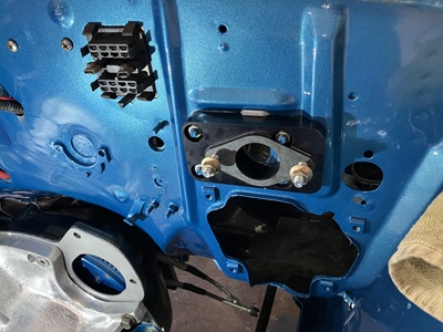

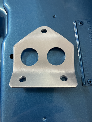

Here is the new bracket I made for the clutch master cylinder to fasten it to the inner fender well.

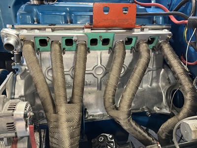

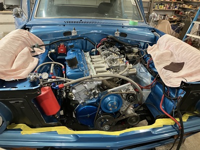

Headers were unwrapped, installed after new motor mounts, heated, bent, removed, painted and then re-wrapped and finally installed.
Engine gets a lot of stuff put around it! :D

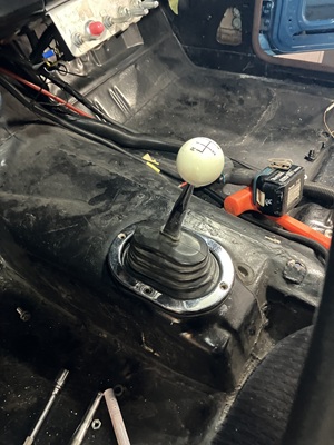

Cut the shifter hole a bit larger. Then welded stops on the shifter since it had none. Then installed into car with new boot. I will test drive before I do the final carpet and seat installs.

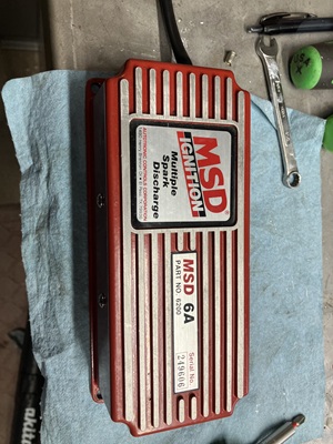

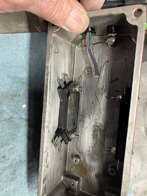

Also installed a new top secret dual ignition system. These are prototype MSD system that are not on the market yet. But they do provide a neat sneaky ignition setup. Also gives a use for all those MSD 6 series ignition modules that have been crapping out! :D :D Two new GM HEI modules tuck in neatly and the whole housing is a thick aluminum heat sink. :D

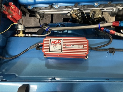

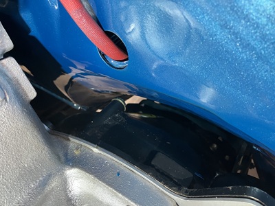

I completed all the wiring under the stealth MSD. I used all the existing holes from the real wires to run my HEI system in and out. Thanks to Matt for sending me this "junk" MSD.
Once installed it looks almost like an MSD ignition system! :D :D
