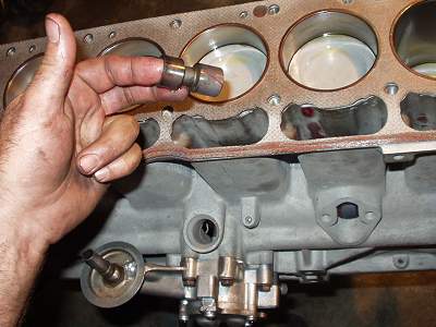

I have checked, measured, cross-checked, fussed and fiddled....
Time to install this head!
I run a light bead of High Temp. RTV along the outer "lifter rail" edge of the gasket, this ensures a leak-free seal there.
The main gasket surfaces get a light coat of spray-on "Copper Coat" sealer...
Oh... I almost forgot, get the lifters installed before you put the head on, it is a lot easier to do it with the head off!
(with later heads, you can not install the lifters with the head on)

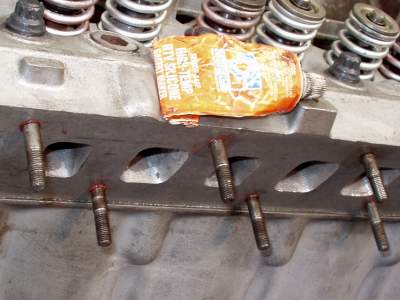

I use the high temp (orange) RTV on many different things so the tube gets lots of use. This product seems to have better shelf life then the regular RTV.
The product coming out of my current tube is good but as noted, if that well worn tube springs a leak, it is not long before the remaining contents cures inside the tube.
Anyway... used-up more of the stuff sealing all the manifold studs into the head. Yes, all of these holes went into the water jacket on this head.

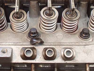

I am using special ARP head studs on this engine so I did all the thread chasing and fit checks before starting the head installation.
The Aluminum SL6 studs have a much longer course thread, in order to get deeper engagement into the alloy block.
(a regular cast iron SL6 head stud is on the left, the alm block version on the right)
Have you ever tried to "stab" a 14 bolt hole head onto 14 standing, 5 inch long studs?
I don't even try... instead, I position the gasket and head, then hold it down with couple of conventional head bolt, then screw-in all the studs after the head is in position.

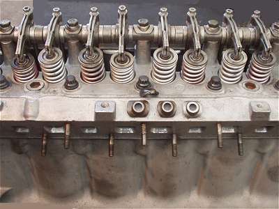

One other "trick" I use to set a head onto a SL6 engine is to bolt a bare rocker arm shaft to the head and use it as a handle.
This really helps with the 80 lb iron head.

Now that the head is on, don't wait to install the push rods and rocker arm shaft. Remember, the lifters are sitting there in their bores with nothing but gravity holding them in. If you move on to something else.... like installing the oil pan, you end-up with lifters on the shop floor.

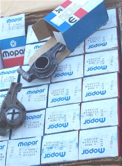

I pulled-out a box full of NOS Mopar rocker arms that have been waiting for a good home.

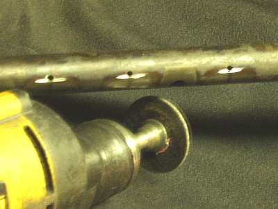

Took my "wizzer wheel" and "banana grooved" a slot across each oil outlet hole. This is done to spread-out the oil across the wear surfaces.

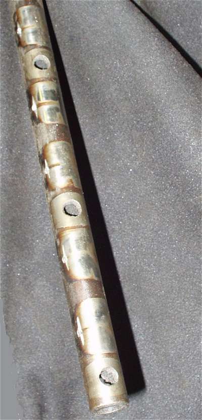

Here is another view of the shaft with grooves:
After the grooving, I punched-out the shaft's end caps and gave the unit a good sanding and cleaning.
One cleaning tip... I found some Army surplus gun cleaning kits at a swap meet, the kit has wire brushes and extension rods... this works great for cleaning a SL6 rocker arm shaft!

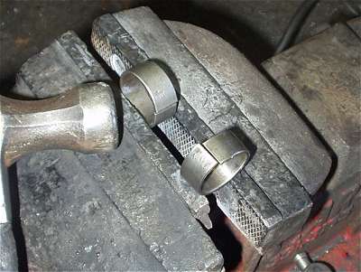

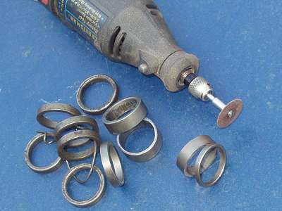

In the past I've spent a lot of time making special spacers to go in-between the rocker arms in order to get the correct centering...
These days, I 'cheat' and simply bend the spacer rings so they act a little wider then they are. (grind-off the sharp corners after bending)
After a few trial fits and fussing around by bending spacers and grinding the tabs on the bolt hold-down spacers, I had everything well centered and tightened down.
