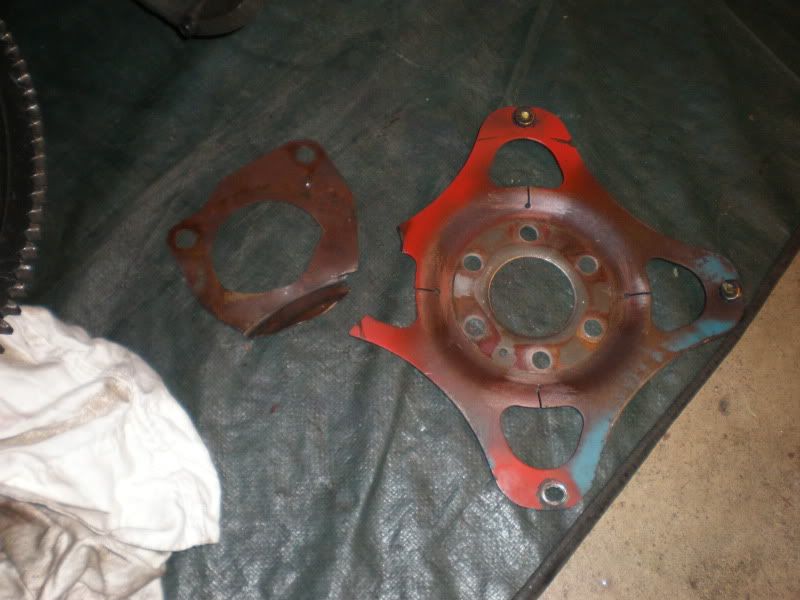

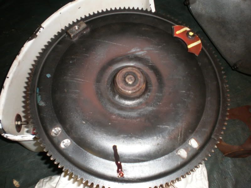

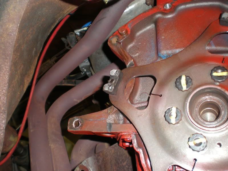

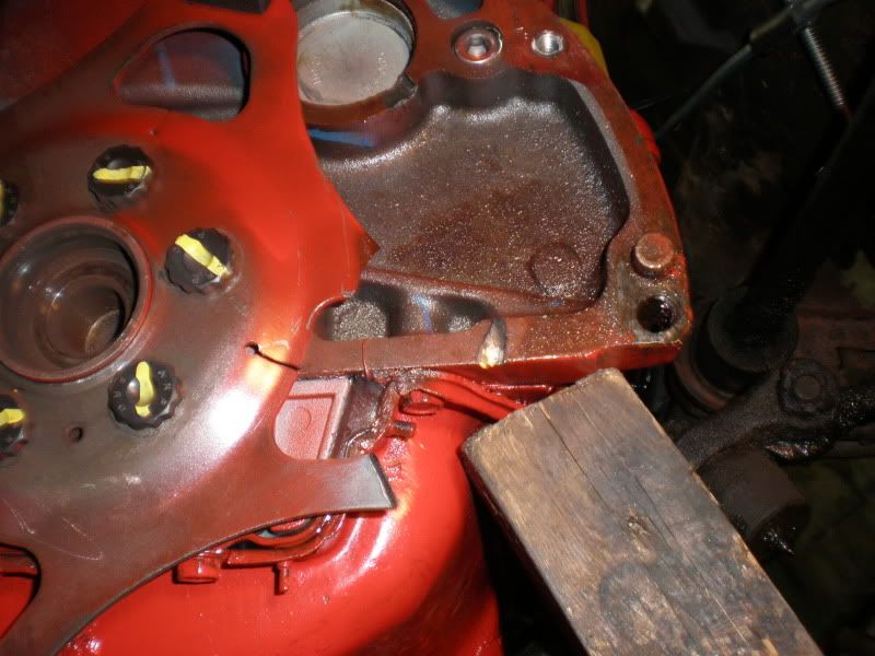

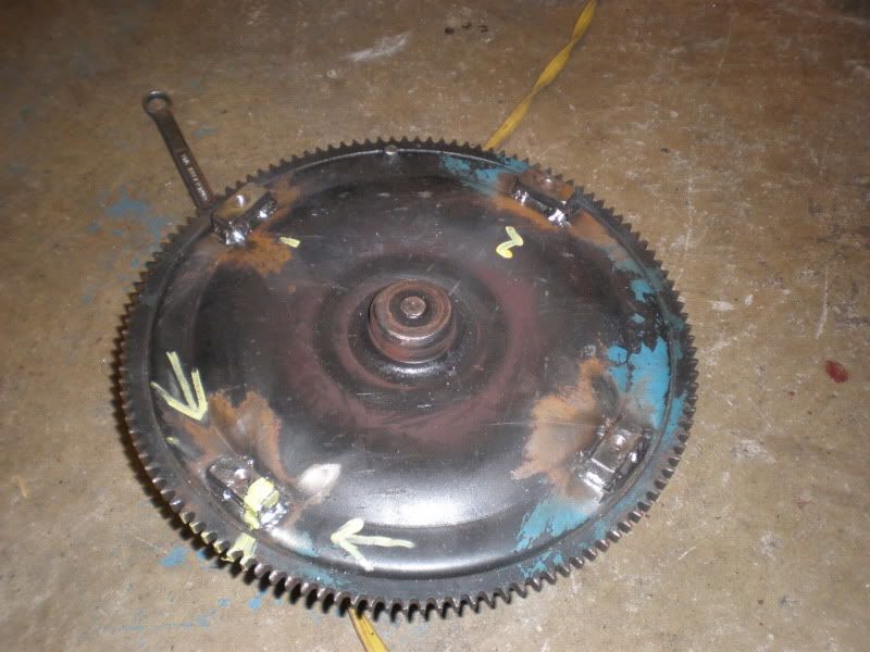

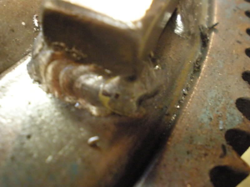

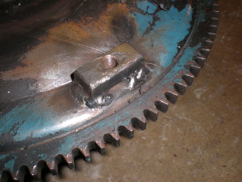

CARNAGE PICS BELOW! Nothing serious happened except for a bunch of rattling at idle like a #6 rod bearing was toasted.
Thankfully that was not the case.
Two welding points came off the Converter (see Pics) and one leg of the flexplate broke leaving one leg / bolt / mount driving the whole converter.
More updates coming soon!

I would send back to Midwest and have them fix the mounting points. Looks like cold weld spots.

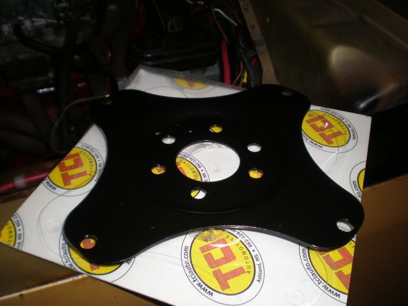

That new flex plate looks good and strong hopefully you won't run into this problem again. :)

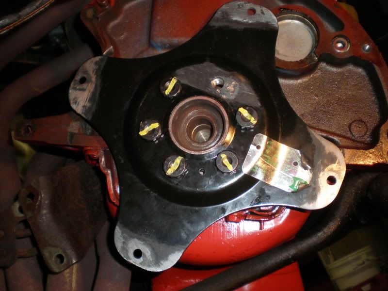

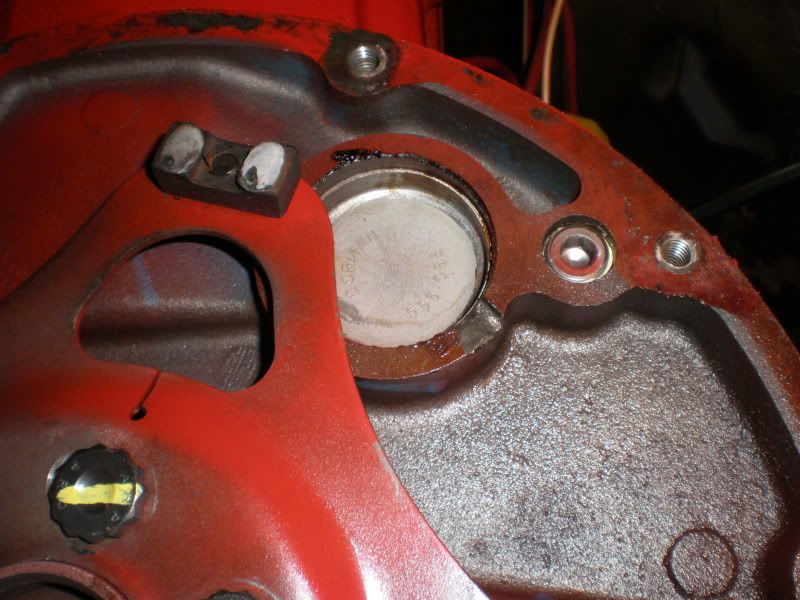

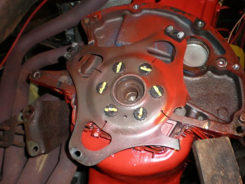

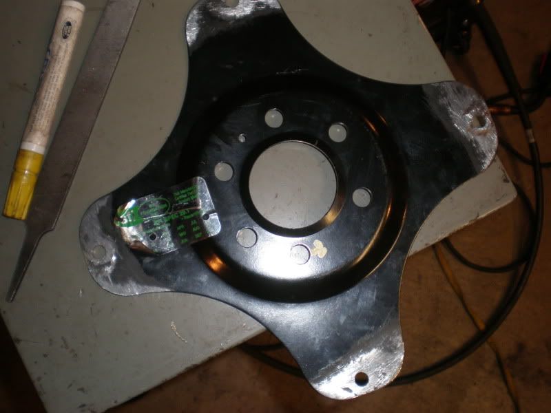

Well I got all the bugs worked out of the converter and flexplate on paper and in theory - I will have to wait until I get all this stuff put back into the car to really try it all out.

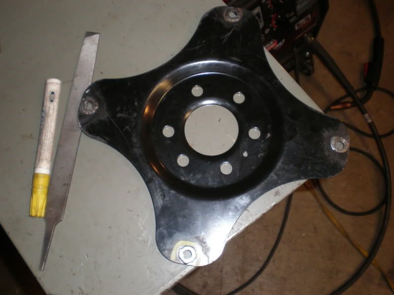

The TCI Flexplate is for an LA engine / 904 combo - Also it uses 7/16" sized bolts to mount a non - stock type converter - which I dont have. So I found some M6 Metric washers that were a few thousandths smaller than the flexplate to converter holes and welded them in to get the correct sizing there.

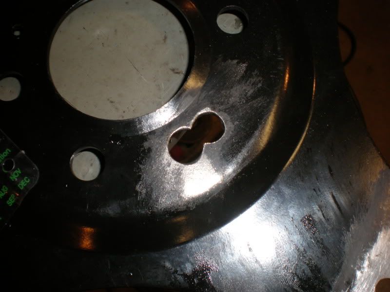

Also the V-8 flexplate has one bolt hole about 1/2" off where it would need to be to bolt up to a slant crankshaft. So I drilled and welded to fix that all up. Now I have A SFI Slant 6 flexplate (Kinda) with modifications.
Pics below.

Thats the way to make things fit nice job interested to see the car back in action.

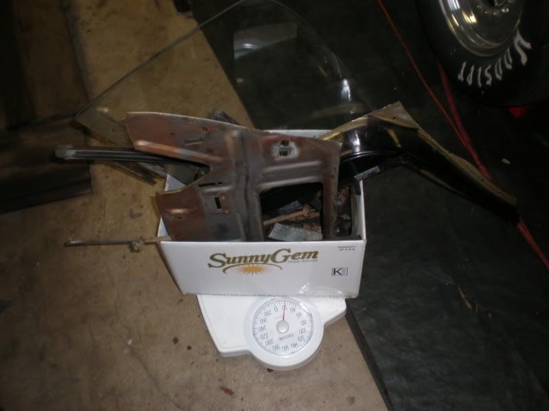

Ruster is going on a Diet in a big way!

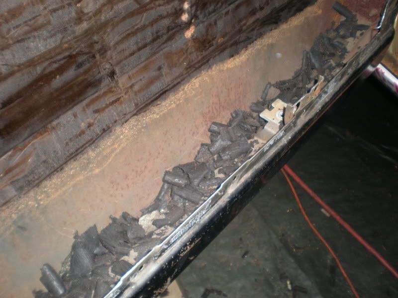

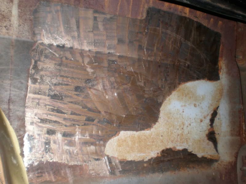

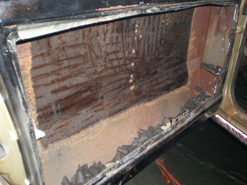

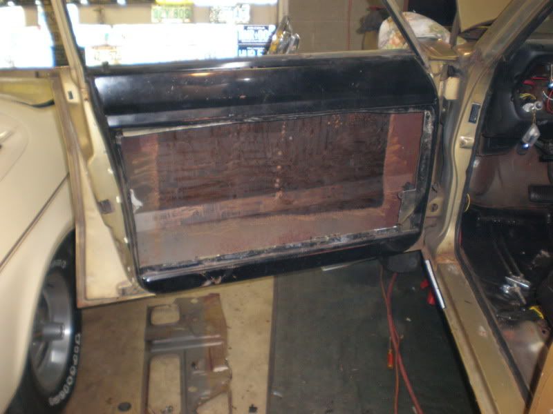

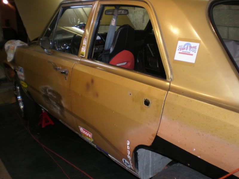

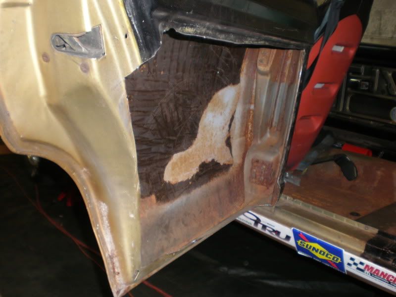

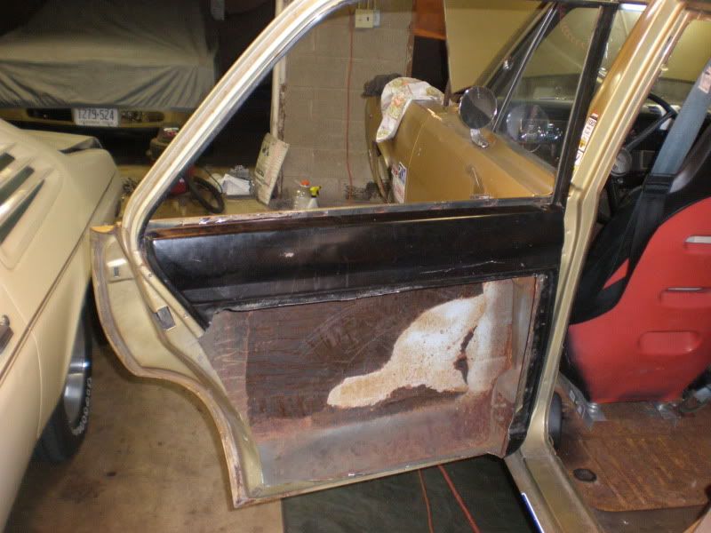

I started the Process of lightening up the doors.
I should get about 20# of glass, Window regulators, rustproofing and excess steel out of each door.
Some pics below:

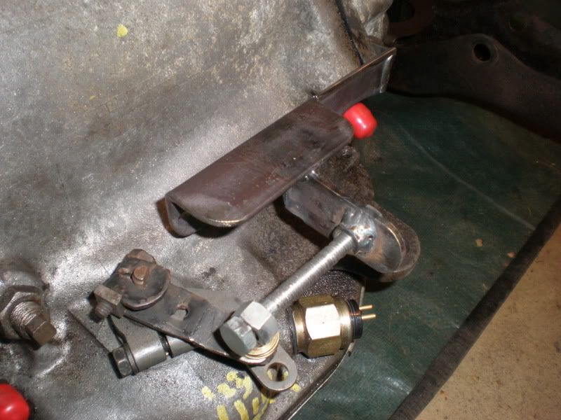

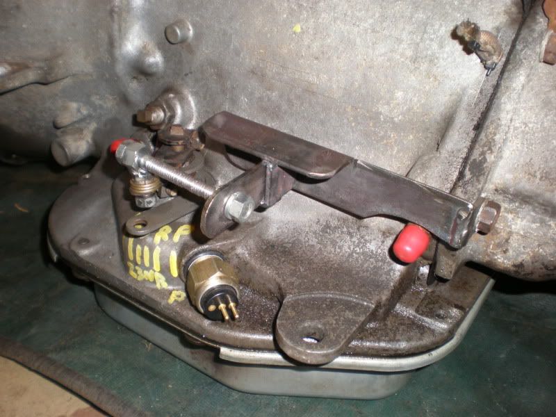

New Trans Kickdown Adjustment - Eliminating the Kickdown linkage / Cable from Carb. - Since the Car actually just runs mostly at WOT there is no need for a cable.

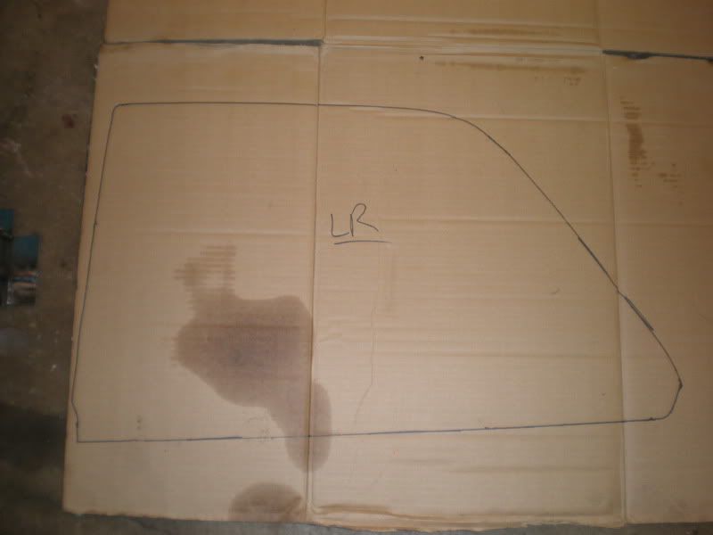

Rear Doors Lexan Template
Rear Goor Gutted
Next 3 Shots are of the Metal, components and Sound deadner removed from the door.
Everything removed from rear door is 20#
Front Door Gets the same treatment Except the Glass track will remain for an operational front window - It will get pulled up and down with an old dog leash or seat belt.
