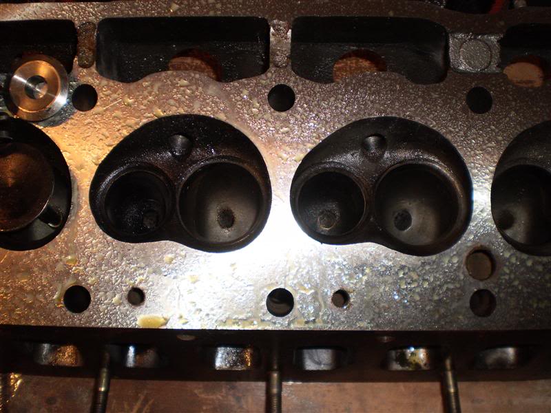

has anyone been hands on with a argentinian race head?
Yes (not I, though)
any chance the south american stock head has the fast burn chamber standard?
No. The only known Slant-6 head with what passed for a "fast-burn" chamber at the time was the mid-'70s US prototype aluminum head.

One head is in the US.
Here is the chamber shape.

when I look at that combustion chamber, I see a lot of valve shrouding
on a cylinder that is already constrained for valve size.

if we can go off of the engine info it was used on a 3.6 bore. i would love some measurements from this head - maybe a poured mold of the chamber side by side with a std head? is the guide c-c the same as a standard head? the thought of getting real info on that head is exciting. anyway does anybody have a thought on getting a pair of exh man to woody?

Last I knew the Argentinian head was in Minnesota. Current owner supposedly had it flowed and was underwhelmed at the numbers.
I have seen another head with welded up chambers like that. Last I knew it was on a Slant 6 record holding car.
