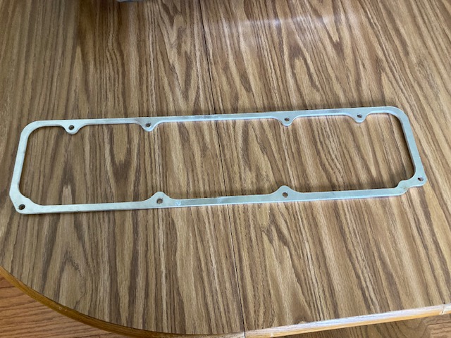

A project completed on the 68 Barracuda
I had installed roller rockers and B3 valve train stands, that raised the rockers enough to require modifications to the stock valve cover.
One of the mods was to remove the internal valve cover baffles. I installed a Moroso PCV line catch can and that was effective, but the catch can would fill after a hundred miles of easy driving.
To be able to re install internal valve cover baffles I needed to raise the valve cover. That was accomplished with the hydraulic head valve cover spacer mentioned in the CAD Cam thread.
I used a standard Fel Pro cork-rubber gasket on both sides of the spacer and substituted in studs in place of the standard valve cover bolts to keep things aligned during assembly.
Verified the under valve cover clearance with rolls of clay.
The results are all good. There is absolutely no oil carry over into the Moroso catch can after miles of spirited driving.
