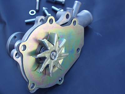

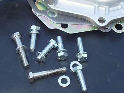

Purchased a new GMB made water pump today. These have the 8 blade impeller and bevelled separator plate.
I also "sprung" for some new bolts and went as far as getting a couple of stainless steel bolts... these are the two longer ones that go into the water jacket. The water pump was $32.00 and the bolts were another $5.00

This is pure ..... very nice! I used stainless as well, no more corrosion. Too bad you can't get that pump at NAPA.

Interesting, never seen an 8-blade impeller or bevelled separator plate like that. Do you figure these are design improvements over the 6-blade impeller and flat plate?

I have used GMB pumps in both my Chevy wagon and Grand National. They both worked fine and I never changed them again until going thru the whole engine, at which point they looked fine but were replaced anyway. The buick has a flow thru cast impeller and the gmb was just like stock, the chevy had the 8 blade stamped impeller, they are normally six.
Myself, I really cannot say if 8 blades are better than six overall. I can see it being better at low rpm since there is more contact with the water, and worse at high rpm for the same reason. Those flow cooler disks do help with this style impeller, but if you don't need it there is no point in loading the pump more.
I put a "Cardone select" pump on our slant, and it appears to be the same as the GMB pump in the pictures. I would not at this point use any of their rebuilt stuff, but when shopping for a water pump I wanted to be sure to get an new aluminum one. It has worked fine even in 110+ degree heat and traffic. My only concern is the separator plate eroding as the miles add up.
