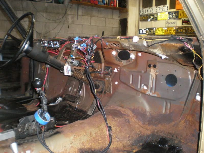

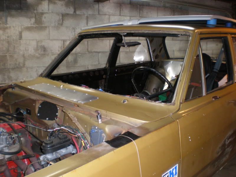

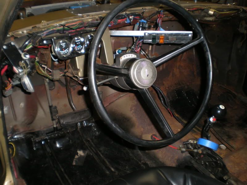

I got the windshield out -25#
Dash removed -25#
Other Misc. Items Removed - Sheet metal Braces wiper mounting Reinforcements, Steering column Braces Windshield Gasket / Stainless Trim:
-9#
So for today I got another 59# out of the front of the car.
Running total so far: 256# lighter than 2010.. That will go down a bit when I account for the lexan front and rear glass. it's not here yet.
Also I am Going to remove the Rear window... I guess 25#'s there and some more undercoating 2-3#'s there, and the rear bumper and support brakets - Maybe 30+ #'s there?

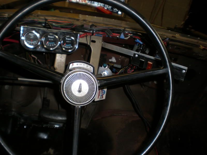

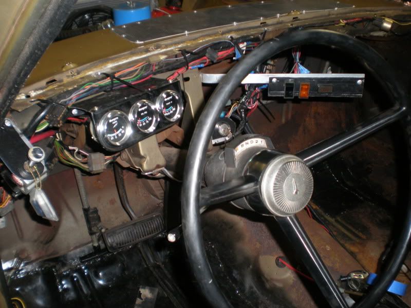

I did some relocation of the Gauges, switches and wiring, Still have to add the tach Back in. I built a real simple AL strap to support the steering column to the Interior Frame.. The One Chrysler gives you is like 3#'s It's built for a mack truck!
Pics:
Windshield Removed
Dash Removed; Mark should bee happy!
Gauge / Switch Panel Reinstall Pics:

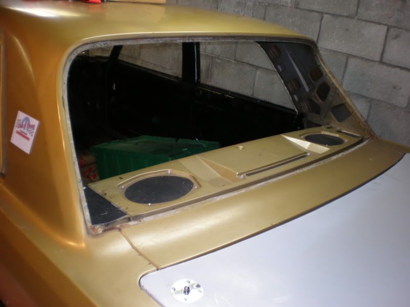

Rear Glass -17#
Rear Glass Gasket, Trim, Clips etc. - 5#

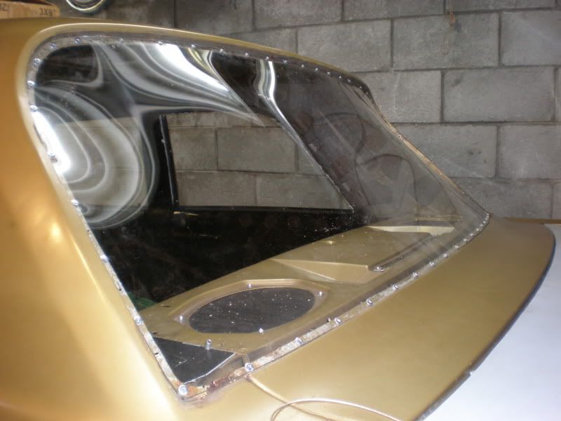

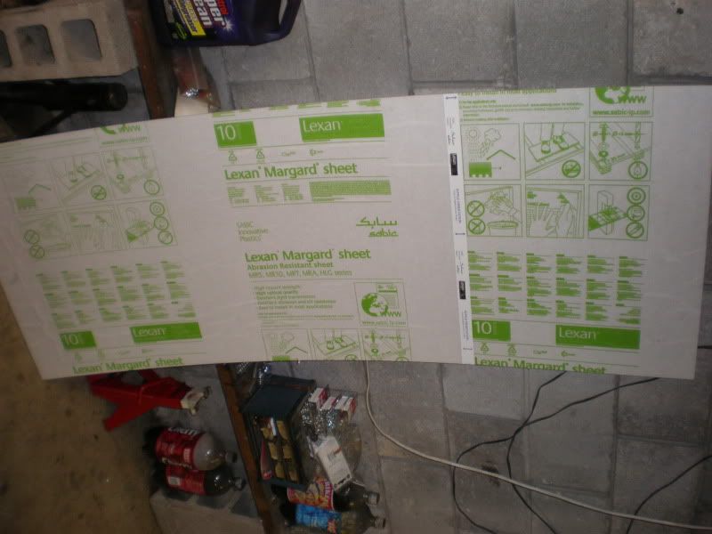

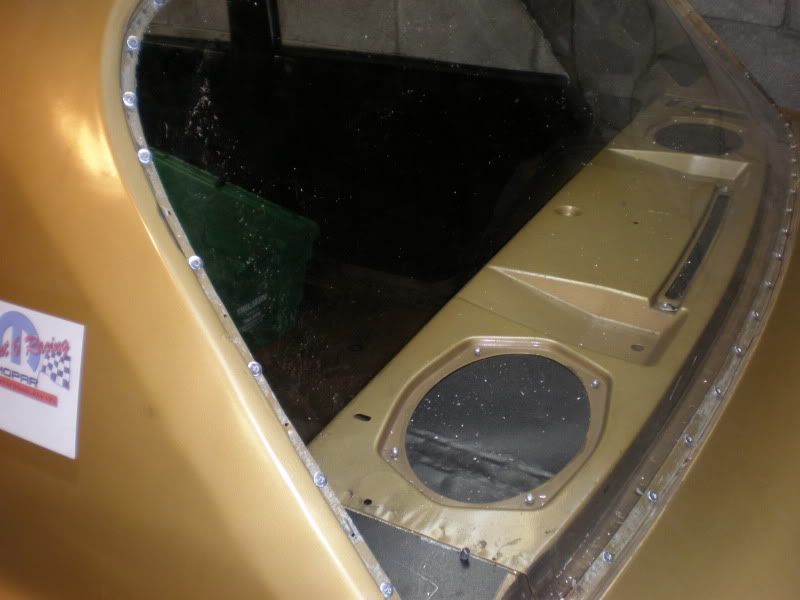

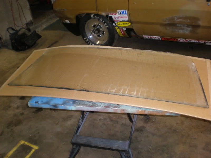

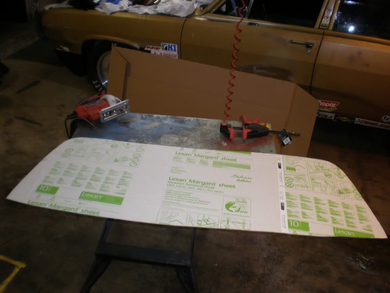

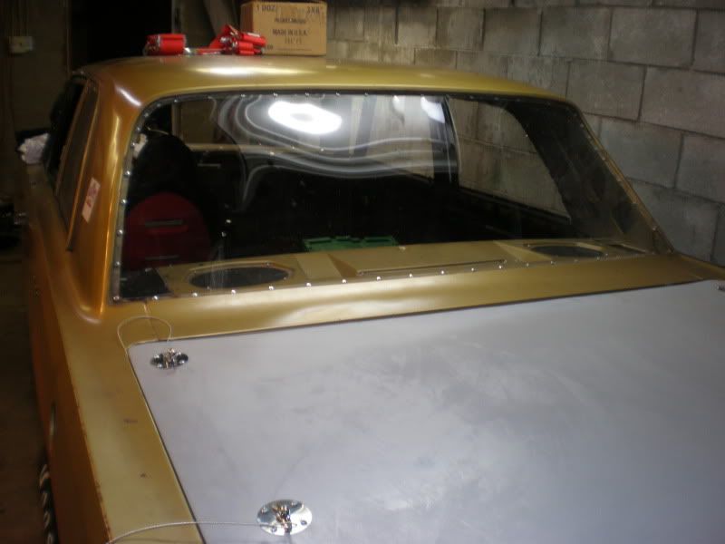

Well I got the Lexan rear window in - The Sheet Blank Arrived today and I wased no time getting it installed. Mason Dixon opening day / TNT is less than 2 months away!
Here are Some Pics:
I began By transferring the outer shape of the rear window to Cardboard.
Lots of compound Curves here that are tough to match on flat sheet.
Bye Bye Rear Glass / Gasket.
Sheet Blank - Gave me a few inches extra on all sides.
Template Transferred to lexan sheet - Lots of cutting, roughing in and test fits to get this correct.. I cant imagine doing this on a 64-66 Barracuda.
Install Complete. Lexan only adds 6# back to the car! YAY!
Lexan Rear Glass +6#
Total Weight Loss since November 2010 Now @ 272#

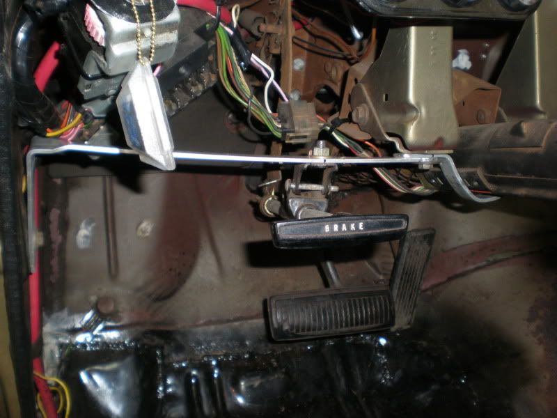

I made a Support bar for the parking brake - It used to conncet to the dash which is gone..
I made A "pocket" for my Junk that used to reside in the Glove box. Used an old Pant leg and basically riveted it to the floor.

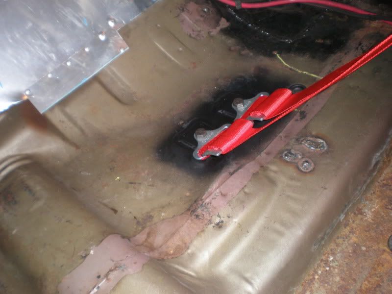

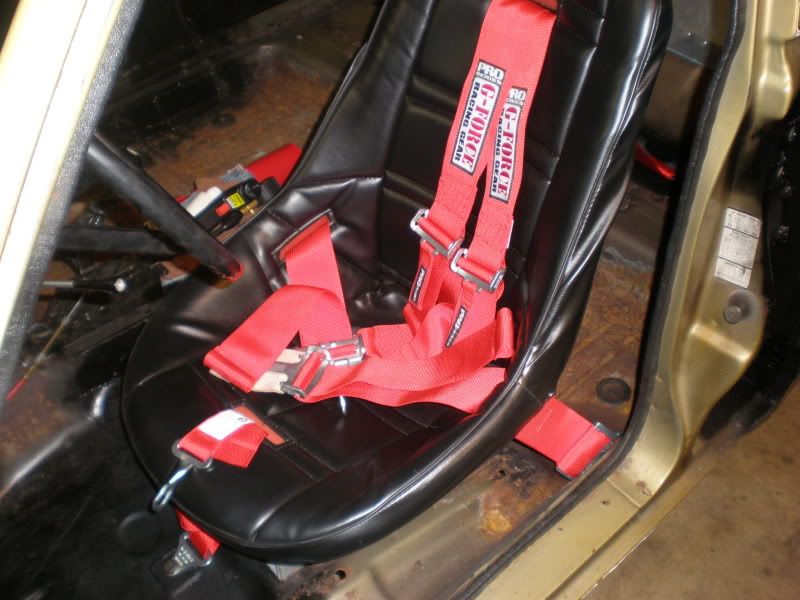

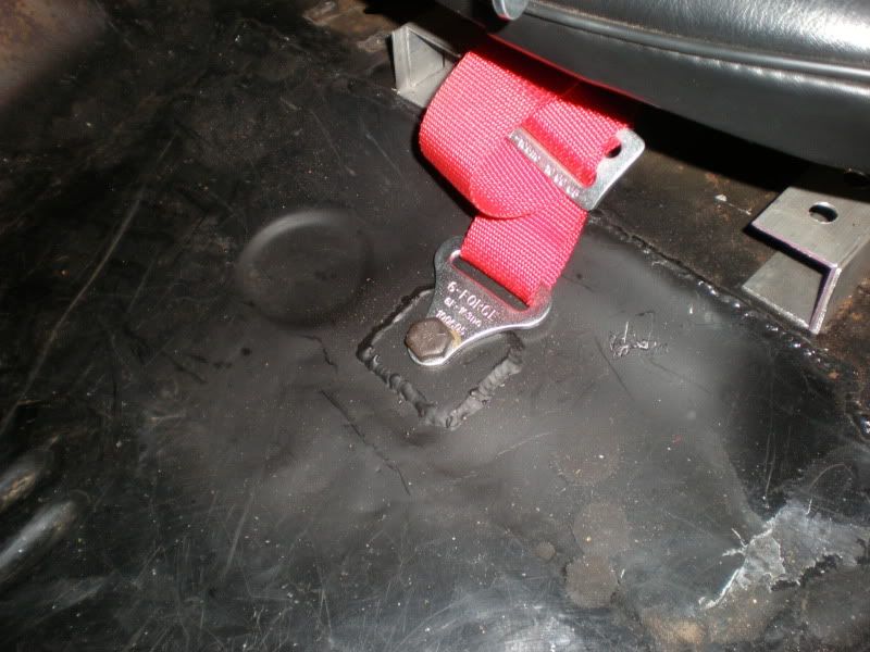

I got the 5 point racing belts installed!

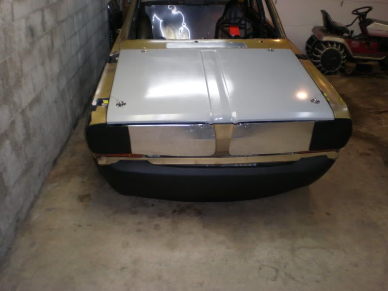

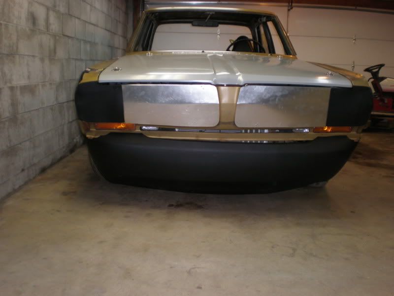

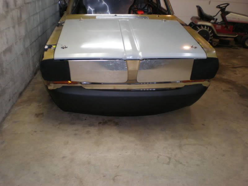

Fabbed up some grille Coverings:

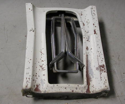

Terry, The grille is not gone, just Covered - They are easily removed with 2 Bolts.
I am also Thinking of going with the '67 Center Grille piece if I can find one :-)
