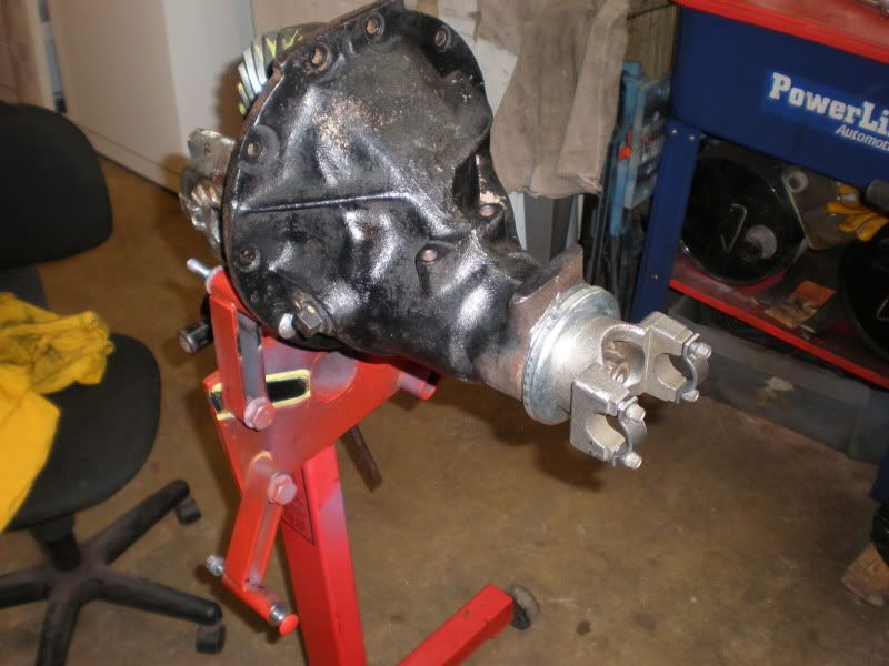

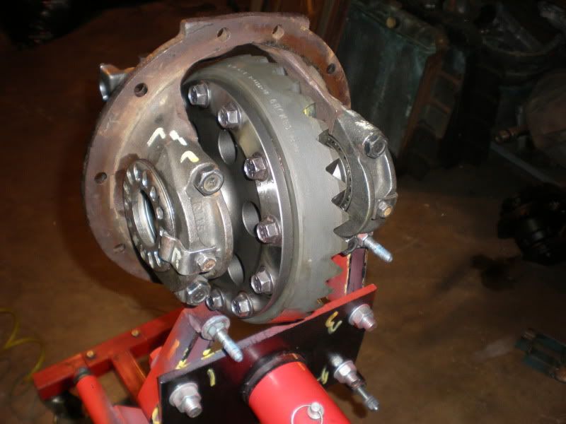

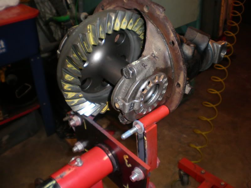

I got my 500CFM eddy carb back on and Reworked the Dist. a bit - Re-drilled a Dorman replacement Dist Gear and Shimmed it up for less "bounce / Play"
Also Welded up the advance Weights in the dist. Set it at 28* steady.
Got the Preload, Clearances and gear pattern set up in My 4:56 Spool Pig.

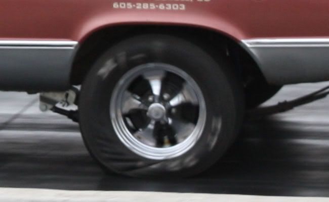

Hey Greg, do you have a vid of the car launching. Does the rear end get pushed into the track or gets sucked back up? Mine with out the Comp Eng Slide-a-Links would plant the rear and then throw it back into the car. I could see the tire loose its wrinkle and then hit again.
My springs are from a 69 BB Cuda, both have 6 leafs and the left has two clamp in the front and one in the rear. Right has two clamps in the front and the rear. Slide-a-links lowered my 60's by one tenth into the low 1.50's. Might want to look into a helper of some sort. I think you're running 12's right? Later

Mad Max, does you susp make your tires dig like this?
