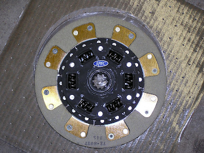

Does anyone care that the friction material pictured does not appear to be Kevlar? Spec Clutch's Kevlar material is tan. The organic material is pictured in Greg's post."
Hey Josh, I just go on what they told me. It looks a lot different from other organic disks that I have seen, but that may not be evident in person.

Hey Josh,
How can I tell if the clutch disk is organic or Kevlar?
When I look at other kevlar clutch disks on the web, they look a lot like the one that I have.
http://www.speedwaymotors.com/p/8680,38 ... -Disc.html
PostPosted: Tue Jun 10, 2008 8:55 pm
Stage one organic disc.
http://specclutch.com/csproductinfo.php?product=stage1
Stage two Kevlar disc.
http://specclutch.com/csproductinfo.php?product=stage2
The Speedway disc appears to have some Kevlar and the description says Carbon-Kevlar.

Josh, you were right. I checked with SPEC, and they looked at the picture, and admitted it was goofed up. I have a new disk coming.
I will put up pics of it when I get it.

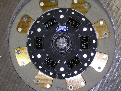

 Post subject: Kevlar disk pictures
PostPosted: Tue Jun 17, 2008 8:46 pm
Joined: Tue May 06, 2003 5:53 am
Posts: 750
Location: Crestline, CA
So, whatta ya think?
PostPosted: Tue Jun 17, 2008 9:04 pm
That's the ticket!

Nice.
Does that disc have a spring (can't recall name) between the friction discs (in plane of disc), or is it solid design. I prefer the solid design.
PostPosted: Wed Jun 18, 2008 2:52 pm
Posts: 750
Hi Lou,
If I am understanding you, it is a solid design.

That is a sprug hub, ( it has springs to cushing the load when inguaged).
That is one good looking disk also. It might hold more than 300ftlb of torque depending on what spring pressure they use in the plate.
Jess
PostPosted: Wed Jun 18, 2008 8:01 pm
Yeah it's sprung hub, but they were talking about the marcel in between the facings.
PostPosted: Wed Jun 18, 2008 8:28 pm
