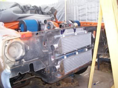

Hope this works. One of the Mega Squirt guys sent me some pics of his Turbo/EFI V8.

I kind of think you are right Matt. I think there is not enough room in front of the radiator of an A body to get too much intercooler there. How it flows makes a difference too; whether the tanks are on the long or short sides, and I honestly cannot remember which is better. I think longer tanks are better. Anybody know about that for sure. You see the tanks on the short side of all those low mounted intercoolers on import tuners. So either my memory is wrong, or the tuners intercoolers are not the most efficient. I've been wrong before. :wink: Anybody know for sure about this? If I will eventually try to get a bigger inter cooler on mine, but that project is likely a ways down the road.

Long tanks and short tubes are ideal. I'm not actually running this because one with short tanks and long tubes was easier to fit, but the tubes are the biggest flow restriction. Restriction is minimized when you have more tubes and they're not as long.

this isn't ALWAYS the case. Yes, long tanks and short tubes will flow the best, but it will not cool as well. A lot of the intercooler design comes down to what you're using. Generally (from what I've seen poking around all the turbo stuff on this site) it seems that on the slant people are running relatively low boost. Low boost means less compression by the turbo, which means its creating less heat, which means the intercooler doesn't need to cool as much, so you can sacrifice a little bit of cooling for flow. When running higher boost levels (my SRT-4 was running up to 20-21 psi) the turbo is working MUCH harder, and therefore the intercooler needs to cool more, so you'll need to sacrifice some flow for better cooling. Another thing to consider is that if an intercooler flows TOO well, then the air can move through it too quickly to be cooled at all. And finally about pressure drop. Pressure drop is not always indicative of bad flow. It is a natural function of cooling. As we know, cooler air is denser, so when the intercooler cools the charge air, the air will be denser, but being in a sealed system the air will lose a little volume on the cold side of the intercooler. When that happens, you will lose pressure, but not because of bad flow, but because of good cooling.
