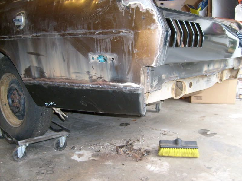

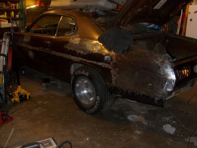

Mostly finished welding in the passenger rear patch panel today. I am getting better at welding and the welds are coming out smaller and cleaner. I was even able to bridge those huge gaps without making too much of a hash of it. Some grinding and one more clean up session with the welder and I think it will be time for Bondo. The metal didn't warp too bad, but it definitely will need to be made perfect with Bondo.
My brother has decided he wants Demon taillights, so he scored a pair of taillights on eBay and he is saving up to buy a repro Demon tail panel. More welding, but it shouldn't be too bad.
Ordered a set of air powered shear to trim out the rust on the passenger side rear 1/4. I got a patch panel for it, so that shouldn't take too long to fix.
The biggest achievement was stripping off the entire front clip. No more 74 Duster nose. I picked up an entire front clip off of a 67 Dart GT last week to put on the Duster. Just for giggles we hung the fenders from the Dart. Looks pretty cool. So when we get done it will be a 74 Duster body with 71-72 Demon taillights and a 67 Dart front end. :lol: Kind of like the Dacuda, but more like a Dartster, or a Durt, or a Demster, or a Dustmon. :)
My brother is working with a guy he knows in Seattle to repair and reaint the sun damaged plastic interior trim pieces. The pieces are being repaired with fiberglass where necessary and are being repainted black with subtle grey highlights. It will all look very nice when done. My brother brought down a kick panel and the trim from the top of a door panel. Both look great.
Since the tranny is already out, next session will probably be pulling the engine and doing some work on the rear driver's 1/4. After that the tedium or sanding and doing Bondo and some POR-15 repair work starts. Image

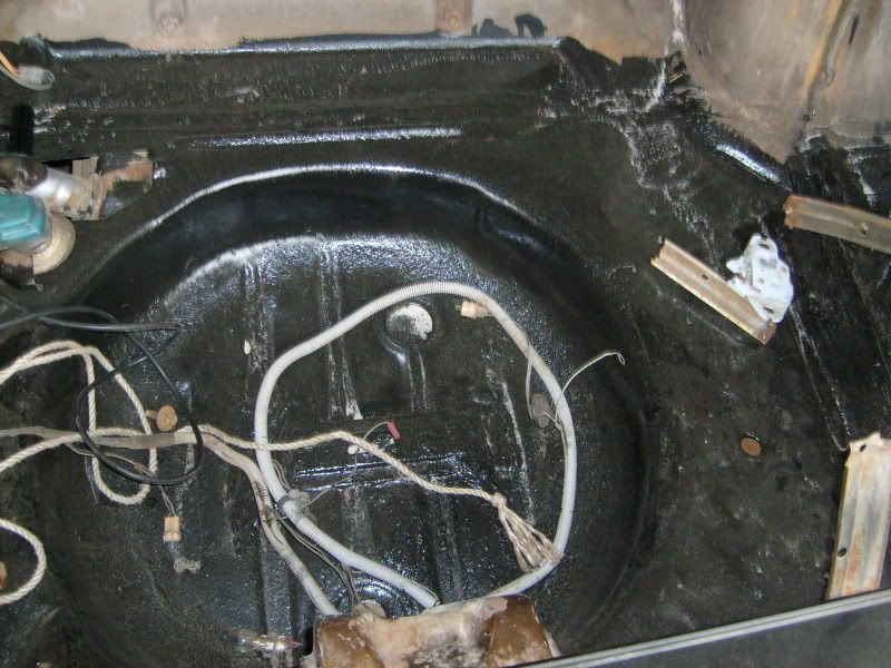

Got the trunk sandblasted/sanded and coated with POR-15:

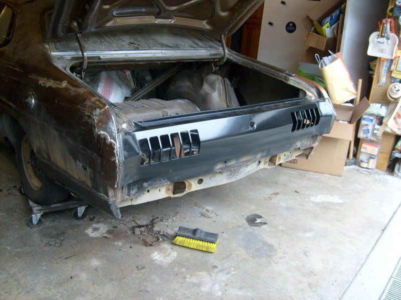

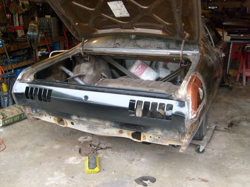

Got a replacement Demon tailpanel off of eBay and got it welded on in place of the stock Duster tail panel:
Hey! You stole my idea! :wink: Did it fit in pretty good, or did you have to cut the tail panel for it to fit the '74 style?
'74 Duster 225 Super Six w/904
14" Cragar SS wheels
PostPosted: Fri Jul 24, 2009 1:56 pm
Posts: 13421
Nope. It fit right in. All I had to do was drill the factory spot welds out on the old tail panel and this one fit right in place. There is a slight difference in the shape at the upper corners in the trunk area, but there is plenty of metal for welding it in. The bottom of the panel does have a different profile to accommodate the crash bumper shocks on the later models, but not enough to worry about. I will get it to seal up with some welding and seam putty. The only bad part is the tail panel doesn't have the braces for the Demon tail lights, so I need to fabricate those. Otherwise, it fit right in. 8)

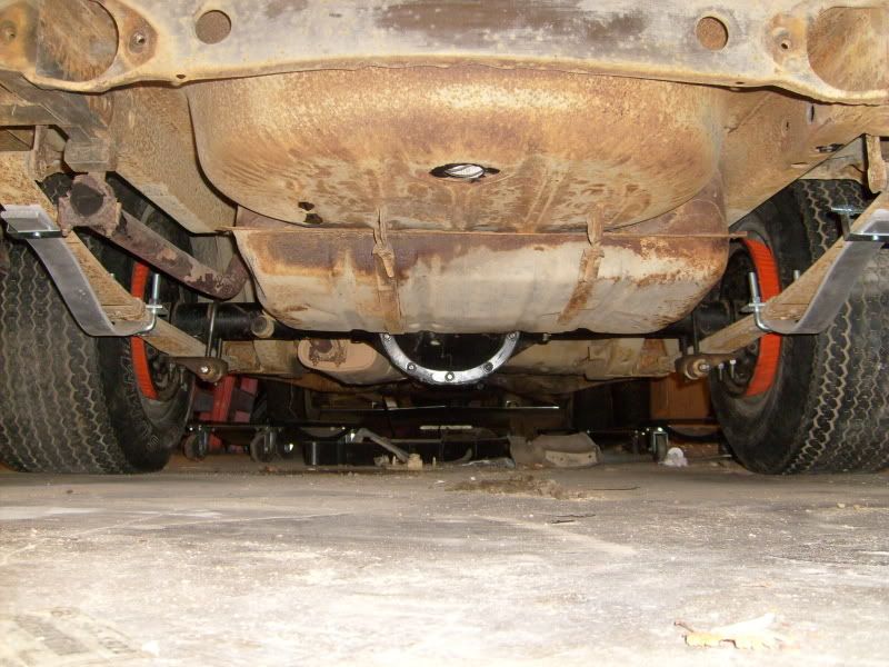

Got the original 7 1/4 small bolt pattern axle out and swapped in the 8 1/4. I was able to re-use the 7 1/4 shock plates by drilling out new holes for the u-bolts. Got the massive 15x10 rear rims mounted, but one of them has an obviously different offset than the other. Will need smaller tires at least, probably will need stiffer and higher arched rear springs. :x Note the huge orange 11 inch rear drum brakes. My brother will need them when he hydroplanes with the fat rear tires on Washington's rainy roads. :shock: A trip to the boneyard for a gearset out of a Jeep will be necessary to replace the 2.2, yes, 2.2, gears in the rear axle.

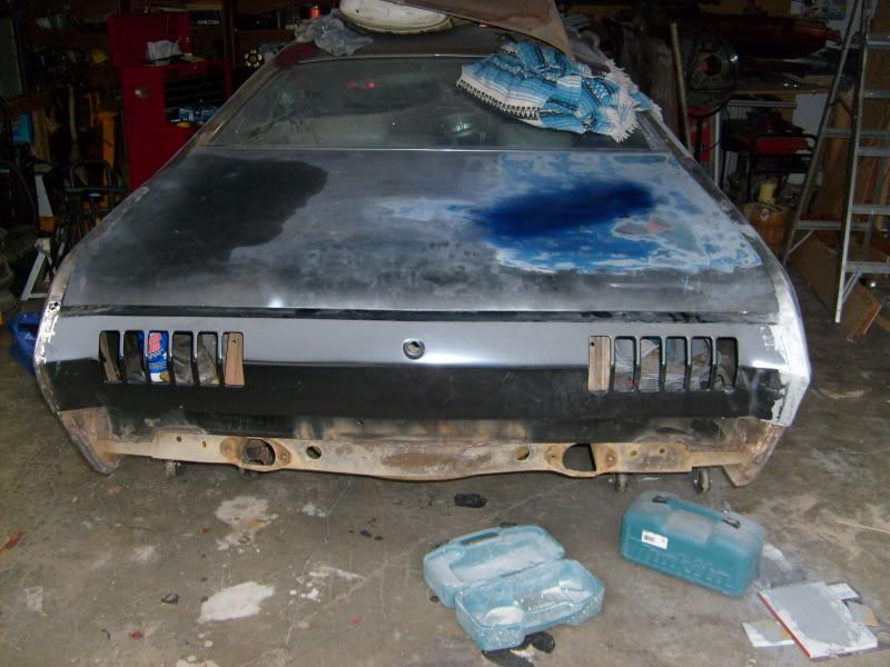

Minor setback with the Demon tail panel. Both sides of the rear end of this car have been hammered in accidents and then pounded back out. The passenger side is worse and required a patch piece to be welded in. Somewhere along the way, the contour of the body got tweaked enough so that the demon tail panel has to flex at a sharper angle. This makes the taillight on the passenger side not fit correctly on the outboard edge. The body is too hammered to make it worthwhile to remove the tail panel and fix the problem, so I will be coming up with a solution to keep the water out of the trunk. Maybe a ridge of body filler and some extra weatherstripping will do the trick. :roll:

Started applying body filler (Allmetal is good stuff) and replaced the tweaked 74 Duster trunk lid with a straight 70 Duster trunk lid. I like the 70 better, no ridge down the middle of the trunk lid.
