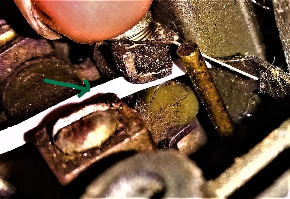

That white 0.010 shim, if that was in place during adjustment ,that extra gap would allow the vaccum piston,under high vaccum to pull rods down an extra .010 Leaner. |
