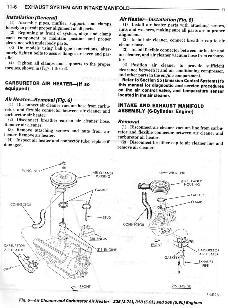

Posts: 13427
From my 1982 Dodge van factory service manual:
Rocker arm removal and installation:
Manifolds removal and installation:
Note that the factory service manual is still using the installation diagram from the old shaft style throttle linkage in pre-66 cars for the 1982 truck and van shop manual. Cheapskates...

Location: Chattatnooga, TN
Alright! Thank you so much. That's exactly what I needed.
