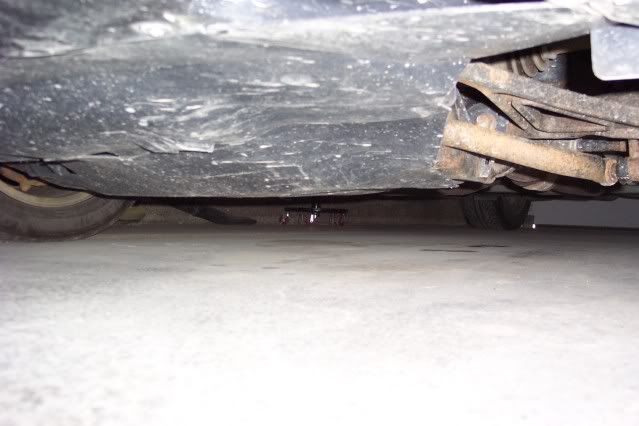

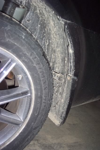

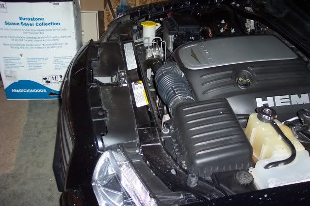

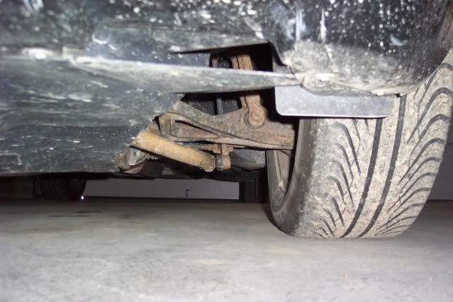

Maxwell Smart:
He didn’t bite on the old Prius idea 99, perhaps he will get some wind in his sails with this one:
If one inspects a modern car he will discover that the wheel wells have been reduced to a cavity not much larger than the tire its self, and the large open areas under the fenders sealed off from moving air, or in rear behind tire opening filled with aerodynamic mufflers presumably smoothing laminar flow back under there.
My 300 has some sort of rubbery belly pan under the engine that the oil change guys try to charge extra to remove to access the oil filter, but where it is held on, I think, by four twist tabs they let it pass.
Also on new cars there are no gaps from bottom of bumper fascia to hood leaving only an air passage to radiator. When hood is open there can be seen plastic horizontal sheets blocking any air from passing up and over radiator into engine compartment.
I should think that adapting some sort of filler between back side of bumper and body would help, as these were one of the first airo cues applied to the cars of the seventies just before plastic clad bumpers such as K Cars sported.
Study of late seventies & early eighties cars may yield clues that can be adapted easily to your Dart as these cars were products early wind tunnel testing, and still closely resemble late sixty’s build style.
Sam, take a field trip to a Ford dealer to examine an ‘05 – ‘09 Mustang (‘10-‘12 Stangs are much smoother up front), and a sortie over to the Dodge boys to look over a Challenger both of which have concave front grills to see how the engine compartment & wheel wells are sealed.
Bill.. No... Max
Shoe Phone:
300 Belly Pan:
Belly Pan & air dam in front of tire:
Just 44,000 miles, and four Maine winters to rust suspension components…
Muffler aft of rear tire filling space to bumper:
Plastic wheel well with vents & after market Mopar molded mud flap blocking air flow to where muffler is located:
Cladding preventing air flow from front of radiator passing into engine compartment bypassing radiator:
