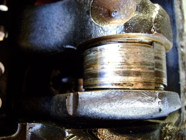

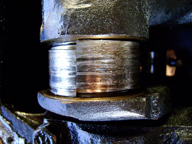

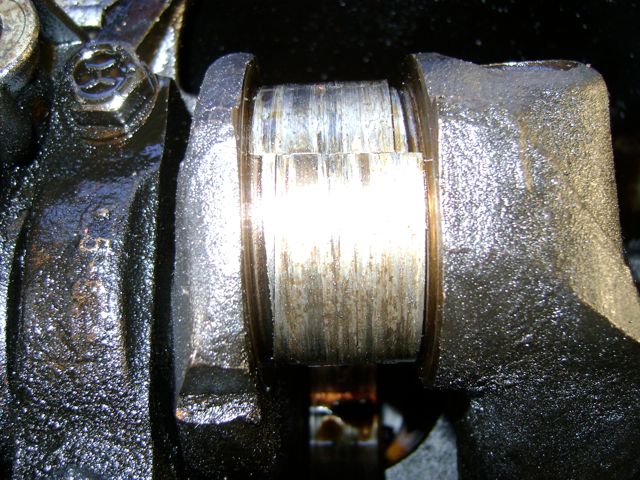

Well, pulled the pistons out today, but didn't get to the crank, because I need to borrow/go pick up a 3/8" 12 sided socket. Don't have that one in the inventory of tools. Can't take off the rear main seal without it.
BUT, take a look at #6 piston and crank shaft journal. A spun bearing! So far, this is the most obvious thing that was giving me bottom end noise: everything else looks copacetic. There was a heavy burned-oil smell as I dismantled #6. But, there's no telling when the other rod bearings would give out.. They seem on the verge of replacement, though one look at the bearing surface shows deep wear in pretty much all the rod shafts.
#6:
