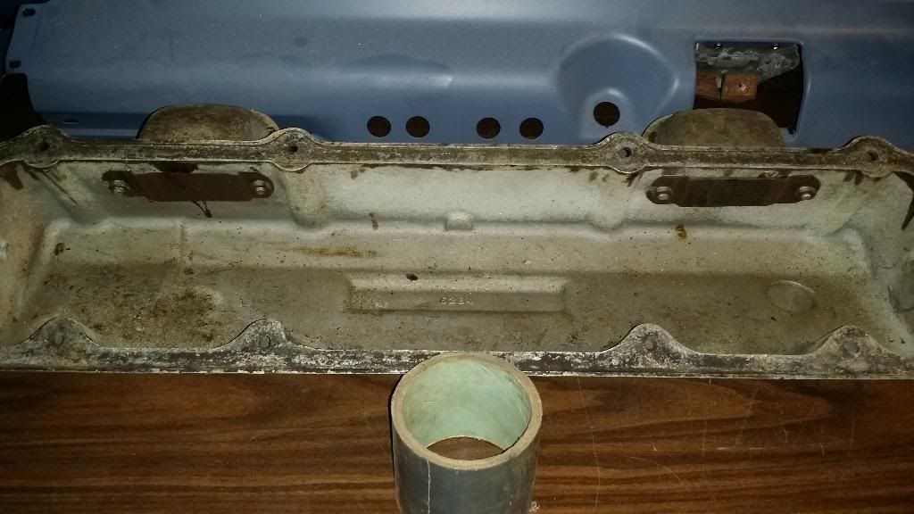

JR- Can you post a picture of the inside of one of your Offy Valve Covers? Baffled about Baffles! :lol:

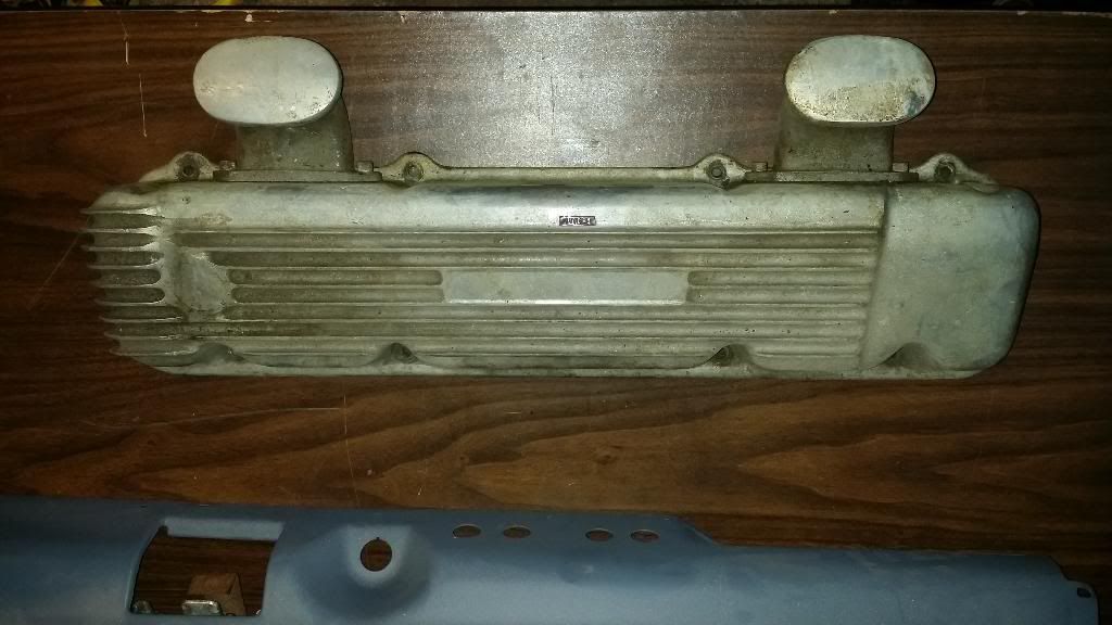

They are just old no name aftermarket breathers, might be old Cal Custom pieces. You can still pick them up at swapmeets but they defiantly aren't as cheap as the used to be.
Valvecover is just an old Offy that had the name milled off and the front of the fins notched back in the 60's to clear something when it was in a 56 Alfa SCCA car.

Thanks JR! Those are Great! Very interesting find!
