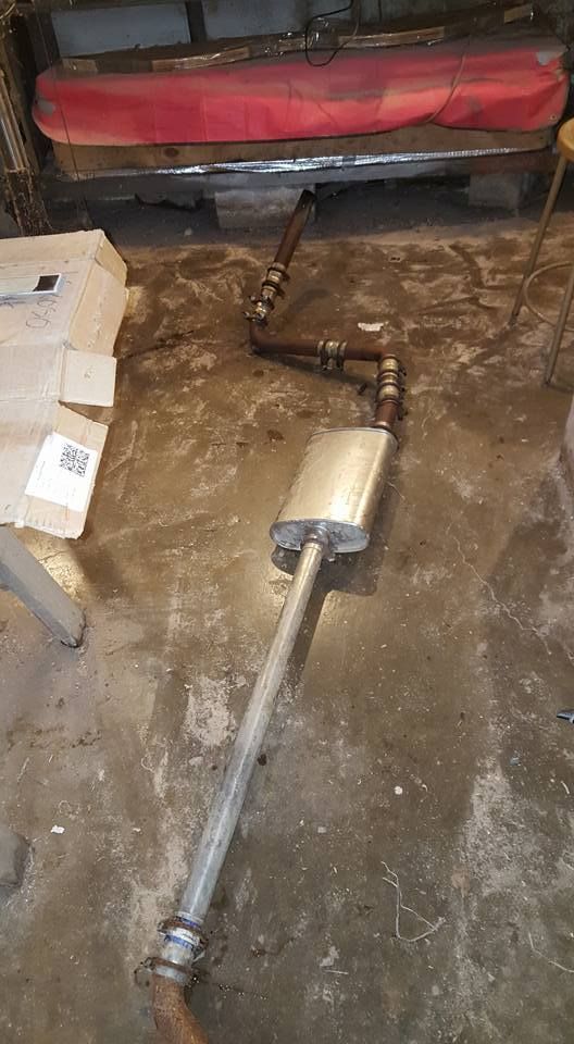

Yesterday the high was going to be around 40* after several days around 25*, so I took the opportunity to start trying to fix the exhaust on Grandpa. It has been unbearably loud while cruising, as the dumb flexible pipe is every form of useless. I started by removing the "craptastic" exhaust I put on the D100. I was able to save almost all the clamps, and with a trip to the hardware store got a Sawzall and started hacking.
I saved the muffler and put it on the stock pipe from the D150 in place of the rusted out cherry bomb the kid had put on before me. I also managed to get the off-manifold section I had used onto the D150. I fitted and clamped some of it up last night and tried it, and it sounded much better. Nice and quiet with a healthy tone revving.
This afternoon I'll finish clamping and securing and will test it out. Fingers crossed.

Got it all sorted out! Not a perfect job, it looks kind of hokey, but much more quiet! Just need to put an exit tip out the side/back, but that's a good chance to actually get some welding practice. Next step will be some extra insulation/sound deadening in the spring. Make it a cruiser. :D

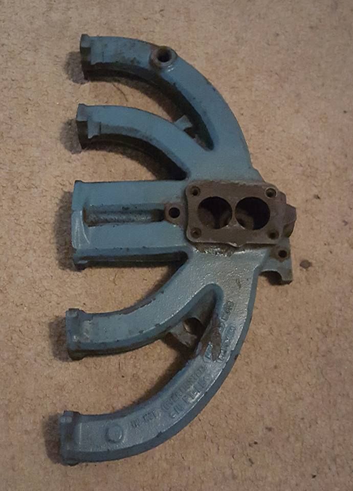

First up is my new two-barrel manifold from Smitty040. This is the first part of my Weber conversion. Next up will be ordering the carb, a 38/38, and a fuel pressure regulator.
Depending on what happens, I would also like to upgrade from a patched-together 2" exhaust to a new 2 1/4". My brother has some pipe and bends left over from one of his trucks, so I'd just need a couple more pieces and a new muffler. I would hope between this and the Weber I can smooth out the idle and give it a bit more "pep".

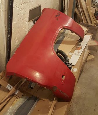

Down at school my brother and a friend made some junkyard trips. He snagged this driver front fender for me. I've been busy with work, but I intend to start sanding and glassing the one bit of rust in preparation for painting come spring.

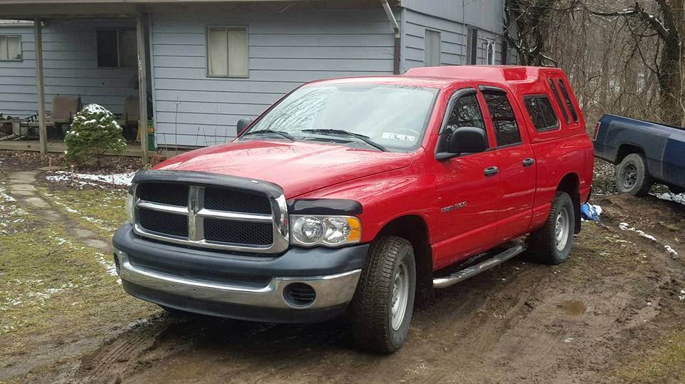

Wound up buying the four door. It's a nice '04 Ram 1500, 4.7L V8, 4x4, 5 speed. Manual locks and windows, which I like, and a mechanical transfer case, which I really like. So my '94 is going on Craigslist.
This thing doesn't need much, just some basic maintenance. Which means my time can be spent restoring Grandpa to the best of my abilities. I'm putting together a list, and hopefully once the nice weather hits I can start making some progress! It's a nice old truck and it will be nice to take the time to fix it up properly.
