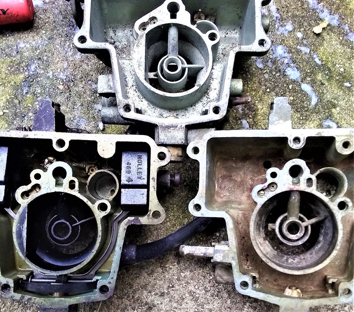

Pictures of sim kit for that bulletin

| Author: | matv91 [ Fri Aug 07, 2020 7:34 am ] |
| Post subject: | Re: 76 emissions and TSB,s |
| Author: | matv91 [ Fri Aug 07, 2020 10:46 am ] |
| Author: | matv91 [ Fri Aug 07, 2020 10:53 am ] |

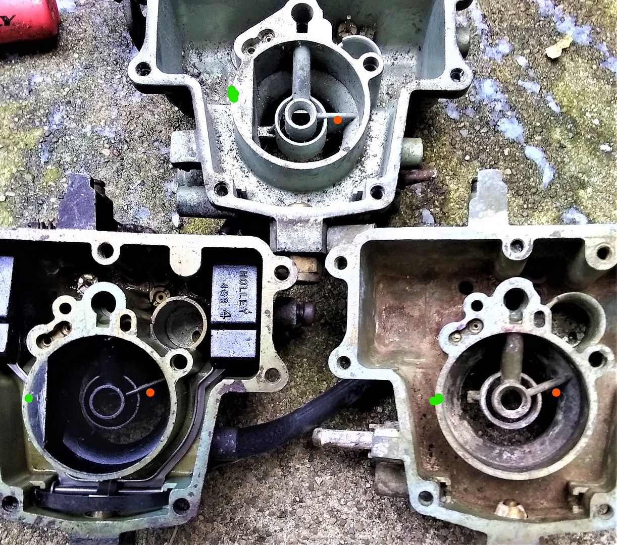

After that bulletin the shape of venturi changed round to D shape,green dots, The pictures in the 77 fsm also changed. The wings also in venturi also some difference,s red dots |
