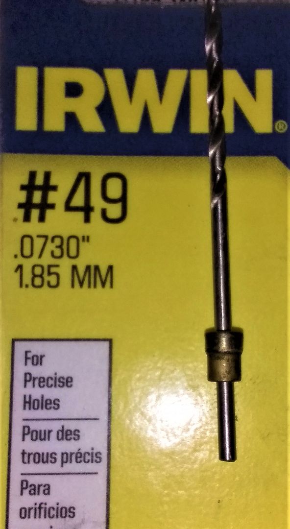

For temporary diagnostic testing removal is okay. A better option is to measure the size of that hole, and make it bigger just by a very small amount say .003 to start.
PostPosted: Tue Dec 08, 2020 3:53 pm
Posts: 1603
PostPosted: Tue Dec 08, 2020 5:27 pm
Posts: 1603
These restrictions probably came in different sizes, for different applications. Did the math, upsizing to a number 48 drill bit .076 would increase flow in the idle circuit 8.3%. Considering today's gas and the fact that your truck is stick shift, it should run better without Wrecking gas mileage.
