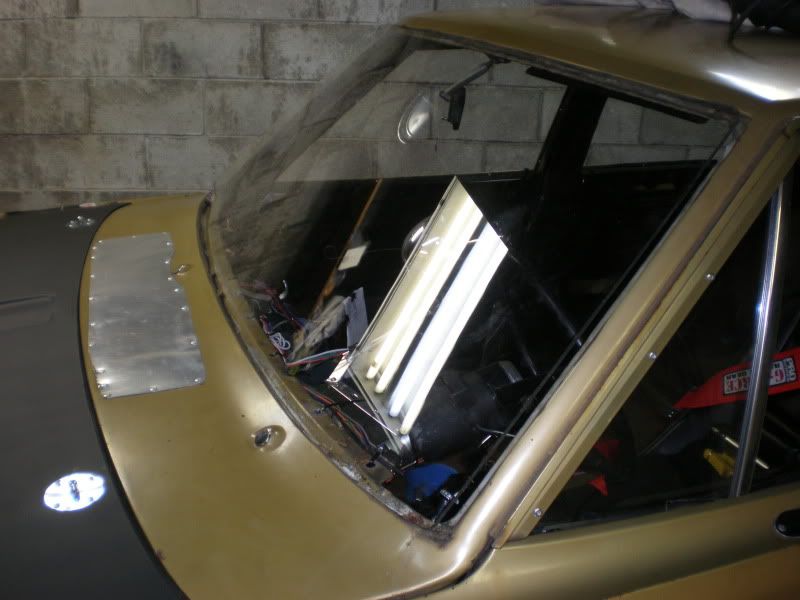

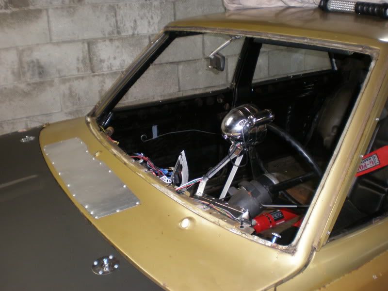

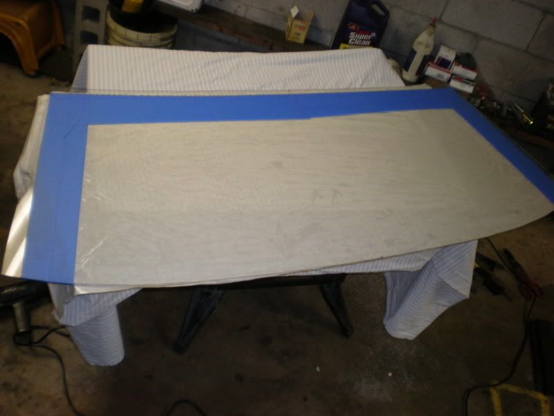

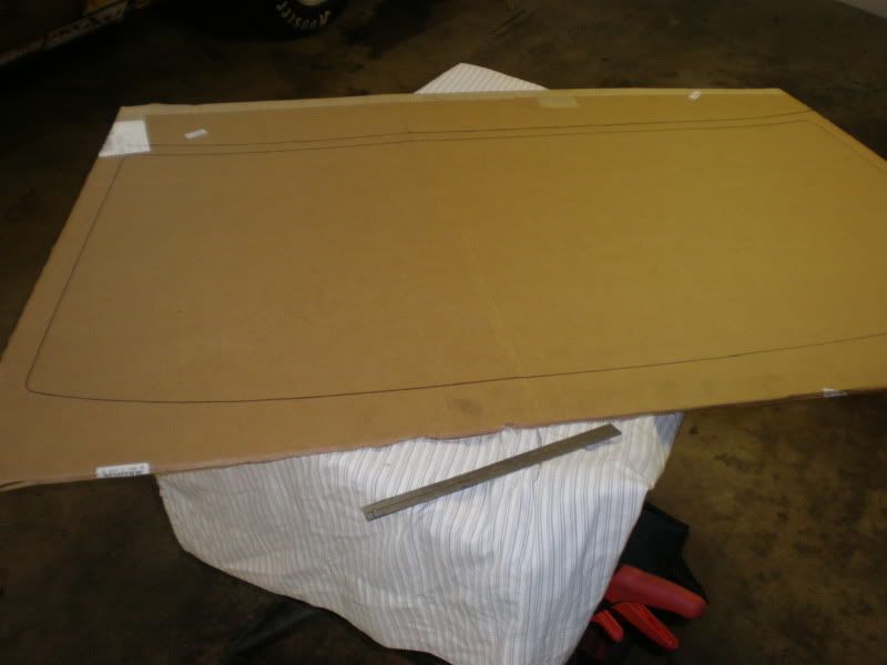

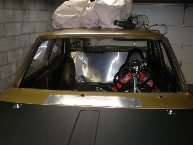

I got my sheet of front lexan today - Summit Ended up Shipping me a sheet of 3/16" instead of 1/8".
Oh well I installed it anyway - Probably added 3~3.5 Pounds to the Front Lexan Weight.
Stock Windshield: 25#, Lexan Windshield 9.5#
Add 9.5# for lexan Windshield install - -
Total Weight Loss since November 2010 Now @ 272.5#
I will rivet it down tomorrow - ran out of time and rivets tonite:-)

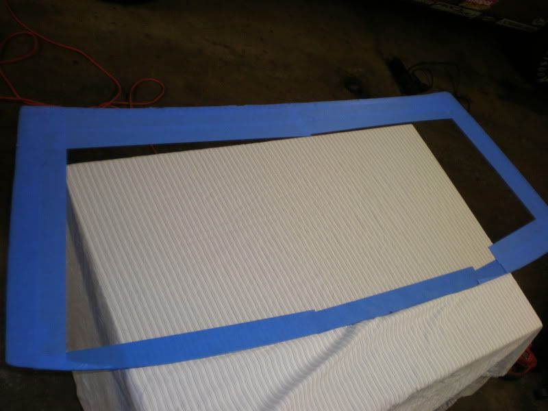

Pics:
Template on Cardboard - Oversized.
Tach reinstalled - Waiting for lexan.
Trimming and laying out the Lexan:
More Trimming and test fitting - Many times...
It fits - Finally - No rivets yet, but the holes are layed out/ Marked for drilling. It's there, just soooooo clean it's hard to see. :-)
