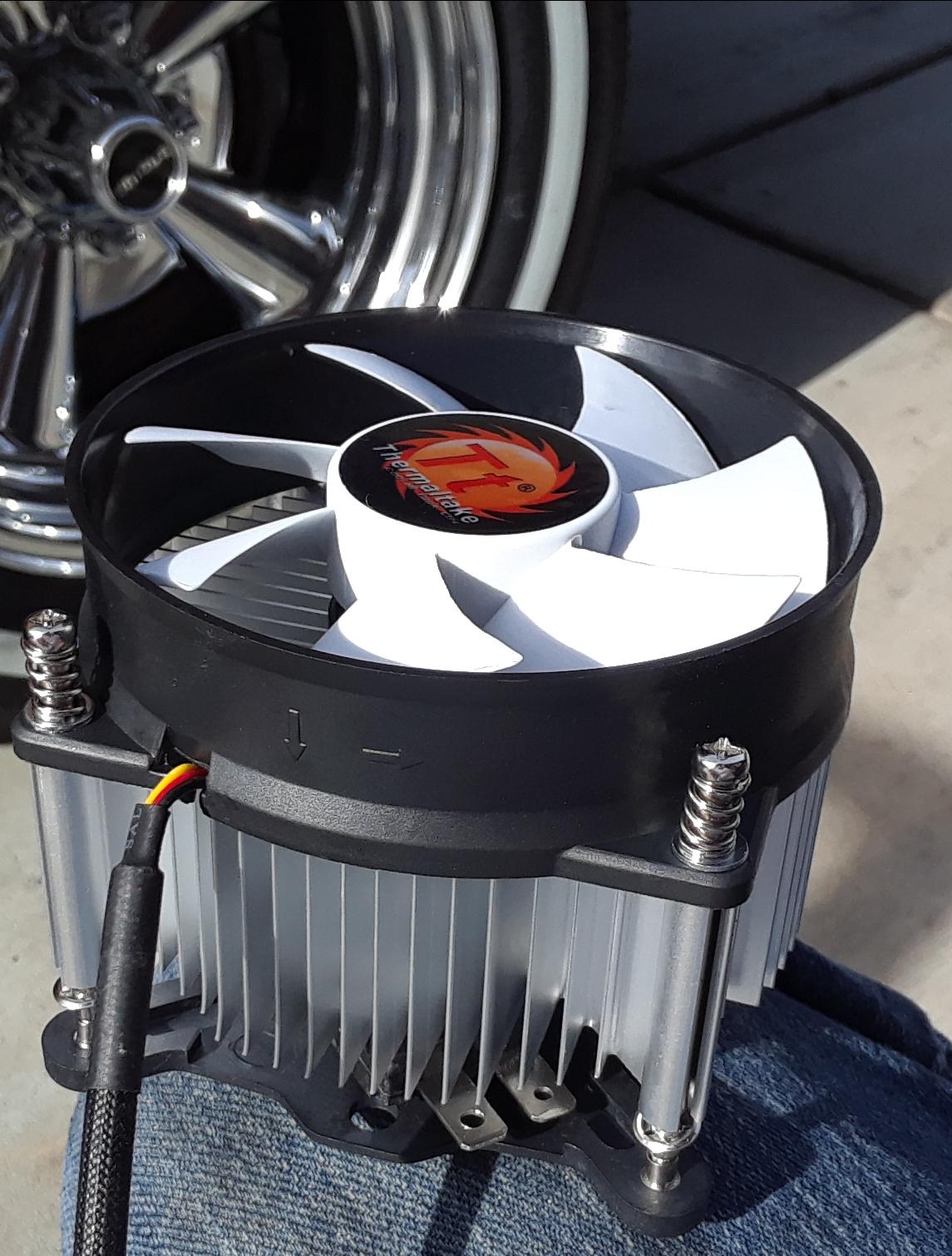

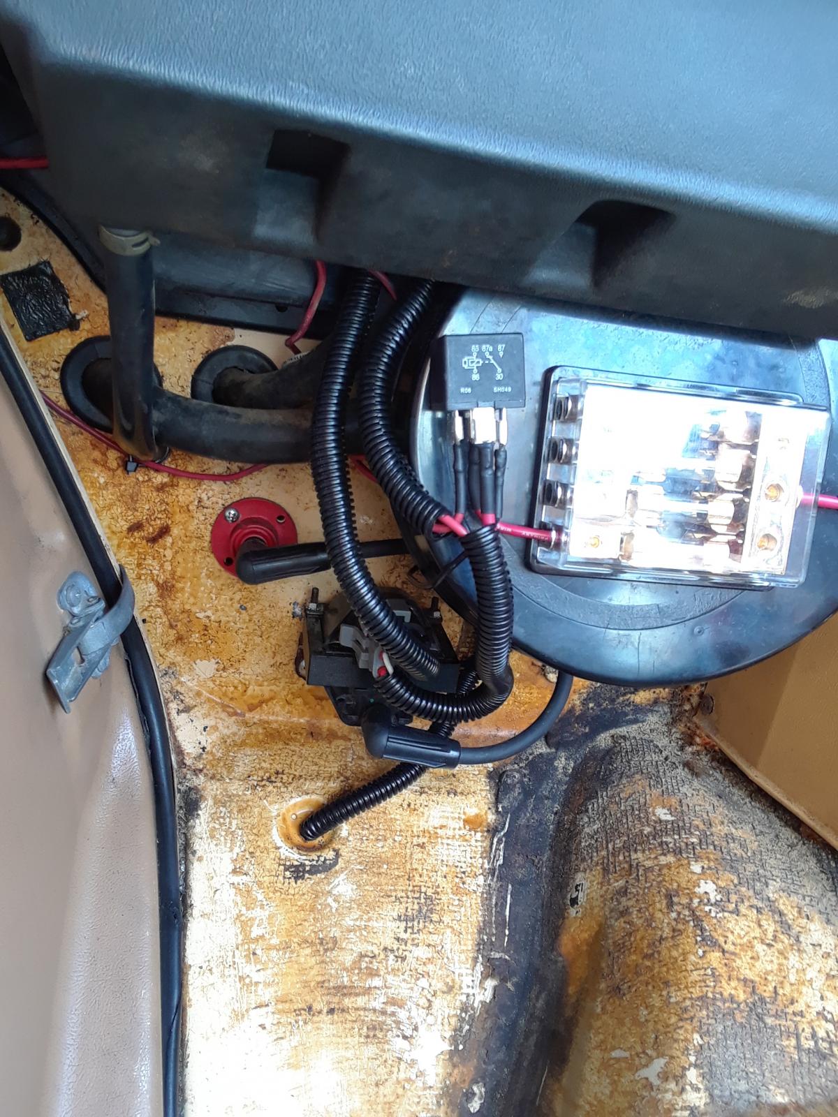

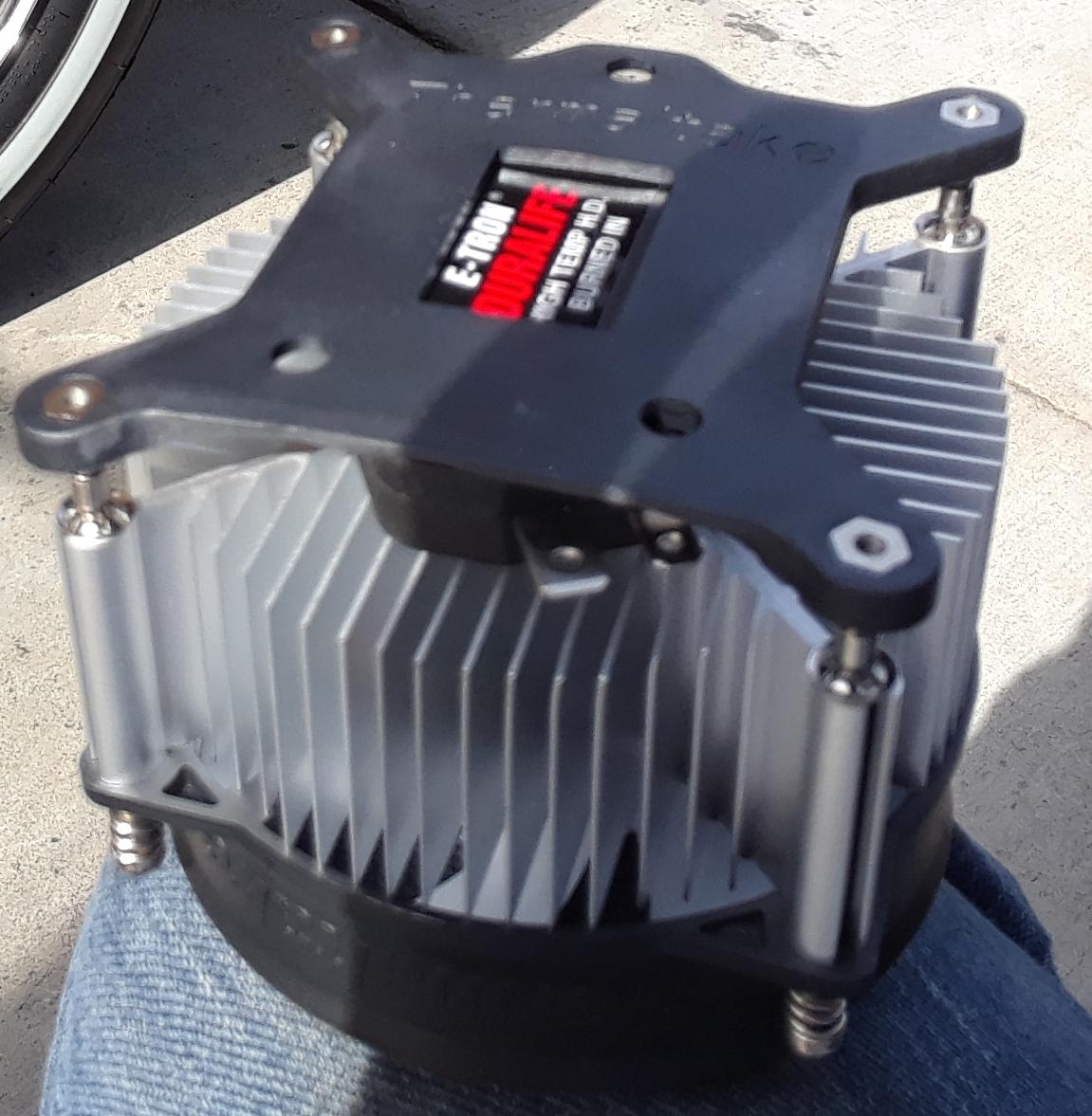

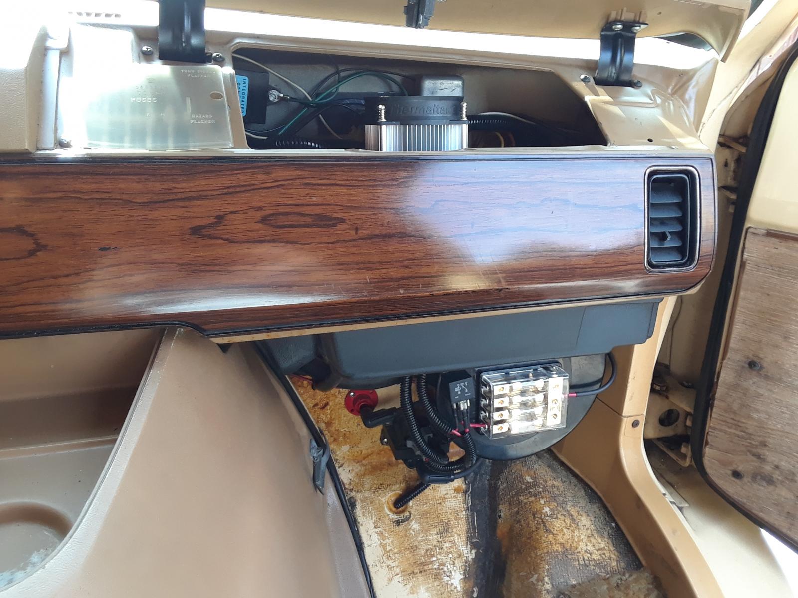

I did something abit different with my HEI Conversion. I sandwhiched the module inside a CPU 12v cooling fan and heat sink combo, and it sits in the glove box. After 2 hour drive, the module itself is not even luke warm. The heatsink has a "Pad" flat spot with heat sink paste on it and fits the module perfect. (Thermaltake Gravity I2 heatsink/fan combo only $13)
I mounted the coil/relay under the dash.
Its a B150 van, I figured its good to keep this stuff out of the heat and easy to get to from inside, no popping hoods and standing in the rain/heat. Its a $600 dodge van, and not a vintage classic so im not worried about originality, just functionality.
Thank You Dan for the great idea. I got the distributor from your recommended old car parts now on ebay. I got a AC delco coil and Echlin Module. (MSD coil and Etron Module keeping as spare)
