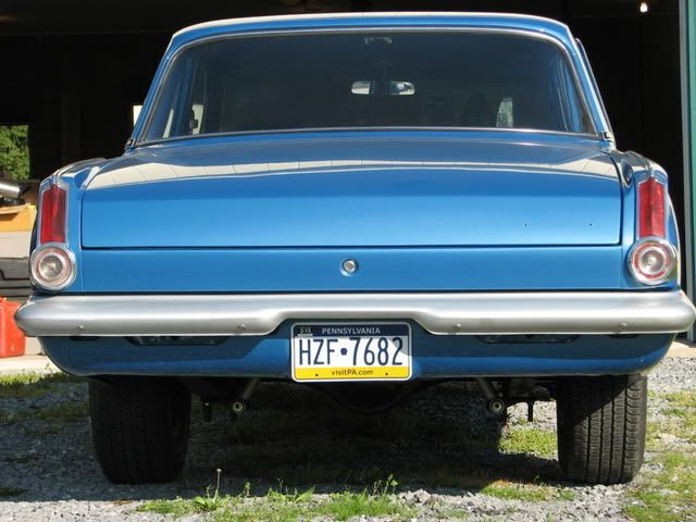

Just returned from my road trip in the car. Yes it has tags and insurance. :D
I think we are good to go. I have definitely missed out on a month of T & T but at least I can race it.
I still am going to be limited on traction with the 235/70 that are on it but that will change in the future. No leaks in the fuel lines I change, no transmission leaks that I could see, and the rear end still plays a pretty song to you going down the road!! :lol: :lol: (Gears are noisy)
I do have a bog when just coming into the throttle lightly, so I will have to try and do a little tweaking on the carb. However, when you smash it to the floor it goes!! :lol: that is what is important.
Just so you know it does have legal license on it! :D

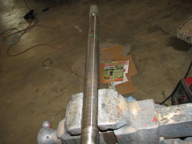

Marked both axles while they were out. can verify if they have twisted down the road.
This is what makes both wheels spin. :D

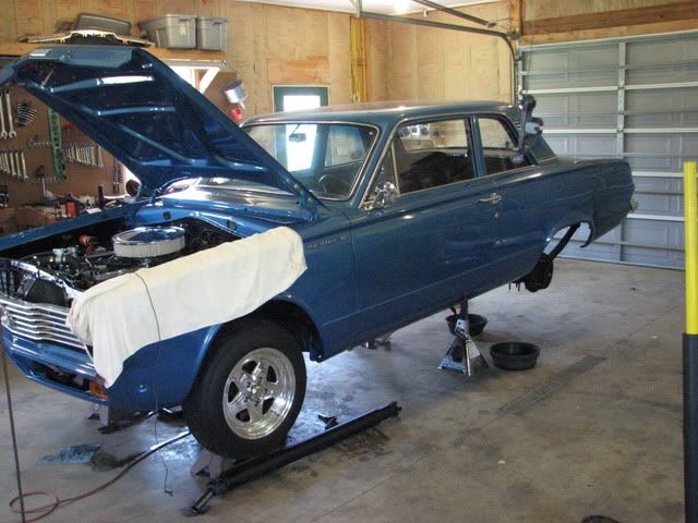

This was the view of the car while my back was doing it's thing!

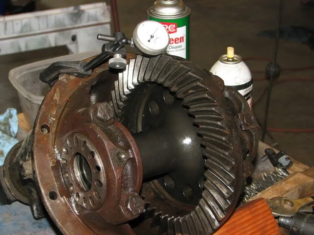

Rick, what did you set your side bearing preload at ?

Romeo,
According to my FSM you run the one side in till you have .001 backlash. Then you lock that side down. run the other adjuster in and continue to tighten it until you have .006-.008 backlash. I ended up right at .007 and could get the lock in place there. Not exactly sure what a torque value would have been. I wish I would have thought to check it.
Rick

Great, I read the same. Also heard to set at 75 ft lbs after setting backlash at .008 . I think that I'm with you and stick to the factory service manual..

Yes, I wasn't real worried because the gear set that I have is basically a worn out rusted up set that my Grandfather had setting in a barn 30 years ago. So they hum and sing a little. Romeo, If I were to guess, I would say that 70# is more than mine were set at. I'd guess maybe 40#. Again, that is just a guess! :lol: :lol:
Rick
