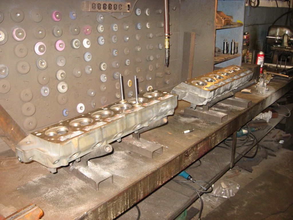

lou, .192 over... omg! flow testing 2 slant heads . the numbers so far are around 170 cfm for intakes and exh are 150 cfm @ .400 valve lift and will work great with my cams . i have pages of test printouts so far ,and guy with grey mustache said i did very good at porting and didn't make any rookie mistakes. he showed me that i need about 10 or 15 min per port more work and they will be done.

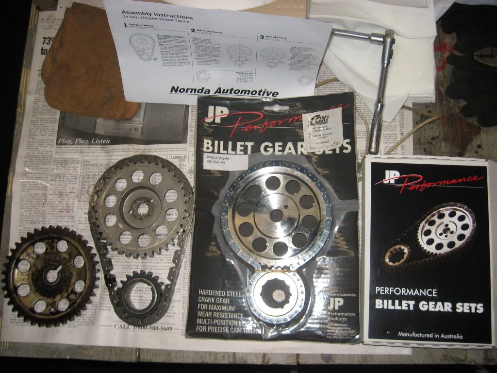

hi, just got this timing set yesterday. did the group try jp performance or any another companys? im sure a group buy would get the price down further. ronnie
