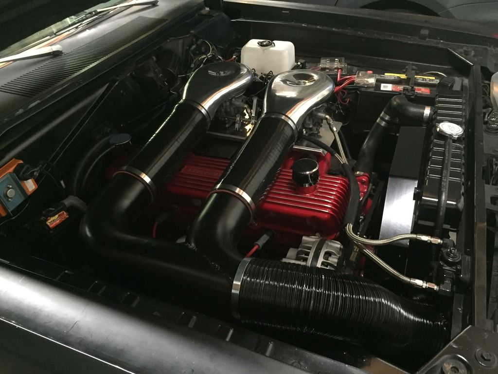

Slantvaliant, I like how you went from round to oval at the front support...no need to cut a round hole lower down like I did...
Brian
That's mostly a function of the geometry of a narrow-body engine bay vs that of a '67-up. There's not a lot of room in front of the alternator for hoses. The location I chose is somewhat shielded by the hood edge from direct flight of rocks, bugs, etc. I still need to put some rat wire over it, just in case.

...as my (very likely) final stab at solving the heat soak issue, at least the traffic one, I installed a recirculation line in my fuel supply. I believe SlantSix Dan suggested this one, credit his way.
Here are a few pics:
I moved the fuel pressure regulator further away from the radiator. As you can see, I now have only one line running from it and, though I had SS braided lines with Teflon cores, I sleeved them with Hot Rod sleeve heat shielding.
http://s785.photobucket.com/user/67dart ... r.jpg.html
Second pic, shows how I routed the line/plumbed to the carbs with T's.
http://s785.photobucket.com/user/67dart ... 5.jpg.html
Finally, it exits past the firewall, where I have a pressure gauge to measure the pressure.
http://s785.photobucket.com/user/67dart ... p.jpg.html
OK, here is where my budget mindedness came into the equation. The downstream line meant that I had no fuel pressure, the downstream regulators for 1-4psi were like $165, but....I simply pinched my metal return line until I had the proper pressure at the gauge...cost, $0. Not sophisticated, but it reads steady (low) pressure for the Webers and fuel is running through there at a good clip, the fittings are all cool to the touch when the pump is going.
So, I hope this perhaps addresses my traffic heat soak, flooding situation. If the gas is sitting in the lines too long, as I'm only idling, and boils, this should correct that, both the flow rate and the heat shield sleeves, no more static gas in the lines.
The fuel line runs from the tank, down along the frame rail on the spark plug side of the engine where it's cooler, up to the regulator (which in this case isn't really doing anything, but it wasn't worth moving at this point), then the line to the carbs is fully heat sheilded and doesn't touch anything. The old setup had the lines resting on the front edge of the valve cover, now it floats in mid-air about an inch or so from anything. The line passes past the float bowls, again heat shielded, then to the firewall. I put heat sleeve on that section only because it was the SS braided line and I didn't want it to rub against the firewall. The rest is nickel copper line back to the sending unit return line. Nickel copper line is easy peasy to bend, no need for a tubing bender, it will not kink and you can feed it through holes like fishing romex in your house walls. I did use rubber grommets where it passes through the frame rails or whatever. It is next to the original fuel line for the most part.
BTW, boy those silicone hoses collect/attract dust! It's a shame they don't make 4" rubber hose; at least I couldn't find any.
Brian
