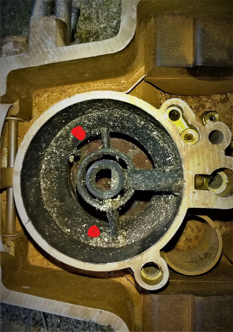

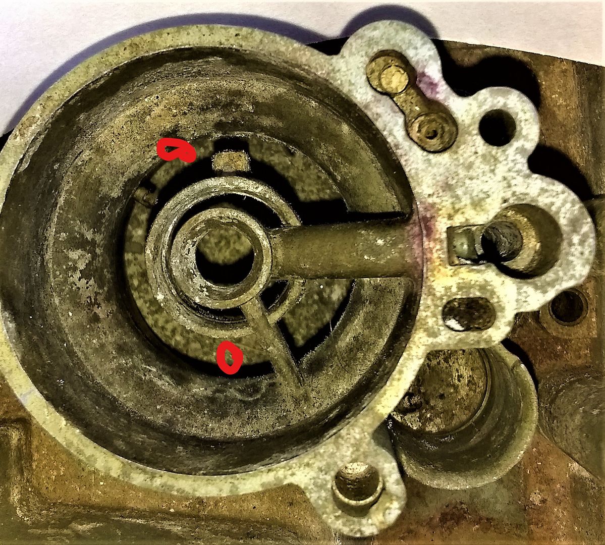

Original 1974 note the red dots Image

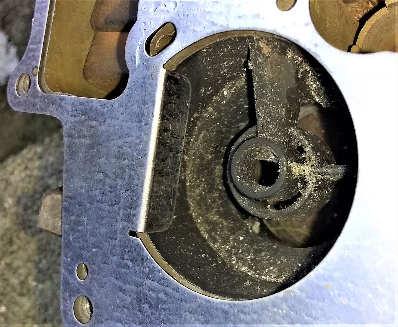

holley 8994 AA 75-77 after market replacement, still round but distribution tabs are different

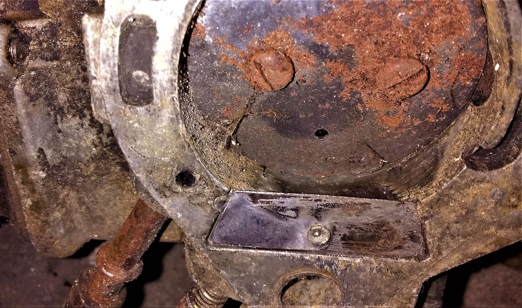

Insert changes round to D shape Image

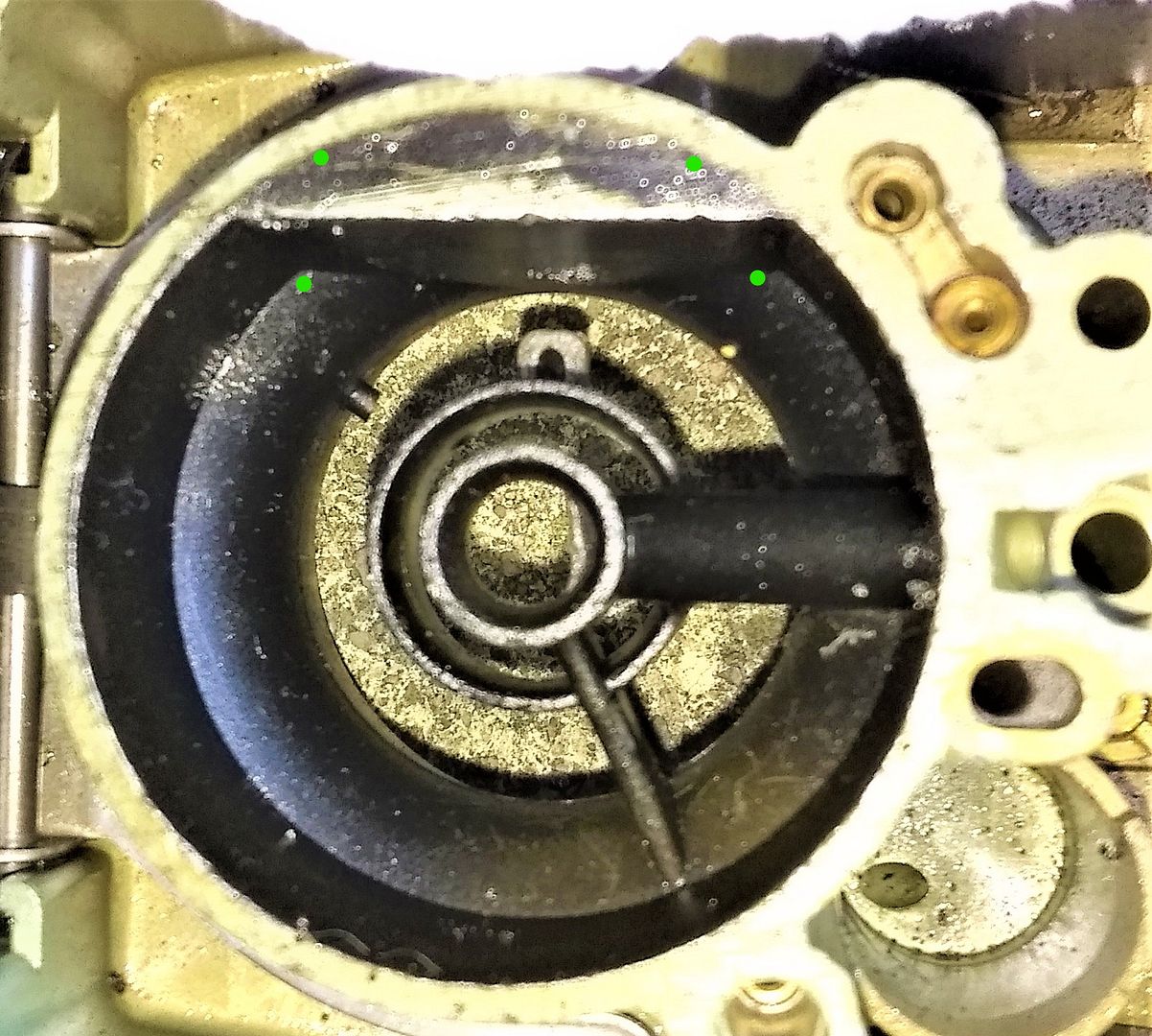

1982 carburetor feedback Style another distribution Wing change sea greendot Goes all the way across to the wall now.Image

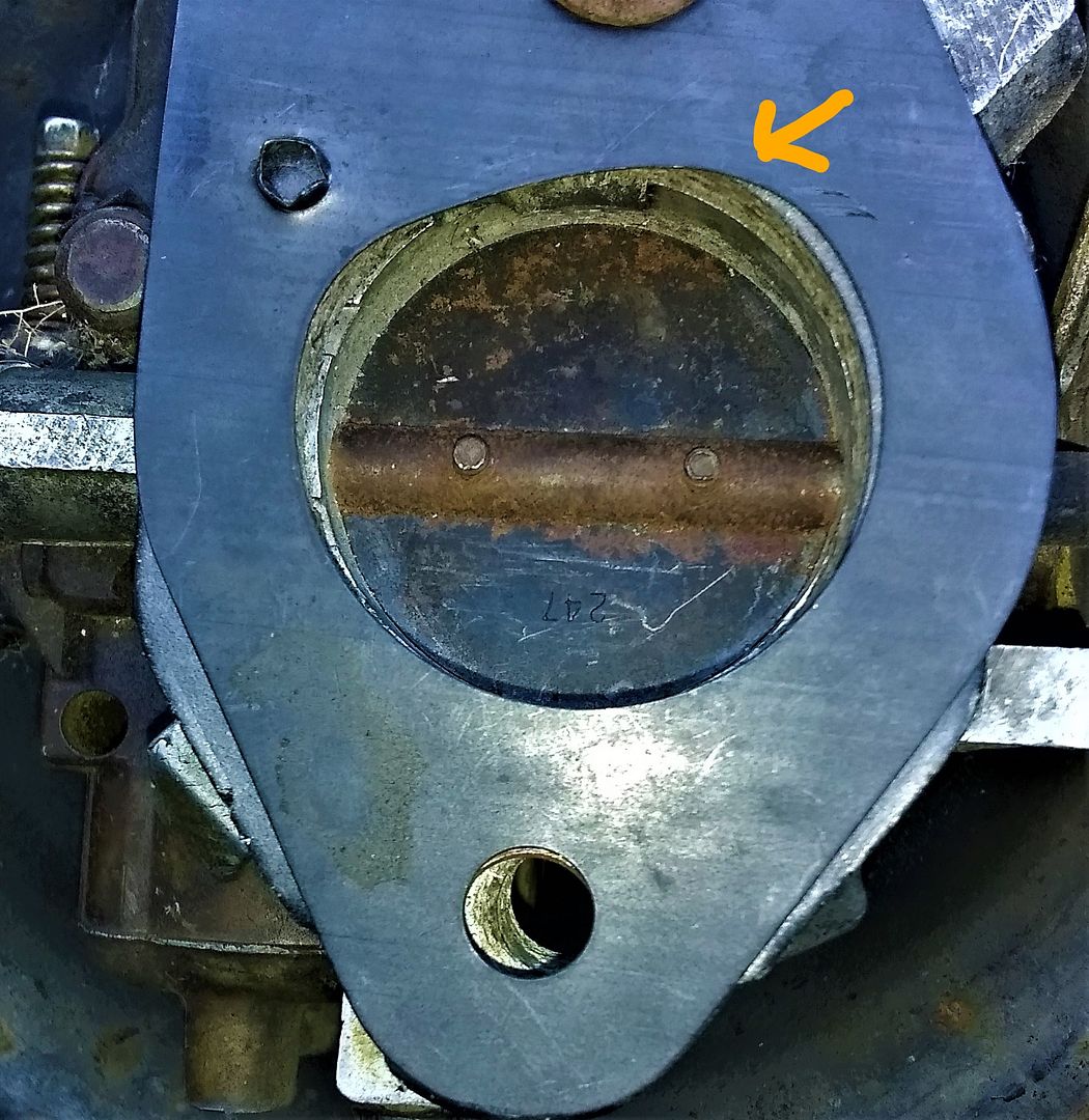

More D shape inImagesert next to manifold
