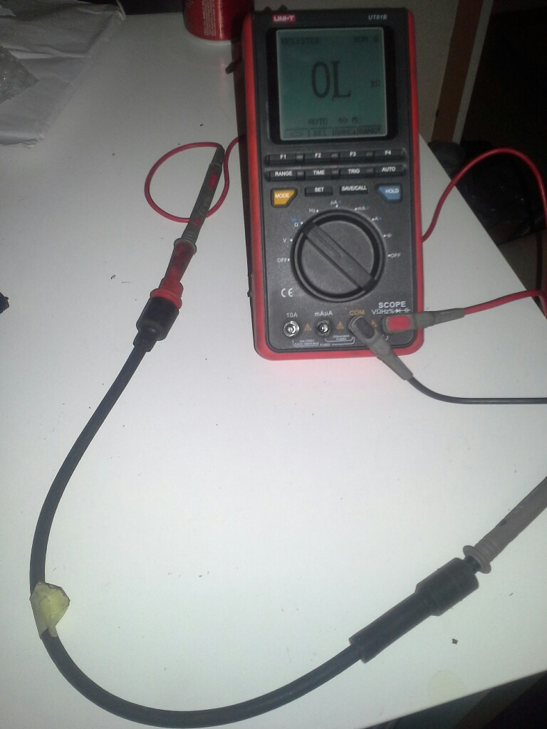

First issue that I am noticing is your "remanufactured" Holley 1920. That immediately makes me wonder what size Jet is installed in the carb. In addition, if plug 1 is lean and 6 is showing rich, I would be taking a look at plug wires and checking resistance. Typically, 1 and 6 are similar, 2 and 5 are similar, and 3 and 4 are similar.
I suggest pulling the fuel bowl, removing the brass jet carefully from the metering block, and letting us know what the 2 digit number is.
Timing wise, I typically run mine at about 12-14 BTDC. Also, your rocker arms should produce a slight ticking noise if they are properly adjusted. If you hear absolutely no noise, they are likely too tight, which will cause the idle to be rough.
~THOR~
The problem was quite simple and the answer lies in this text by THOR. I wanted to check the spark plugs because I've been messing with the jet size etc. While in there I decided to measure the spark plug wire resistances, one of them was bad (in the pic).
I bought a new one and it works like it should. I also ordered the whole set of new spark plugs and a complete set of spark plug wires, this cheap wire is just a temporary fix. Spark plug color was black so I think I'll set the float level to the spec when I install new plugs and after a while I'll check the spark plugs and if they're black I'll go back to the size 58 jet.
I feel a bit stupid for not checking the wires earlier since I was suggested to do it right from the beginning. But I'm not bummed out by this experience because I learned a lot about carburetors and got familiar with my car.
Thank you all who wrote to me and helped!
