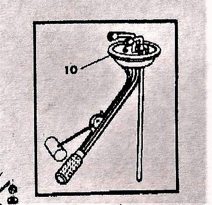

Sending unit 5/16 the big one fuel supply, 1/4 small fuel return line , Both are steel Image

Using factoty parts book for illustration purposes. Your full pump looks fine to me. There are three metal lines going to fuel tank. Fuel supply line 5/16 the big one, fuel return line 3/16 small with 1/4 hose fitting at ends and vapor canister to tank roll over vent valve. Roll overr valve is plastic one hose connection 1/4 it will break no replacement available.
They don't sell sending units? For this make and model?
A yes I see. I will instal the aluminum filter. And change out all the lines.
They used to. The truck is old enough that they are discontinued. You may find one on eBay or a good used one from a boneyard. There used to be a couple of places that rebuilt them if you sent yours in. There is a company that reproduces them but many haven't had good luck with them. My son for instance has bought 2 of the recent aftermarket ones. One for an 80 D150 and one for an 89 ramcharger. On both of those the gauge does go to full when the tank is, like it is supposed to. But when they show flat empty both still have 1/2 tank, as proven by how much can be put in when filled up. I don't mind a gauge that shows a little lower than actual amount left, but a 1/2 a tank lead time is a bit excessive.
I'd rather find a Good used original or send one in to be rebuilt/reconditioned before buying a new aftermarket.
