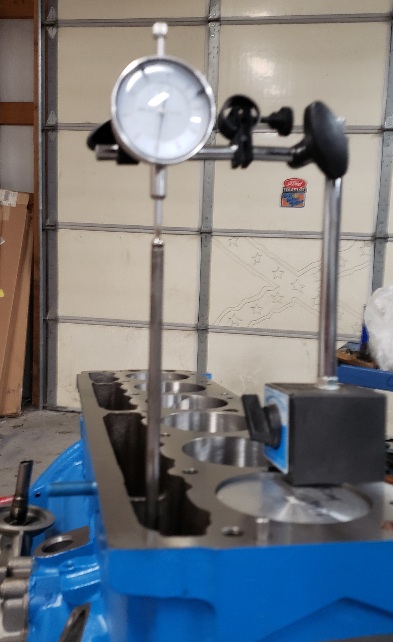

Picture of setup.

Your intake centerline on the card says 104. I'd drop a solid lifter in it and use it for degreeing.
Check it at whatever lift you want before and after TDC. Use .020, .050, it doesn't matter. The center of those two readings give you actual centerline.
