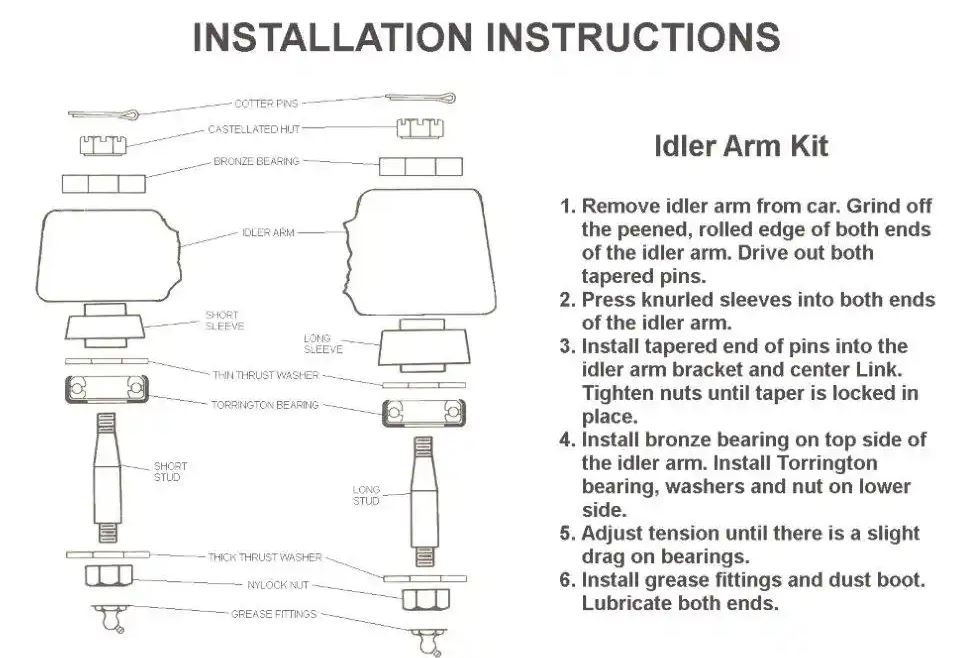

I ordered more parts & tools for ToadRacer & Off-Kilter Racing...
Firm Feel makes several neat parts for Mopars. They ain't cheap, but if you're looking to upgrade/improve your handling they have some cool stuff.
They make an idler arm roller bearing conversion kit to upgrade your idler arm and take out slop ($185). The one on ToadRacer is a tad on the sloppy side and we're looking for every advantage we can get for Lemons DOMINATION! Or we just need to replace the idler arm & I wanted to spend money for no apparent good reason. Time will tell...

There's just a tad more to it than the bearings, but you're probably right...
Probably ain't gonna help nuthin' nohow... :roll: :lol:
