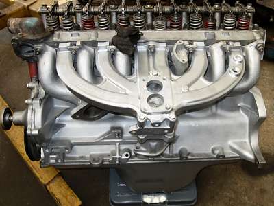

OK, we figured-out a easy way to get the engine weighed on a single scale and now have a weight for Buster.
As they do at the Summer Fair, go to this poll and play "guess Buster's weight".
(There is no fuel pump or distributor included in this weight number)
http://www.slantsix.org/forum/viewtopic.php?t=36834
The Dacuda car is now out of the garage and have also done a weight check on the car, with it's current cast iron engine.
Now I log-off, get out there and swap the engine!

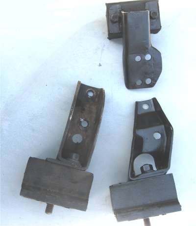

So... seeing that the exhaust is going to get reworked for the Dutra Duals and I already did some measuring and firewall "reworking"... we are going to delay the install to take a shot at setting the engine back 3/4 of an inch. :twisted: :roll:
Here are the engine mounts we made-up to do the deed:

So we removed the shift linkage bellcrank and the exhaust pipe, then dropped the engine into the bay, then bolted it to the trans.
At that point, I went under the car and removed the rear trans. mount bolts, that allowed the assembly to move rearward and the passenger side engine mount to drop into it's K-frame hole. The drivers side is a little off "lay-out" so I will have to make some adjustments to that mount bracket when I get home tonight.

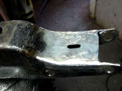

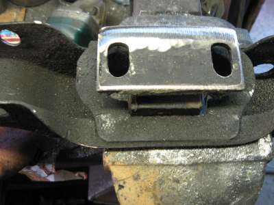

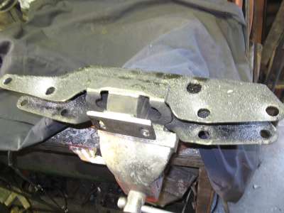

Last night I "fine-tuned" the driver's side engine mount bracket and altered the rear trans cross member and mount. The engine / trans assembly is now bolted down in it's new location. :D
I was ready to do some serious cutting and welding on that rear trans cross member but once we took some measurements, I was able to grind-off enough material to make it fit. (I love my die grander & angle grinder)
Basically, all the mounting holes were "ovaled-out" to allow the x-member to drop down lower and allow the trans to slide rearward.
Seeing that the unit now hangs lower, we altered the bracket's driver's side, to allow more exhaust pipe clearance. Some hacksaw slits, hammer work, fit check and welding had that area contacting the unibody beam it mounts to.
