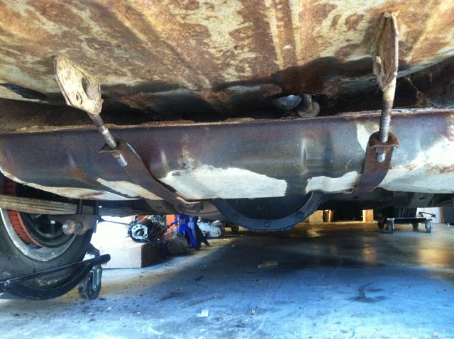

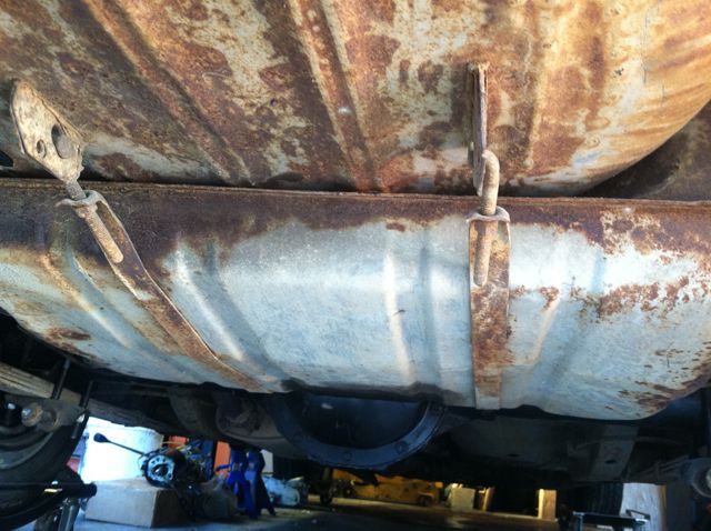

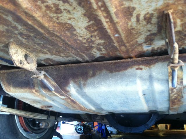

Nothing exciting, 40 year old gas tank held on by 40 year old hardware:
Step one, use a wire brush in a drill motor to clean the threads of the j-bolts so the nuts will move freely:
Step two, some penetrating lubricant sprayed on the threads and nuts of the bolts followed by the use of an air impact hammer gets the nuts off the bolts very easily. Piece of cake!
Step three- remove the straps and have a helper pull the fuel tank fill pipe out of the gas tank while you balance the tank on a floor jack with a tiny head. Then, have some excitement when the tank drops and starts spilling gas everywhere because you were a dork and didn't empty the FULL gas tank before you started this project:

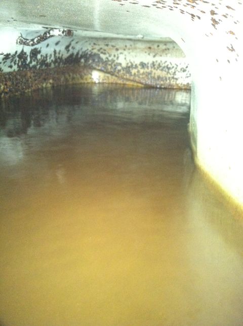

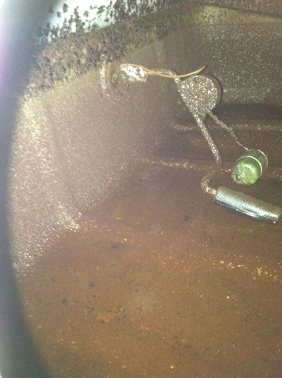

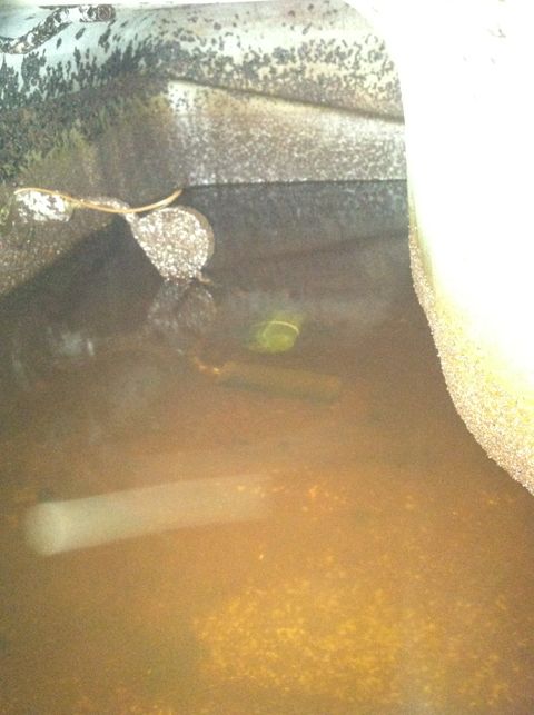

I am saving the "gas" for my pressure washer, so I pumped it out of the tank with a hand pump and took pictures of the inside of the tank as I went. Let's go swimming!

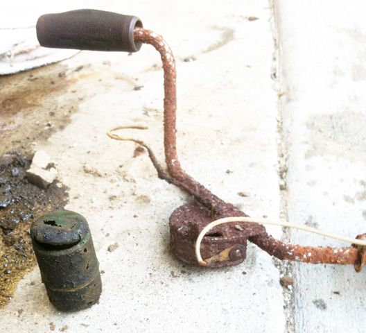

Half empty. About this point I was figuring I was glad I was swapping the tank and I was also figuring a new sending unit was in the future:
Yep, new sending unit for sure:
Wow. Never seen a brass float corrode like this before:

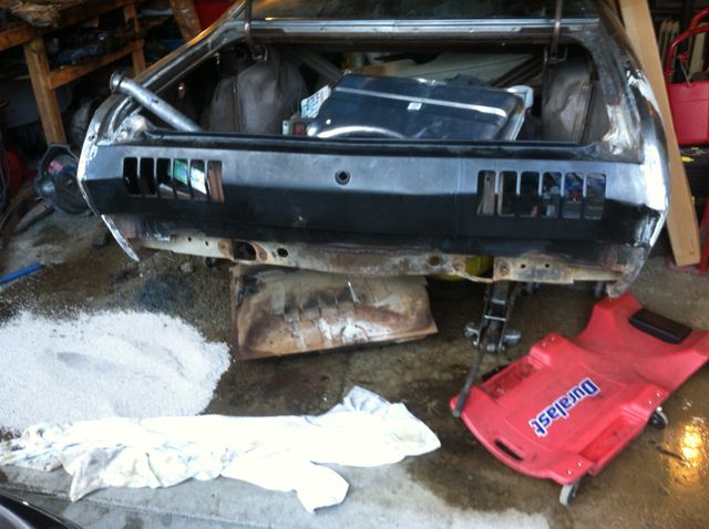

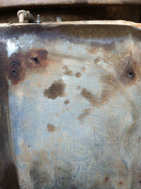

THis is why I am a convert to replacing the gas tanks on cars that have sat around for any length of time. These holes were rusted from the INSIDE out. The car spent most of its life in a dry climate and has only mild surface rust. The outside of the tank has dirt on it, but hardly any rust, except these specs. These holes must have been partialy plugged by rust in the tank that was dislodged in the removal process. Otherwise that full tank of "gas" would have spilled in my garage years ago.

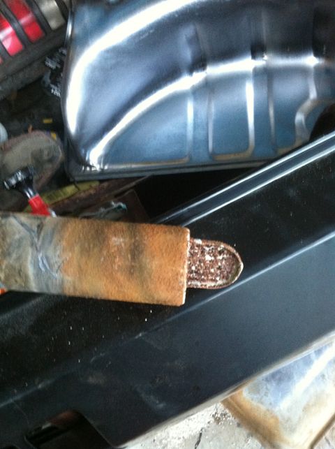

Even the fill tube was rusty!

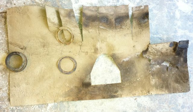

I saved what I could (fill tube gaskets, sending unit retaining ring and gasket, sound deadening pad) but the tank itself is junk.
So ends the adventure of removing a gas tank on a 74 Duster. Moral of the story is EMPTY THE GAS TNK BEFORE YOU REMOVE IT!

Can you sandblast the rusty fill tube end?
PostPosted: Sun Jul 14, 2013 12:40 am
Posts: 13352
Possibly. I need to research if there was any protective coating applied to the fill tube innards before I go blasting away.

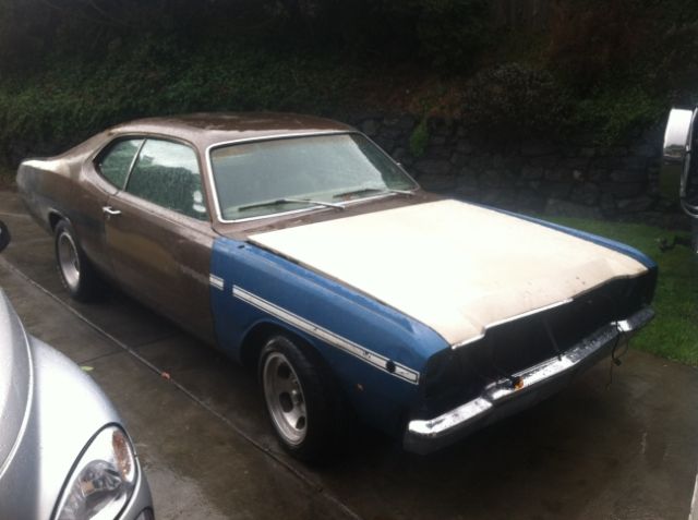

Not today, but about two weeks ago I finally hung the true 1968 Dart fenders on my brother's 74 Duster project. I purchased these fenders probably back in May or June. I work slow….
The fenders are off of a real 68 Dart GTS. I saw the restored car they came off of. These fenders are straighter and have MUCH less rust than the mixed set of 67 Dart fenders that I had put on there earlier. These
I also rebuilt the original Holley 1945 carb. It has a smudge of throttle shaft play, but it is working much better than the lousy 1983 Holley 1945 I had put on there temporarily. The engine actually runs well and so I am going to leave the engine as is until I get a hydraulic motor built for the car.
Future plans include stripping the body to a shell and taking it in to a true body shop to have them finish the rear body work. I hate body work and I am not good at it.
