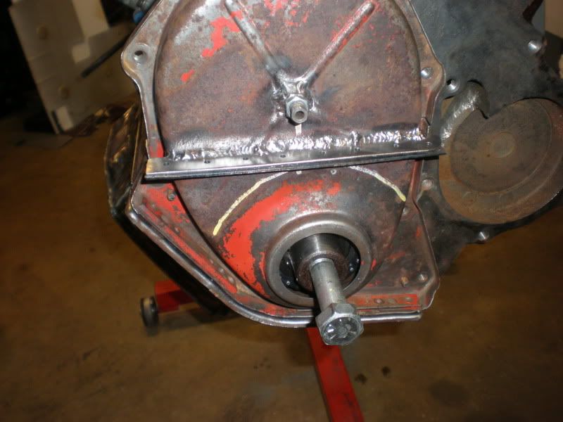

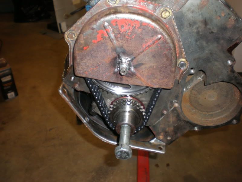

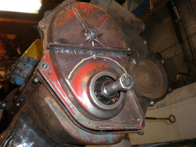

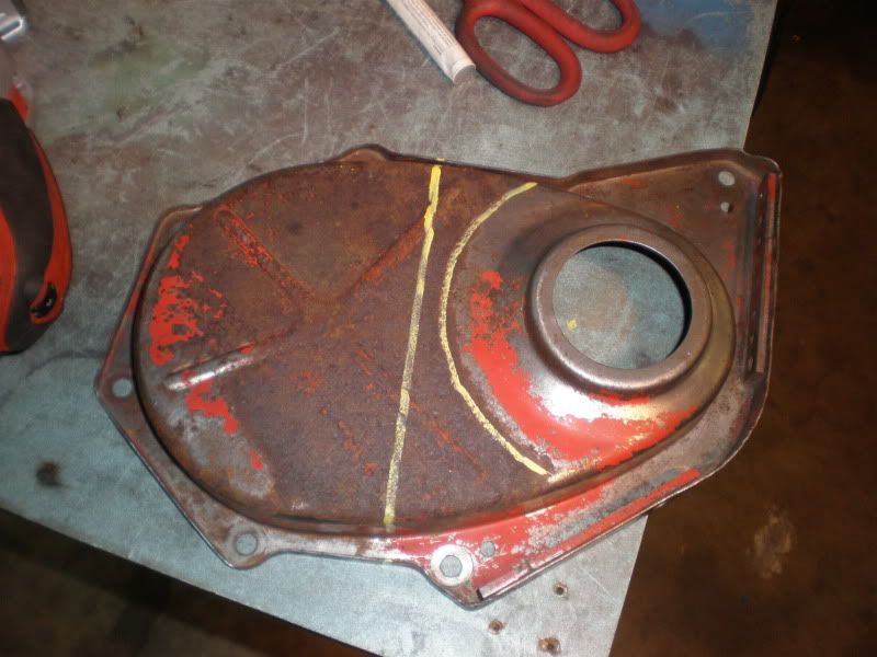

The Split timing cover will have a cam button too.
It is used to access the adjustable timing gear - I will take a stock timing cover and basically slice off the top for an access point to the gear.

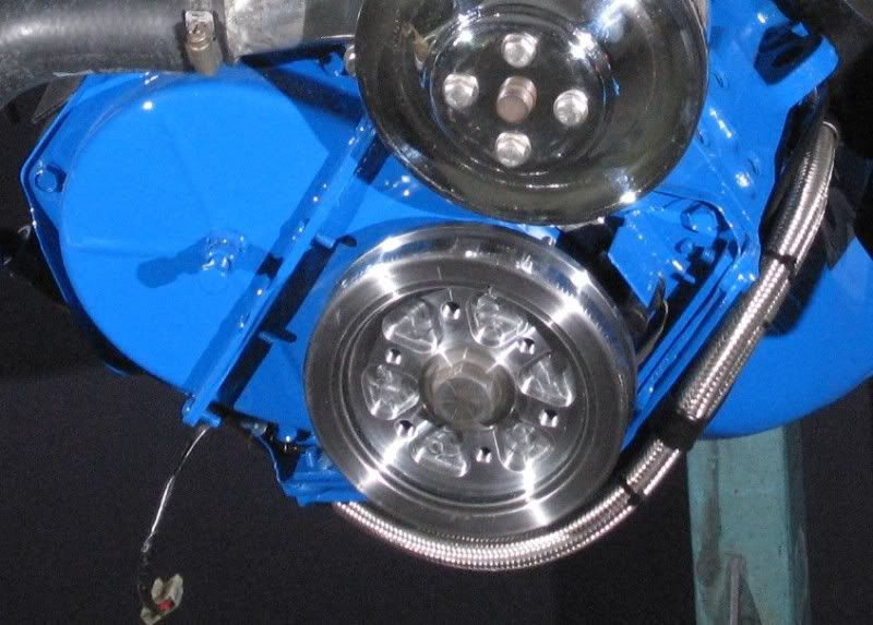

Like this one:
PostPosted: Thu Jan 28, 2010 2:50 pm
Posts: 17626
I know that motor, and it's not yours, methinks. I've turned wrenches on that cover, I believe. Where did that pic come from?
You're right Lou!
That's Cameron's motor money shot.
I think he emailed it to me a while back.
I have had it on my computer forever. I have the whole shot too.
Quite impressive.

Greg - Lou ,please explain the split timing cover cam button down under thingy!
PostPosted: Fri Jan 29, 2010 4:56 pm
It's simple really. Camoeron Tilley made some adjustable cam sprockets. With the 2-piece timing cover you can remove the top part and adjust the cam timing without pulling the damper and such. I might have to get one of his timing sets and fab my own 2-piece cover so I can do easy cam timing adjustments with the Bonneville engine.
PostPosted: Fri Jan 29, 2010 5:14 pm
Posts: 14948
The button keeps the cam from walking back and forth. Pretty simple, braze a 3/8th fine nut on the cover and use a rocker adjuster. :D

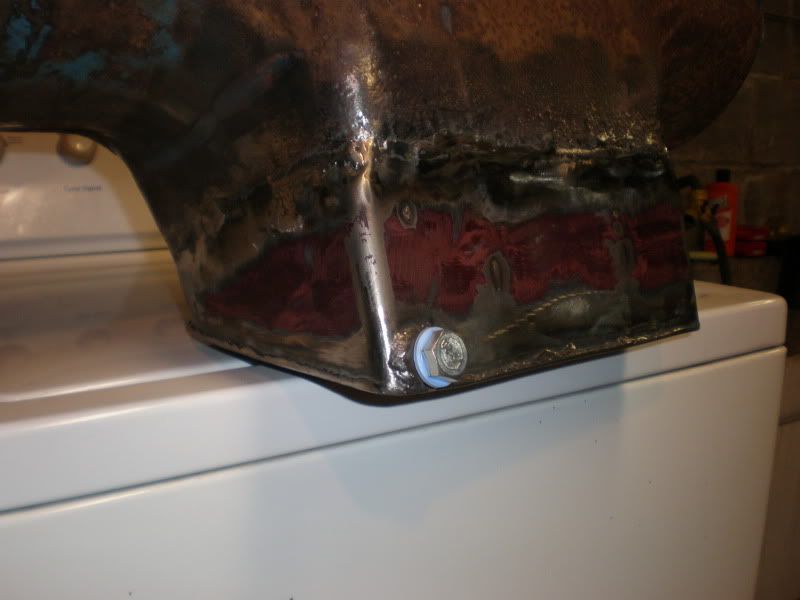

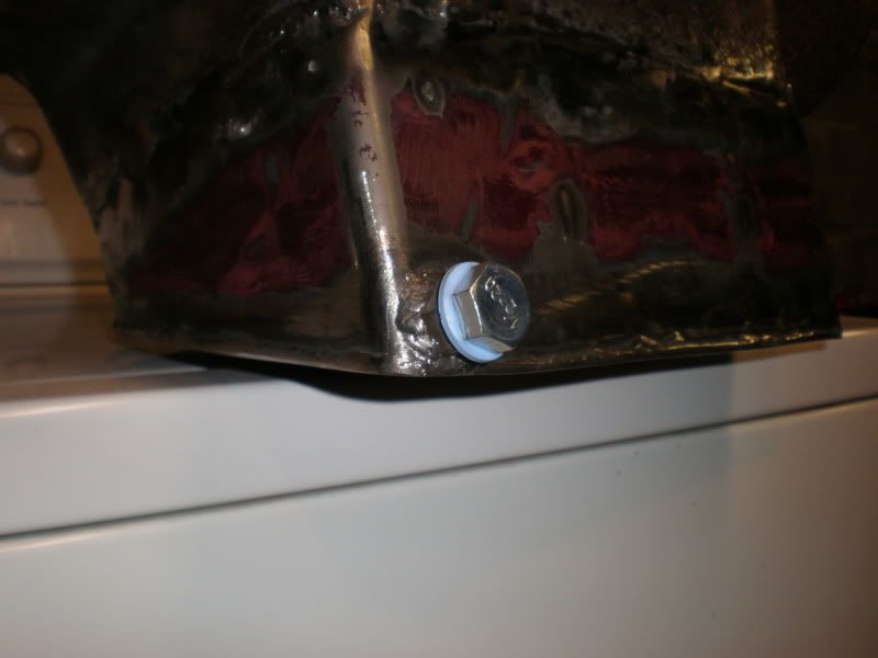

Just finished up the oil pan.
I had 3 small leaks that I found on the leak test. Welded those up nice and tight. Put a 1/2-20 Magentic drain plug in From the parts store.
Now onto sizing up the dipstick and Getting the timing cover cut apart and modified.

Posts: 17626
That is a good accomplishment to get it welded up leak free. Looks nice.
Thnaks Lou.- Yeah, leak free isn't really an option with an oil pan; It HAS to be leak free or else!
I think it looks quite ugly, but that's me.

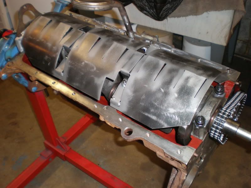

Posts: 10400

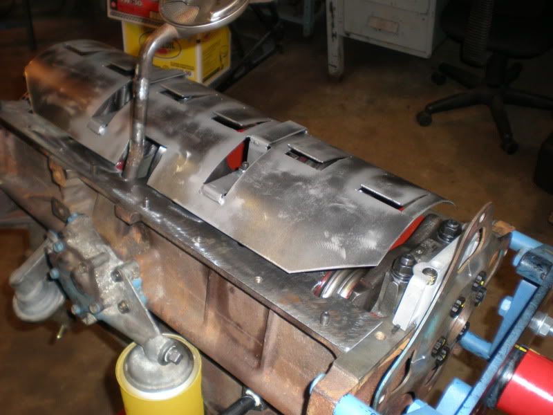

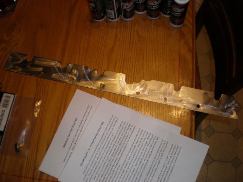

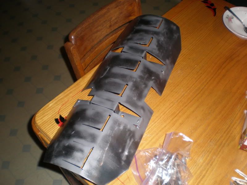

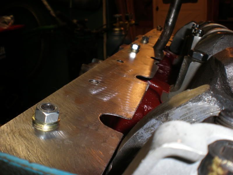

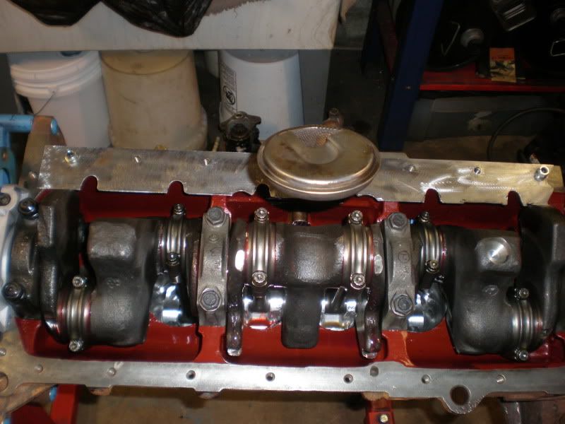

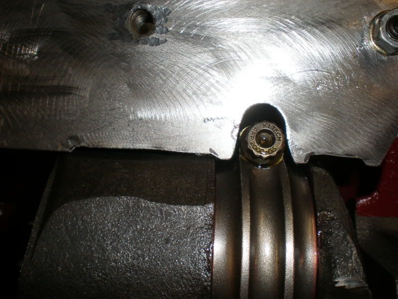

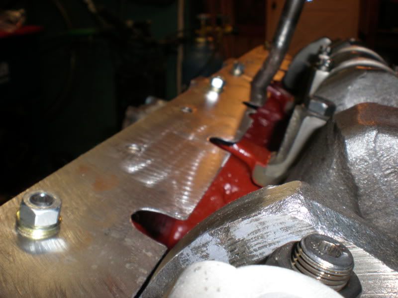

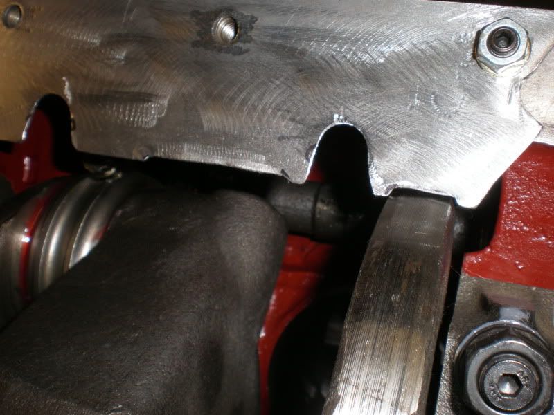

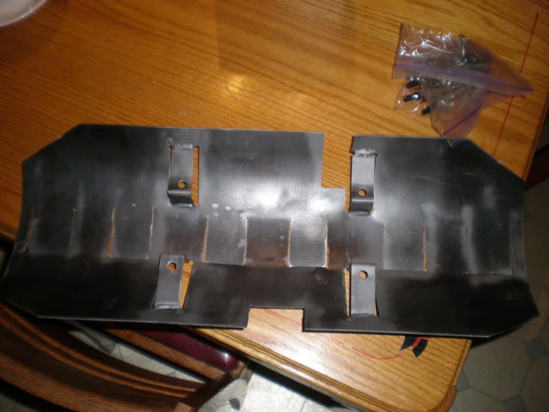

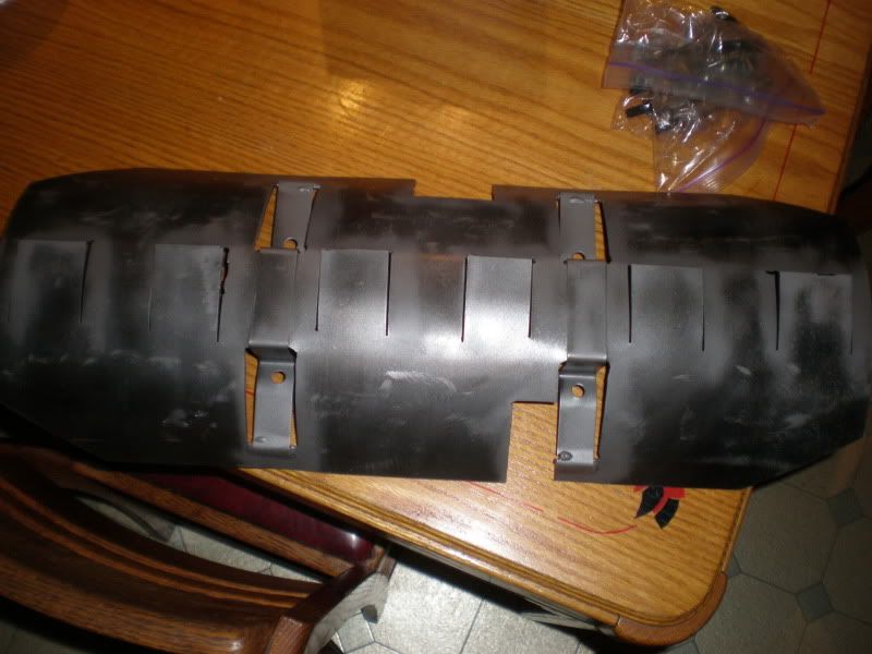

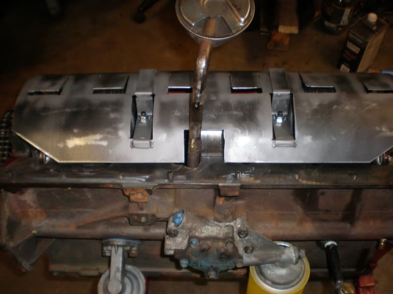

Well My first Package from Mike arrived.
The Windage tray and scraper.
I had only small interference issues on the scraper for counter weights and Throws Near #1 and No clearance issues with the windage tray whatsoever.

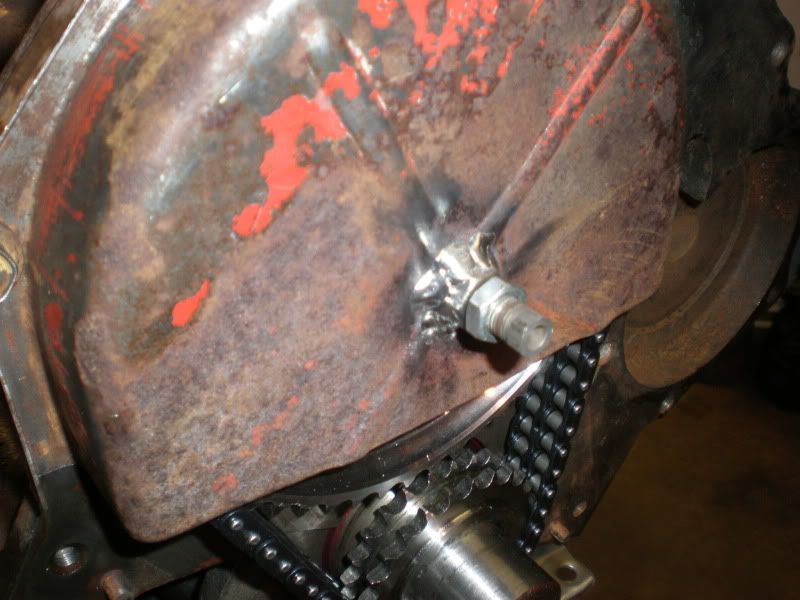

Also Started laying out and building the Split timing cover and cam button.
Pics Below.
