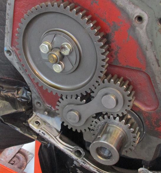

PostPosted: Tue Jan 16, 2024 1:28 pm
Posts: 2724
Matt
There is a void on the crank right where that booger is on the Damper.
I guess it moved metal from one surface to the other.
It's not pretty.

I always Loctite my cam bolt and also use an air impact on them for tigntening purposes. Sometimes they can be not completely centered or seated on the cam snout if you are not careful.
Makes sense now why stan's engine was so lazy.
I bet that dowel was broken a while back allowing the cam to become retarded quite a bit.
PostPosted: Tue Jan 16, 2024 2:06 pm
Posts: 2724
I had forgotten to Locktite the bolt.
The cam bumper is what kept it close and not flying around in the cover.
I think it was loose on the last two runs, but not sheared.
It sheared on the return road when it quit running and would not restart.
Not the reason for it being lazy.
It ran it's best time by a half second on the second to last run.
PostPosted: Tue Jan 16, 2024 2:52 pm
Posts: 9079
That is one reason high performance big blocks went to the 3 bolt cam/sprocket.
PostPosted: Tue Jan 16, 2024 3:02 pm
Posts: 2724
And a few high output slants!

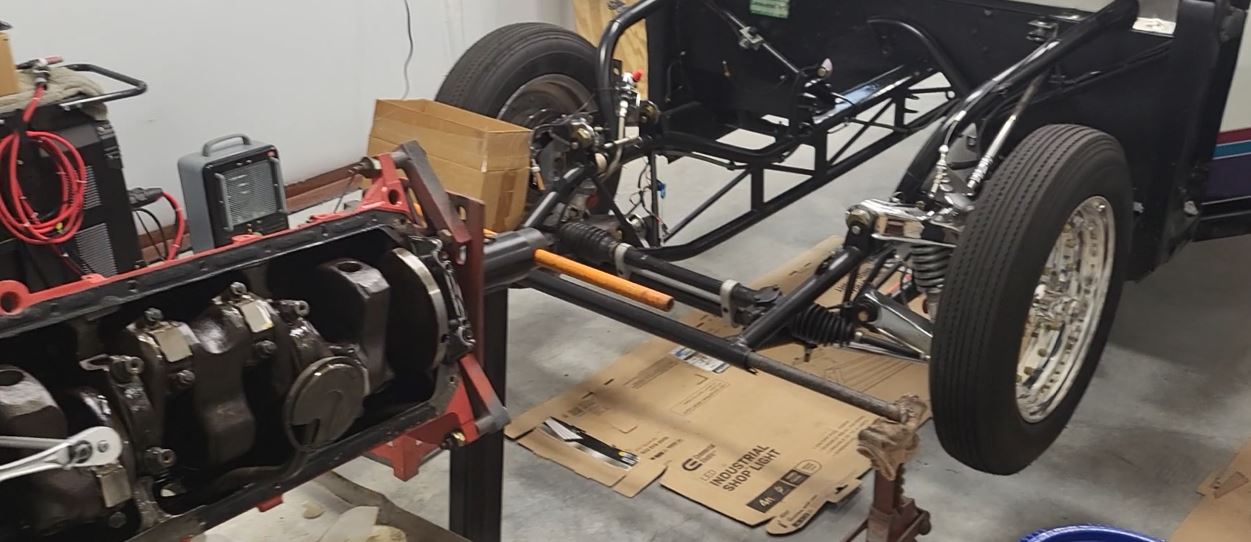

PostPosted: Wed Jan 24, 2024 8:10 am
Posts: 2724
I got the engine torn down yesterday.
Nothing unexpected.
Bearings looked very good, number 3 rod had a small discoloring down the center, could not feel anything.
Mains looked great.
Pistons as well.
My Racer Brown cam had a full grove rear journal, I didn't remember that!
Might explain the volume of oil on the rockers.
Now when time permits off to the machine shop to get advice on crank nose.
